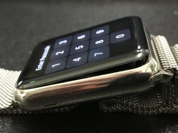

Seriously... anything that has that short battery life will accumulate a lot of cycles in a short time. Typically, Lithium Cobalt Oxide (commonly known as LCO) are done after 500-1000 cycles. Other chemistry, most notably Lithium NMC, can double that and is more safe in operation and can deal better with high currents (quick charge!).
Yet, even Boeing was stupid enough to choose LCO over safer technology (in the aviation one could expect LFP), which grounded the entire 787 fleet. The Note 7 disaster was just another good example why use of LCO should be discontinued preferably asap. The good news here is, that thanks to Tesla and other e-car manufacturers (who realize that LCO is not state of the art), other chemistry is more widely used.

Happened to my stainless steel first gen a couple of weeks ago. The genius looked at it for a couple of seconds and said it was probably the battery that got swollen. They sent it away and I got a refurbished watch 6 days later. Glad they've increased the warranty for that issue.
Also have a series 0 SS that is having battery issues as of the last week or two.

This is good news... as this just happened to mine as well:

It's long been known that the sensor pod can be pushed out by a swelling battery. It sounds like when the pod glue is good enough, then it pushes out the front instead!
You are right. Battery swelling hadn't crossed my mind. But because I'd noted in the past how crap Apple's polymer selections were (After a couple years, my iPhone bumper turned to embrittlement goo; after a couple years and less than a dozen uses, the strain relievers on my 80$ premium ear buds did the same); so I assumed the adhesive failed (even though the display/housing joint was further from my skin than on the other examples.)

This happened to my watch! They (Apple) didn't tell me it was the battery. It happened while I was sitting in a meeting, not doing anything. After the support people querying me on whether I had gotten it wet, dropped it, etc., they agreed to send me a replacement and I sent the old one back. Who knew?!?
This happened to mine as well. Normally in Europe, we get up to 6 years consumer rights protection, meaning that if your Watch breaks inexplicably, it gets fixed/replaced for free. In my case, because I bought it in the US, I didn't have this protection, and it took quite a bit of 'kicking a fuss' and escalating things to get Apple to repair it.
It just seemed completely bizarre that the screen popped off without any impact or physical damage (and it continued to work).
Good to know what happened now. I'd have been furious if I paid £230 to fix it then.

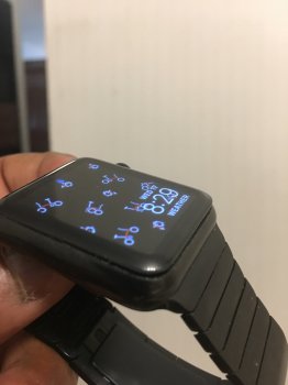

I noticed my screen popped off this past Friday when grabbing my watch from the dock. I don't have AC+ and have an appointment with Genius bar today at 5pm. Two questions.
Are they going to replace the watch there or send it out like software issues? Should I expect to pay anything?
Glad I did my googles and found this thread before walking in to my appointment blind.

My 42mm Space Grey Apple Watch screen came off last night. However, I am unsure if it was the result of an expanded/swollen battery. I went to the Apple Store in Broadway (Sydney) and let them know of my issue. They let me know that I was 10 days outside the Australian consumer law (2 years) but they decided to have it sent off for repair free of charge (It would've been $279 AUD). We will see what happens in the next few weeks.
Update: They sent my watch to be repaired/replaced. Wish apple could handle watch repairs in-store like other Mac products, specifically iPhones. Or just replace the watch since its covered instead of shipping it out.

Just noticed it on my first gen. Taking it to the Apple Store today, hearing reports they are denying repairs at some stores. We will see.
Update: The Apple Store accepted it to be sent for repair. 249 fee waived under "Warranty Status: Quality Program (E1)".

Final update: Received my watch yesterday afternoon and it was replaced, not repaired. Dropped off at Apple on Monday at 5:30pm received full replacement watch Thursday. Short turnaround and great customer service that costed me $0.

I received a "new" gen 1 watch with no band in a white Apple Watch box. New serial with same finish and screen. I'm sure it's a refurb but it was a free repair.

I just dropped off my wife's first gen sport at the Apple Store with the same quality program (E1) and 0 fee thing, but the work order says she's getting a series 1 replacement. I wonder if Apple does this so it can then gut all the first gen internals it gets back (from sport and Watch alike) for Watch refurbs.
The price drop on the series 1 obviously suggests the new SOC is much cheaper for them to manufacture so this would make sense.
