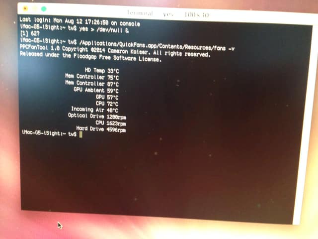

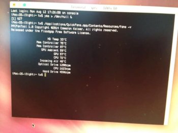

today I repasted my iMac G5 iSight in hope of getting it to cool down a little bit but the temperature readings still seem to be out of what is acceptable. Especially the memory controller is noticeably high (usually goes up to 90 °C / 194 °F no matter what I do. I attached a screenshot of my temperature readings when at full CPU load (by running a looping terminal command). Now I wouldn't be bothered if it weren't for the 2 memory controller readings. What else could I try in order to get the temperatures down and what are these 2 memory controllers (where are they on the logic board) ? Any recommendations are highly appreciated. Many thanks!

90°C is indeed suspiciously hot, although the CPU temperature and fan speed displayed in your screenshot seem to be within what's acceptable. Well, actually, I was wondering if your fan is spinning enough, because at 72°C, I think it should be spinning quicker than 1623rpm...
What is the CPU fan rpm when temperatures reach 90°C?
Also, what thermal paste did you use? Could you describe for us, in detail, how you applied it, so we can have a better idea?

Thanks for replying. The fan is indeed not spinning any faster than about 1600 or 1700 rpm but as you've pointed out the CPU stays relatively cool. Now I haven't really used the machine much today I only browsed the web and that's about it although the iMac reached 100% load when I use TenFourFox. When the memory controller reaches about 90 degrees the fans really don't care and stay the same. I've used MX-4 thermal compound which I used in my PowerBooks G4 before and it is a really good paste from what I can tell (applied it via the dot method and then spreading it with a card). Where are these memory controllers located by the way?

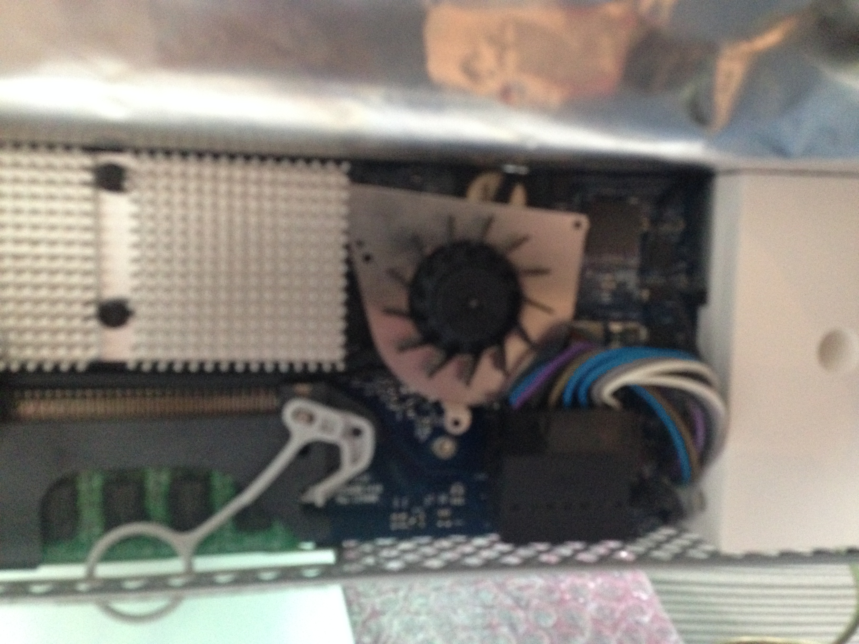

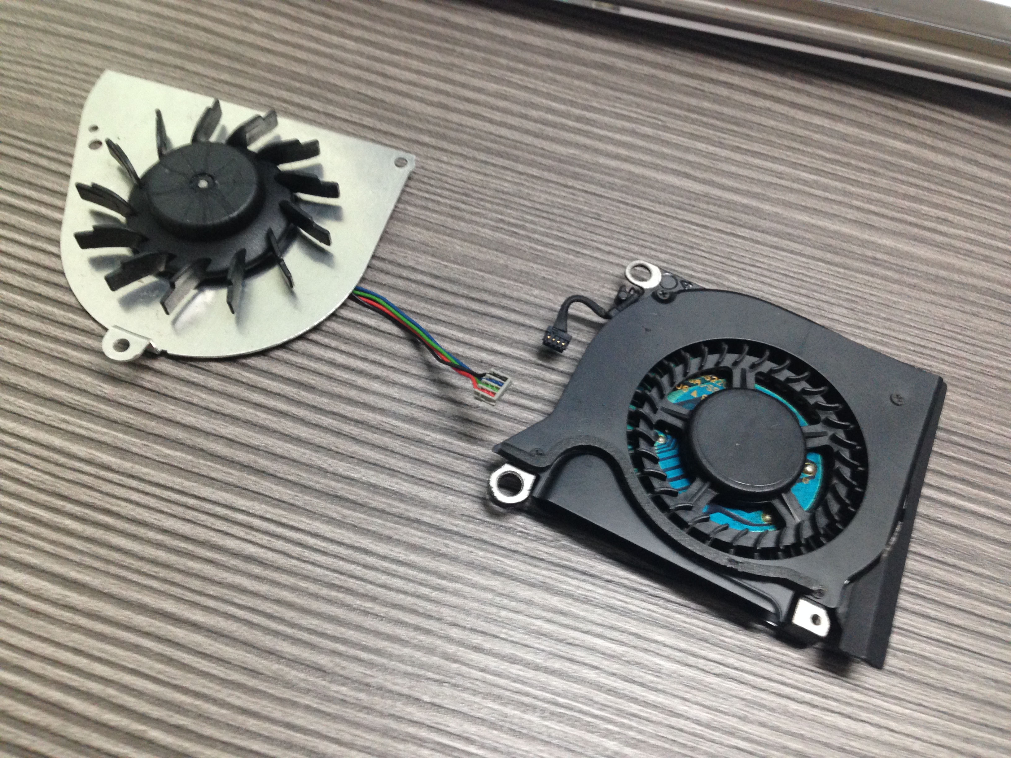

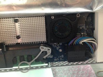

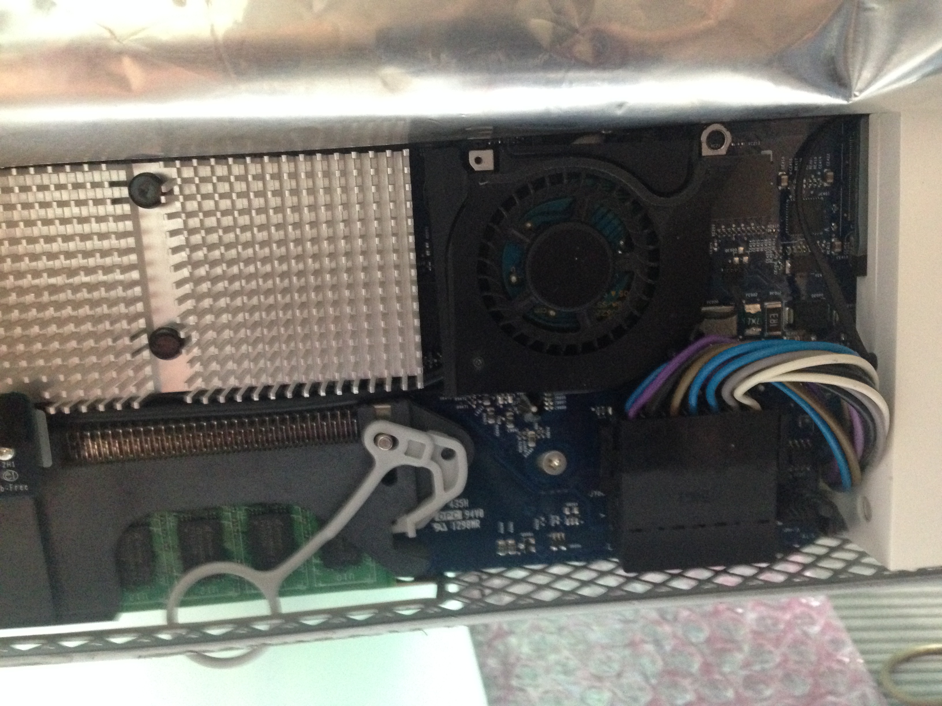

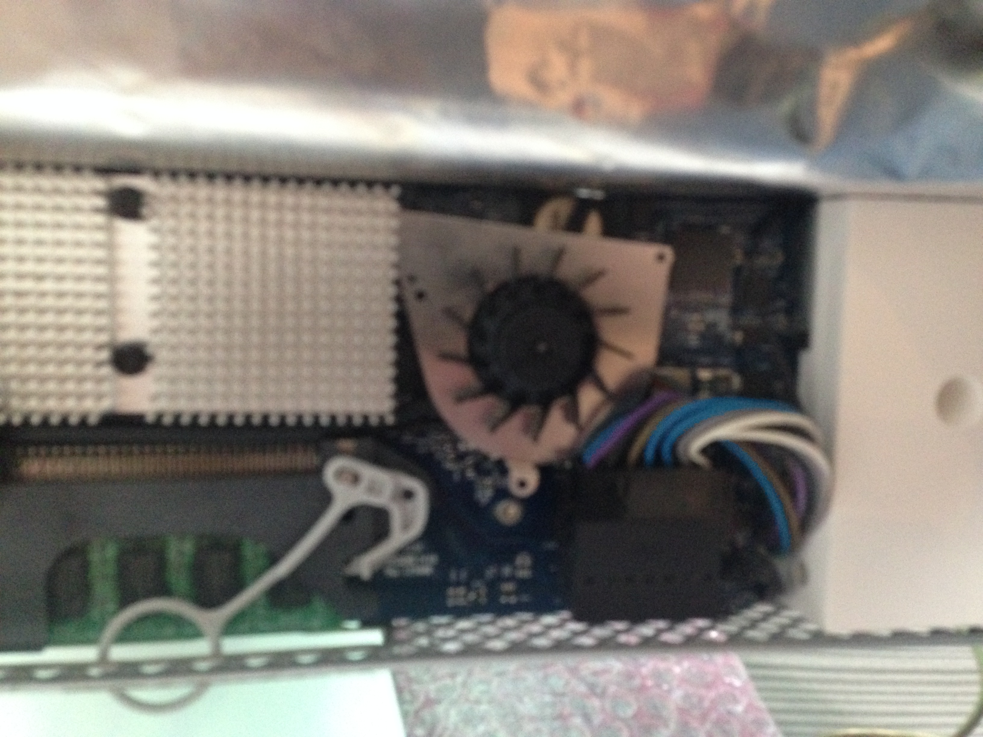

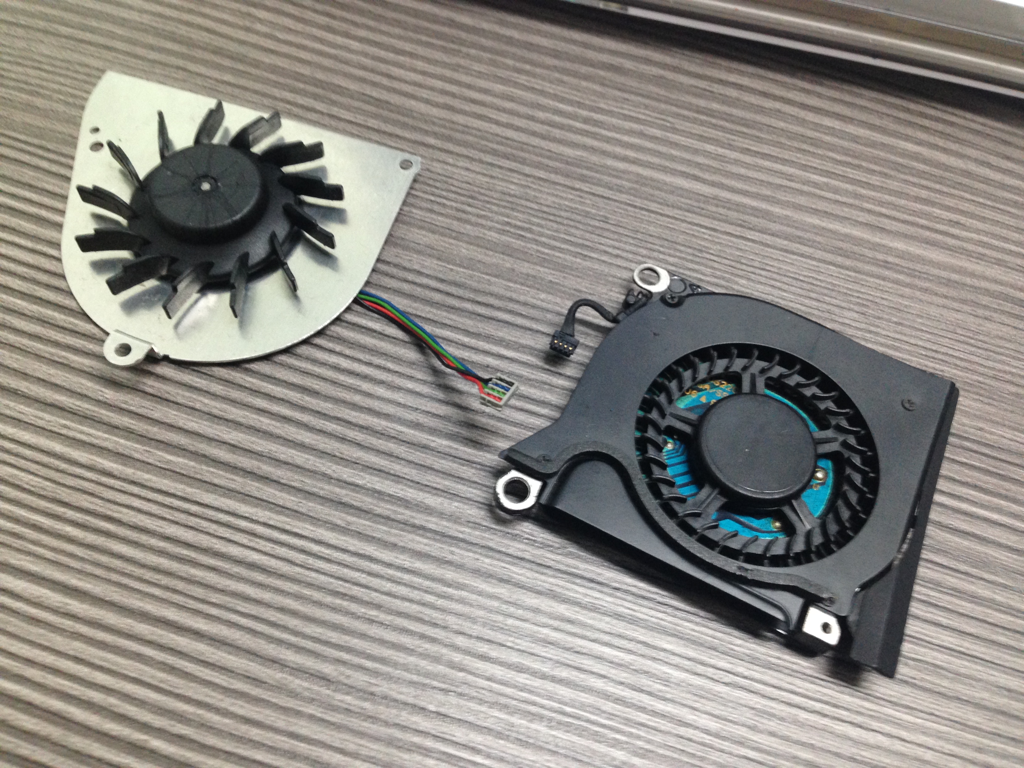

So I tried a different RAM module (same memory size but different brand) but the heat situation remains unchanged. In my drawer I had two fans sitting that could be candidates for a cooling mod since they fit physically. I'd simply stick them to the logic board with a heat resistent double adhesive tape. Using a cable to split the SATA power supply is actually a great idea but how would I convert the connectors of the fans to make them plug with SATA? Are there any converters / adapters that do that? Also I don't know if the position of the additional fan is ideal and how I could control the additional fan from the OS. It seems that doing such mod isn't too straight forward unfortunately but if anyone could point me in the right direction I'd love to try it out.
Use the black fan, just make sure the side which it blows air out of is pointing at the heatsink. Also get it as close as possible to the heatsink. To power it, you will have to cut off the connector and solder on wires to the right pins, and then connect that to 5v.

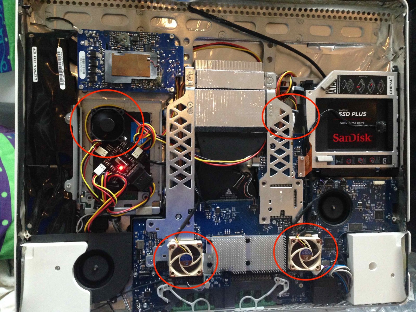

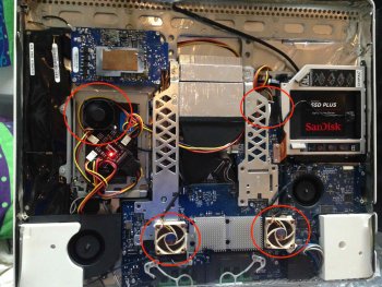

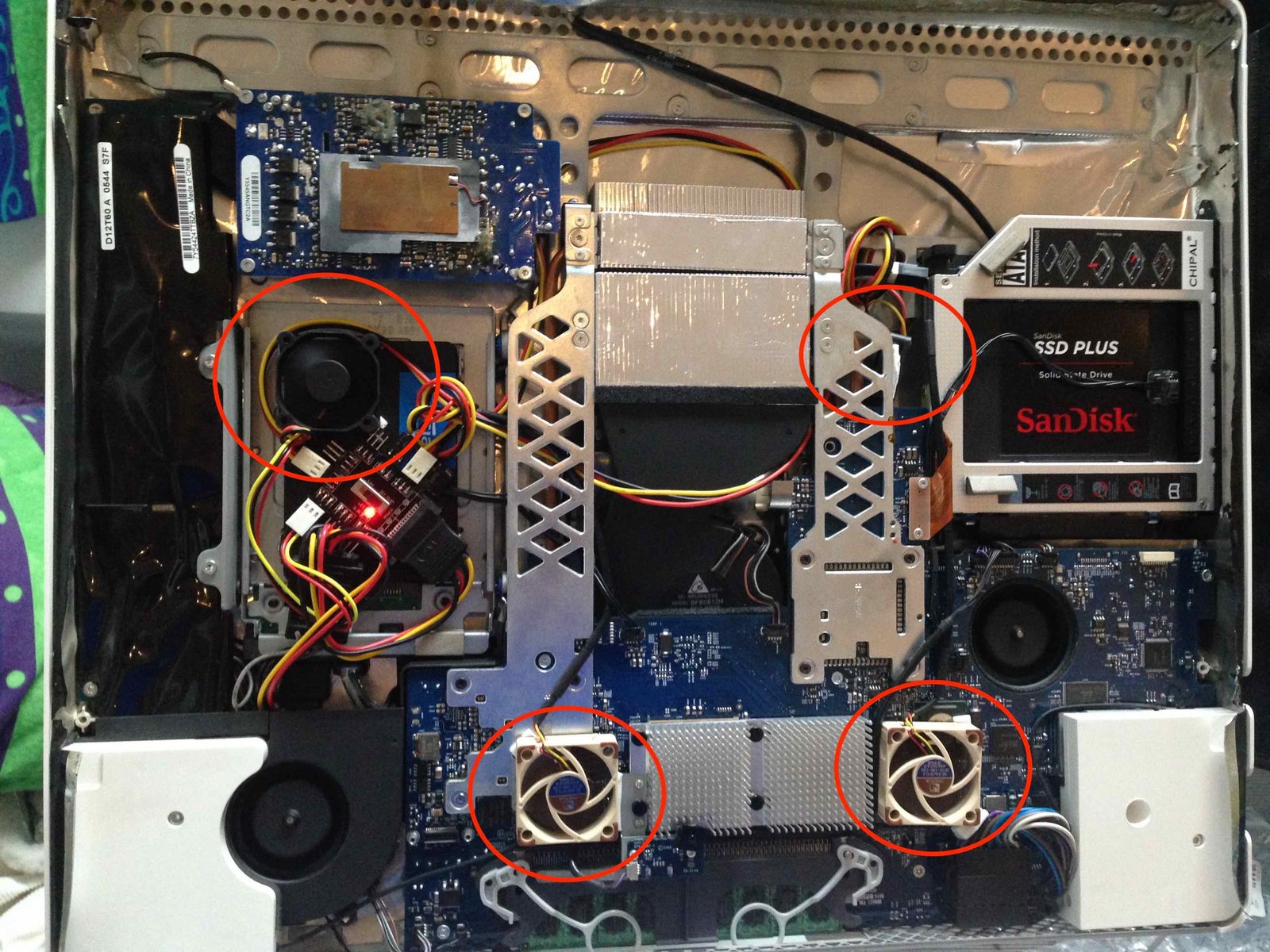

Sorry it has been some time. My cooling mod is finally finished and now I can enjoy a much cooler iMac G5 🙂 I ended up buying a bunch of 3pin Molex (12V) fans which I attached via double adhesive tape near the hot zones. 2 are near the Northbride, one on the SSD and one near the optical drive. To power said fans, I split the SATA power connection by using a Y-Cable and a cheap SATA power to 8x3pin Molex adapter (so no soldering skills required). It works great and the Northbride temperature dropped by about 15°C. SSD and optical drive caddy were about 60 degrees before which is way to hot IMO. SSD dropped by 5-10°C and the optical drive caddy about 3-4°C (I mounted a very small fan there). The additional power consumption is about 3 watts.
Reactions: dextructor
Very cool. How much did this cost?
The two fans near the northbridge were rather pricey (about 15$ each – Amazon). The other 2 ones were approximately 10$ in total (AliExpress). The SATA to Molex Adapter is very cheap like 2$. The SATA splitter as well, it is like 1$. So I'd say I spent about 40$, of course that wouldn't be worth it for an old machine for the average joe but I'm a hobbyist so I don't mind putting money into older machines.
