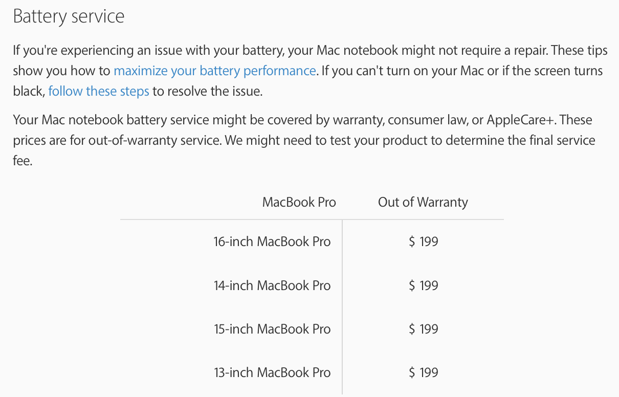

Not actually (always) true. Many have got battery replaced for $199, and Apple elects (for no extra charge) to do this by replacing the whole top case. One of the out-of-warranty repairs that Apple does that is actually a reasonable deal.
Then there is the $50 DIY option.
These are both reasonable options. A DIY battery replacement can more than pay for itself in increased trade-in value (which is what happened to me: $260 more).
If you have been quoted $700 that is unfortunate, as many others have been pleased with getting it done for $200.
