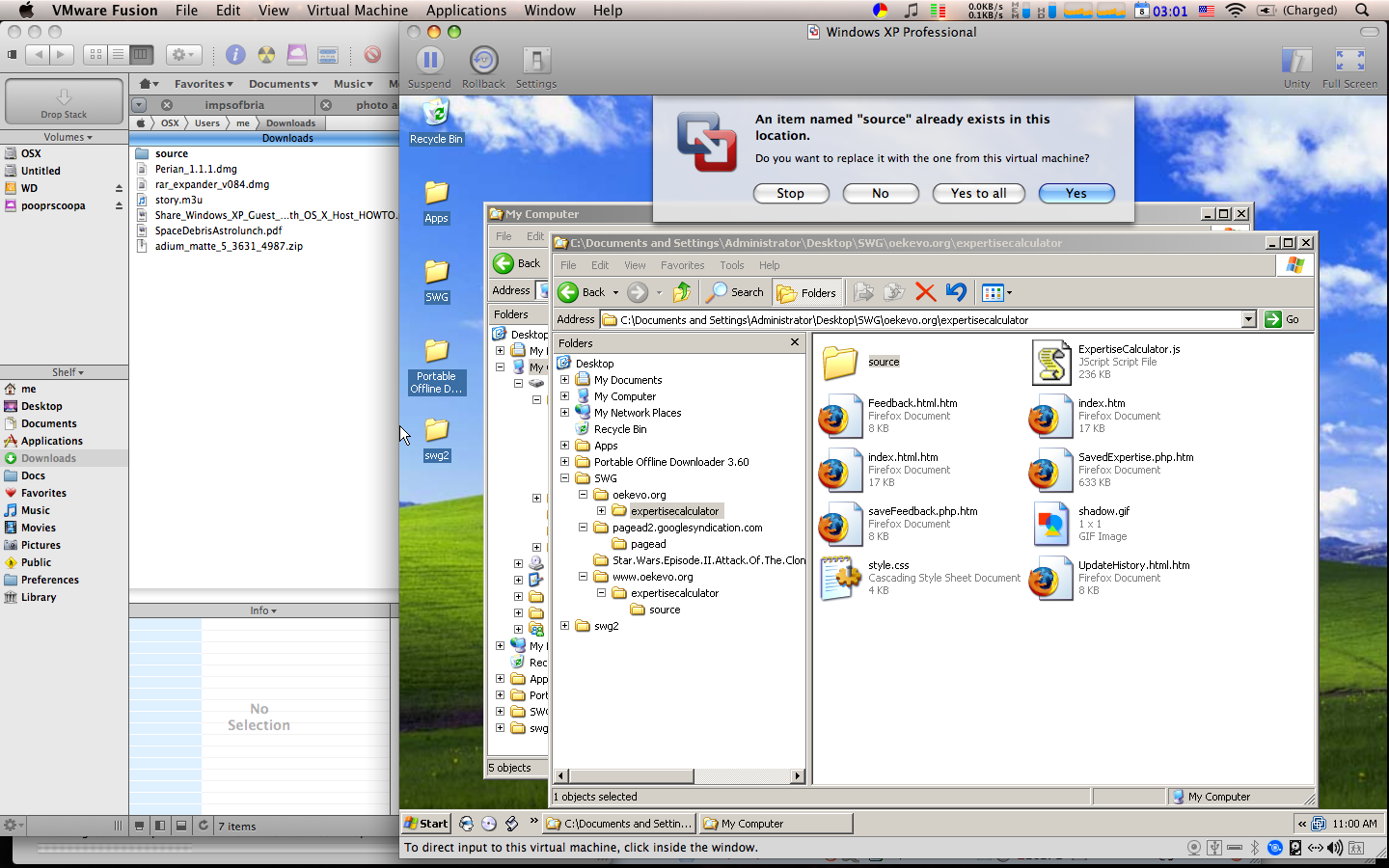

Both VMware and Windows do not do this. Instead, they ask if you want to replace but ONLY replace the similar files without touching any of the other files.
Try doing this in OSX: having one directory with 10 files and another directory similarly names with 5 files similar to the other directory. Now try copying the directory with the 5 files over and it will delete the directory with the 10 files and leave you with a directory only having 5 files.
Now try to do this with windows running in VMware and it does not delete the extra 5 files.

One solution seems to be copying it to windows inside VMware and then try to merge it back with OSX since the replace option through VMware does merge the files.
