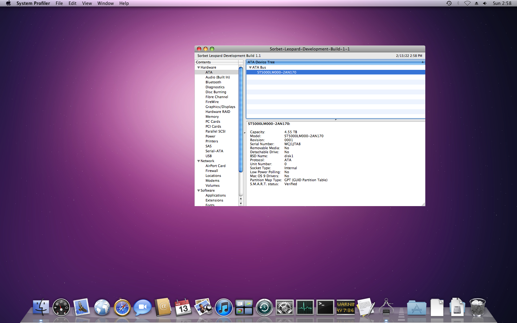

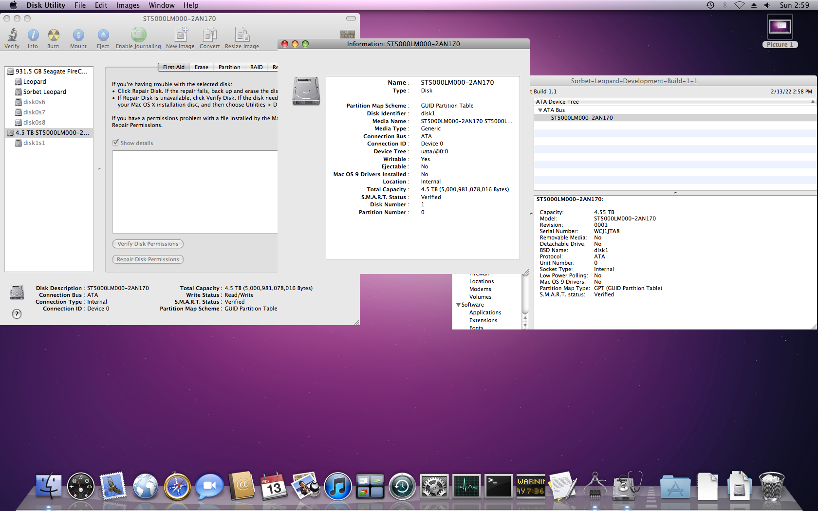

Since I was working on upgrading my iMac G5 I bought an Panasonic UJ-225 Blu-ray, but since it took many months to arrive in my country this part I was without any kind of warranty. It was recognized inside OS X Leopard and in Void Linux but It didn't read any disks, won't make any sound of the drive spinning the disc.

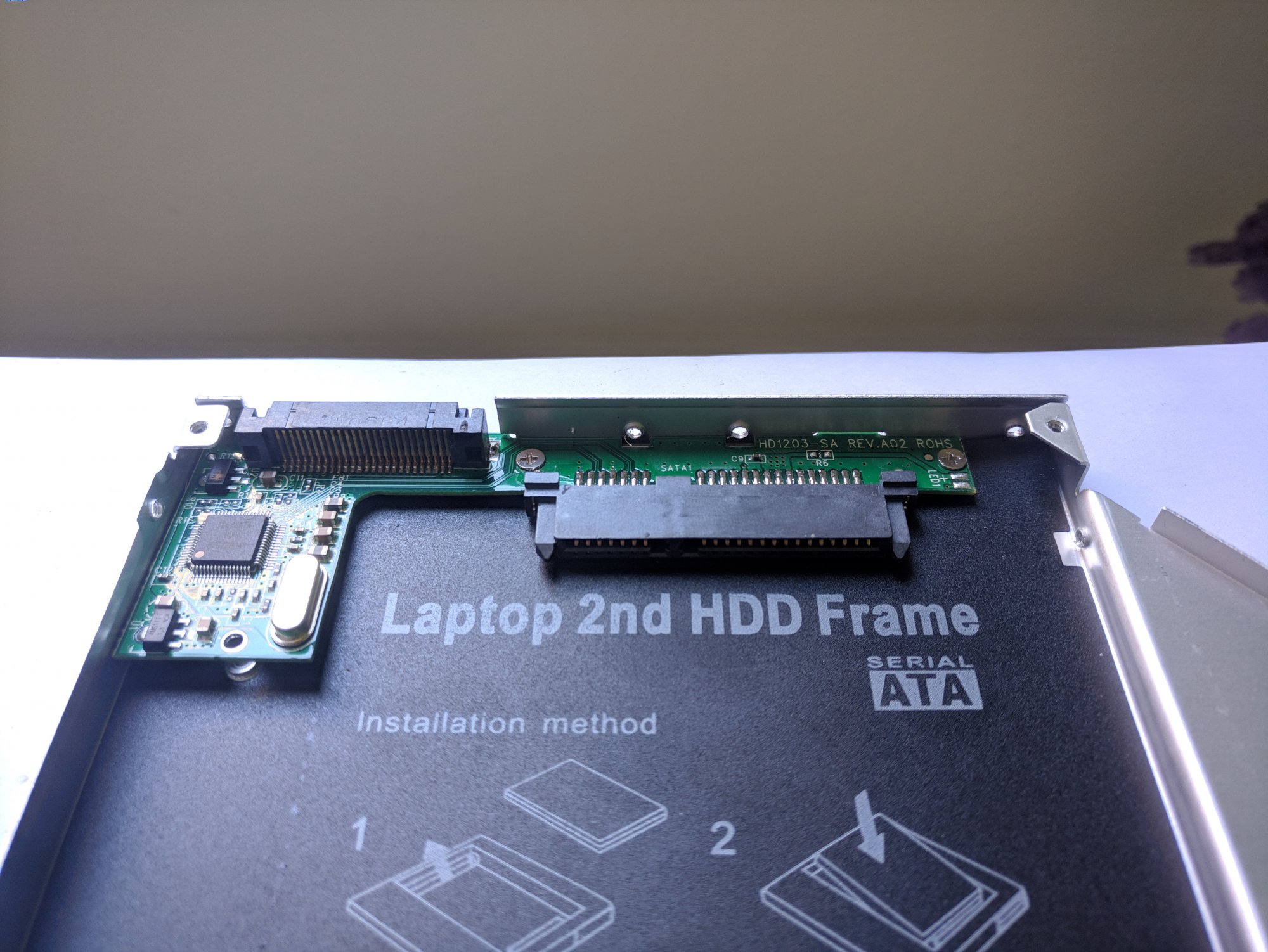

I love optical media, but I rarely use it nowadays, but I use/need a lot of storage, so I begin to search for a replacement. I found this on Aliexpress

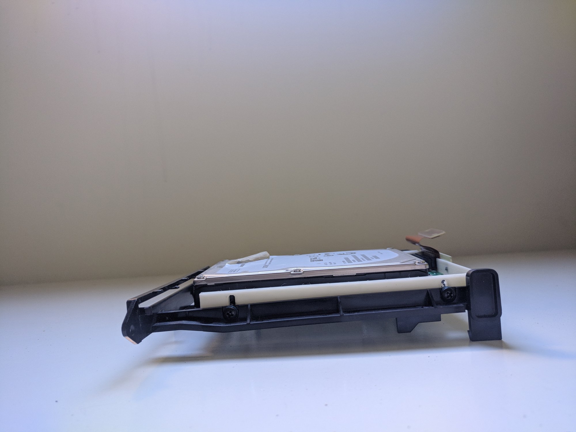

It arrived but I think that isn't the most optimal solution regarding the temperatures so I asked my friend engineer to help me with an solution similar to the OWC Data Doubler, after a few weeks he sent me a very good product (when he send me the files I'll publish so anyone could make one if your heart desires)

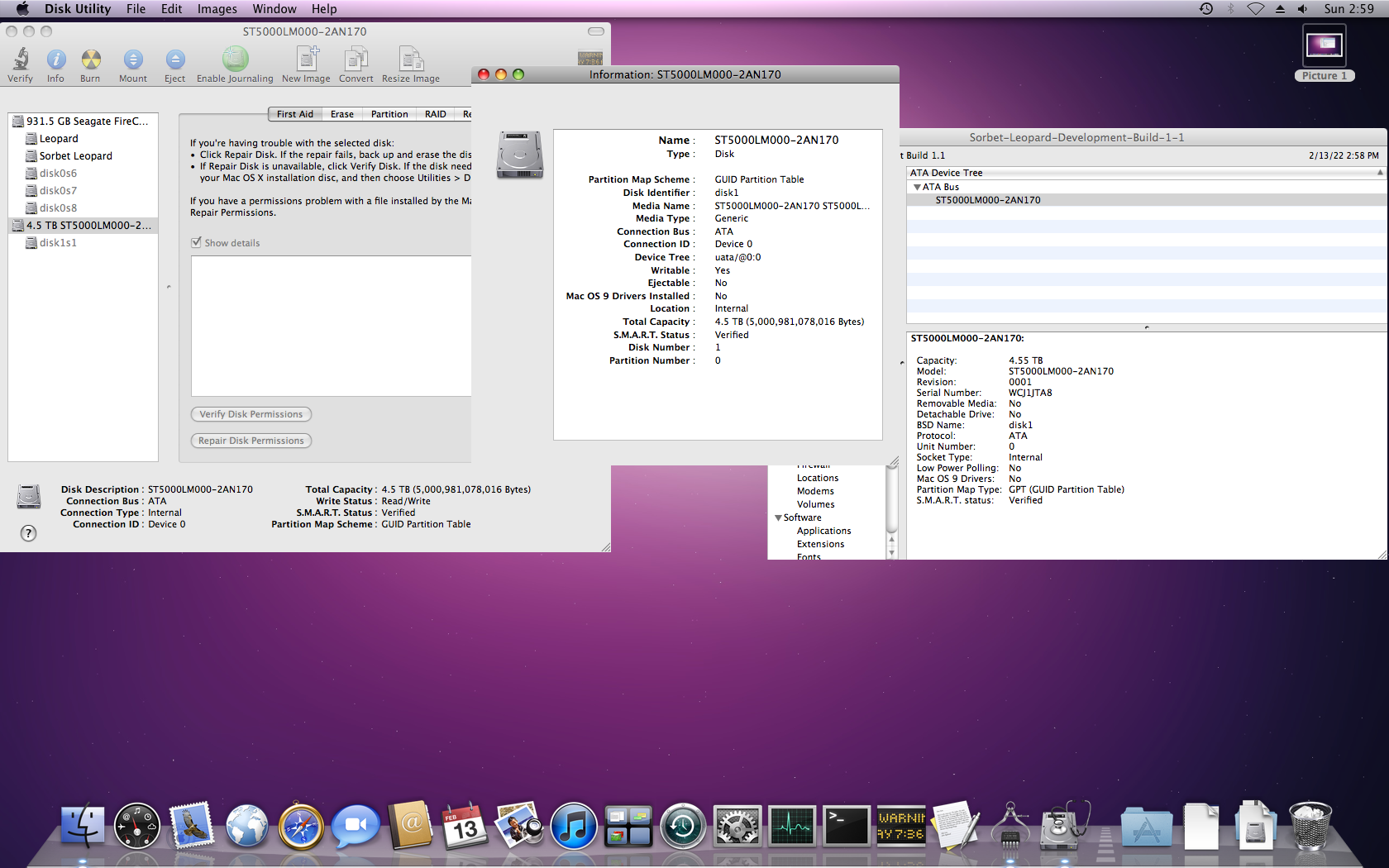

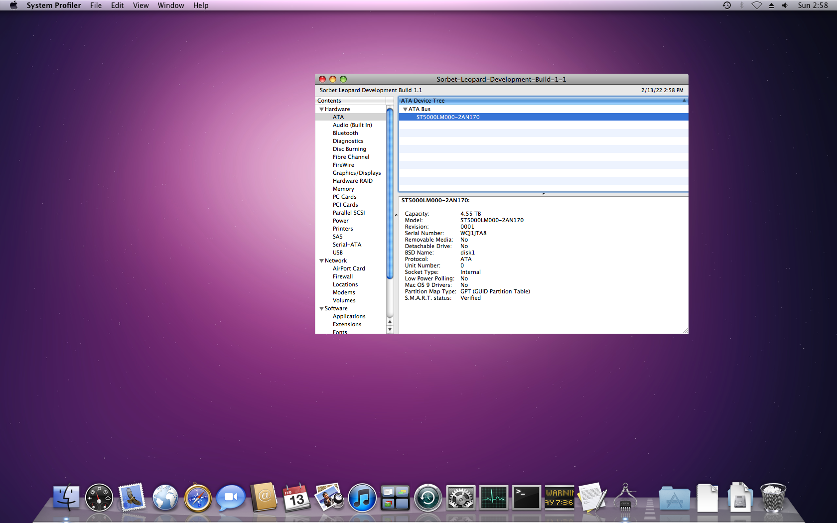

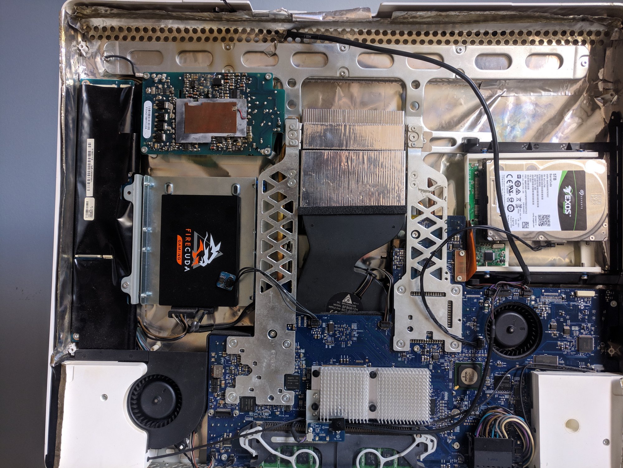

Since this latest iMac G5 it's a pain to disassembly I was objective with my test. I took the 5TB drive (It's a thick HDD considering the form factor) that it's in my Raspberry Pi4 NAS and take the chance to see if it's gonna recognize it as it was (because it is formatted in BTRFS I didn't expected to work on Leopard, but in Linux I did) and after the first boot it worked. OSX recognized the capacity and Void Linux was able to mount it.
I returned the 5TB drive to my Pi4 it was time to put the drive that I was gonna use, an old 500gb Seagate. So I tested formatting under OS X and Linux, no problem. I tried to restore some install disks to boot from it, no problem using like it.
I'm really impressed how far we evolved in the tech segment. To have such huge storages in so small footprint (the other HDD it's an FireCuda 120 SSD 1TB for my OS's)

Now the question is... can the last iMac G5 boot from a GPT disk/volume?
Right now I don't have an definitive answer
From the USB/Firewire I could boot using GPT without problems, but from the SATA or now the IDE HDD's I could test it during this week.

Yes it should work because all those models that you mentioned uses "laptop optical drives". There's a big IF, because I didn't see any Master-Slave jumper even after disassembly this adapter and putting in the 3D modeled frame...
So the iMac G5 has only 1 device connected in the IDE bus that would not be any problem, BUT the iMac G3, G4 Cube I believe that only had 1 IDE bus that you connect using the same IDE cable, so if this IDE-SATA adapter has any embedded "cable select" mode, will be a trial and error.

I don't see where this could be any problem, because once you "print" the 3d modeled frame you can reverse it too to help you fit whatever position.
And unless the Apple drives was mounted flipped or backwards this adapter it's in the same orientation.
I found more pictures of the adapter without the original metal top frame and with some thick HDD to show that you can adjust the position and be slimmer than the original optical drives
Sorry for the delay.
I tested with OSX Leopard, Sorbet Leopard and Void Linux booting from GPT partitioned HDD, and "worked" but not perfectly on my iMac G5, let me explain.
All OS worked if I booted from boot selection (Option key on chime) and if I manually define it you wouldn't notice.
BUT the OSX only "bug" it's when you try to define the boot volume from "System Preferences" wouldn't recognize the available GPT option, only APM HDD's.
