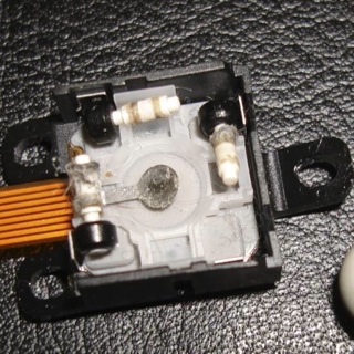

    I'm currently running a wireless mighty mouse for my iMac. I have the original mighty mouse that came with my iMac. The scroll button does not work period. I figured I would try to fix it and use for my MBP when I deploy to Kuwait in a month versus buying a new one....
    Here is what I did, I took it apart just like they stated here....
    http://theory.isthereason.com/?p=539#comment-11703
    It was really quite simple.... The only tricky part was being careful disconnecting and reconnecting the cables....they look fragile.. Not rocket science...
    Then I took out the three screws that secured the scroll mechanism to the upper part of the mouse.....YUCK CITY!!!!! It was freaking nasty in there, I consider myself to be quite the clean person....
    I used alcohol to clean everything down in here:
    [​IMG]
    Putting everything back together took a bit of patience. Those wheel/axle deal-o's will only go one way....murphy proof. The wrong way its too tight and ball will not roll. The white mechanism cage that sandwiches the ball and axles only goes one way also. You can see all the junk on those white axles, those have to be spotless if you want your mouse to scroll again...
    Tightened everything up/put everything back nice and clean...my OLD Mighty Mouse works and scrolls like its brand new...all for 30 minutes time and they guy whom posted the above pics and links....
    I would recommend this to anyone with patience and who has the ability to work a letter opener without impaling themselves...easy stuff....
