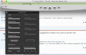

I'm looking for an alternative to quicktime player pro as well…My main use, and that I've not found an alternative yet, is slowing down audio wjile keeping the pitch and also having a couple of "bookmarks" in the file i can quickly recall, going back to that point immediately (see photo for a typical setup). Also, it's important for the application to be able to open many files at once.
The huge issue I'm having at the moment is that while QT7 Pro still works on recent systems slowing down files doesn't always work properly, with the audio cutting out randomly unless you're exactly at one of the marked spots on the slider.
