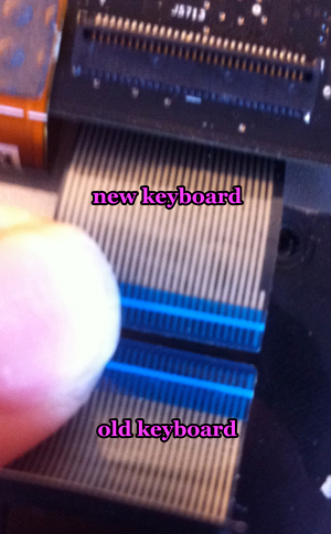

About a month ago, I've managed to spill some juice onto my MacBook Pro. I've drained it, opened it up and cleaned it. After waiting a day, I've fired it up again and everything worked perfectly.
After about 4 days, the keyboard short circuited and got stuck on one key so I couldn't do anything. I've tried cleaning the keyboard and ended up killing the whole keyboard (including the power button).
I've ordered a new one off eBay, installed it but for some unknown reason it does not work. It's pretty much the same thing - no keys and no power button.
What could be the issue?
The logic board works perfectly with an external keyboard but not having a power button is annoying.
Is the new keyboard incompatible (the pins on the connector seemed a tiny bit thinner)? I think the keyboard came from the same kind of a MacBook but a different model. Or could it be a logic board issue?

No keys and no power button = disconnected keyboard. Unless caps lock lights up, then you need to push the kbd cable in further. You can put a piece of tape on it to help pull it into the connector.
To the left of the connector, there's a cypress semiconductor keyboard controller. That *may* be the problem, in some extreme cases of water damage. You can pick up a replacement chip from digikey for right around 7 bucks. Save that as an option if you're desperate, since it's likely not the problem.
Make sure and unlatch the connector (as that is a ZIF socket). You can pull out the cable and reinsert it without unlatching, but it will not seat correctly.

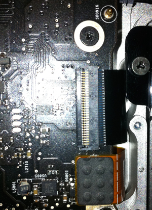

My guess is that the new keyboard was dead on arrival. I've attached a picture of the plugged-in connector. I don't think it can go any further. Am I doing something wrong?
It is not possible to damage the controller by shorting the keyboard, right? I always thought that if one part of the logic board is damaged, it wouldn't start up (the MagSafe light will usually flash).

Contacted the eBay seller about the (possibly) malfunctioning keyboard replacement. Still not sure whether it is my keyboard or my logic board.
What could it be? Did I not insert the cable properly or is the keyboard incompatible? Or is my logic board damaged (there are no other signs - everything works fine)?
PS: The caps lock light does not turn on.
