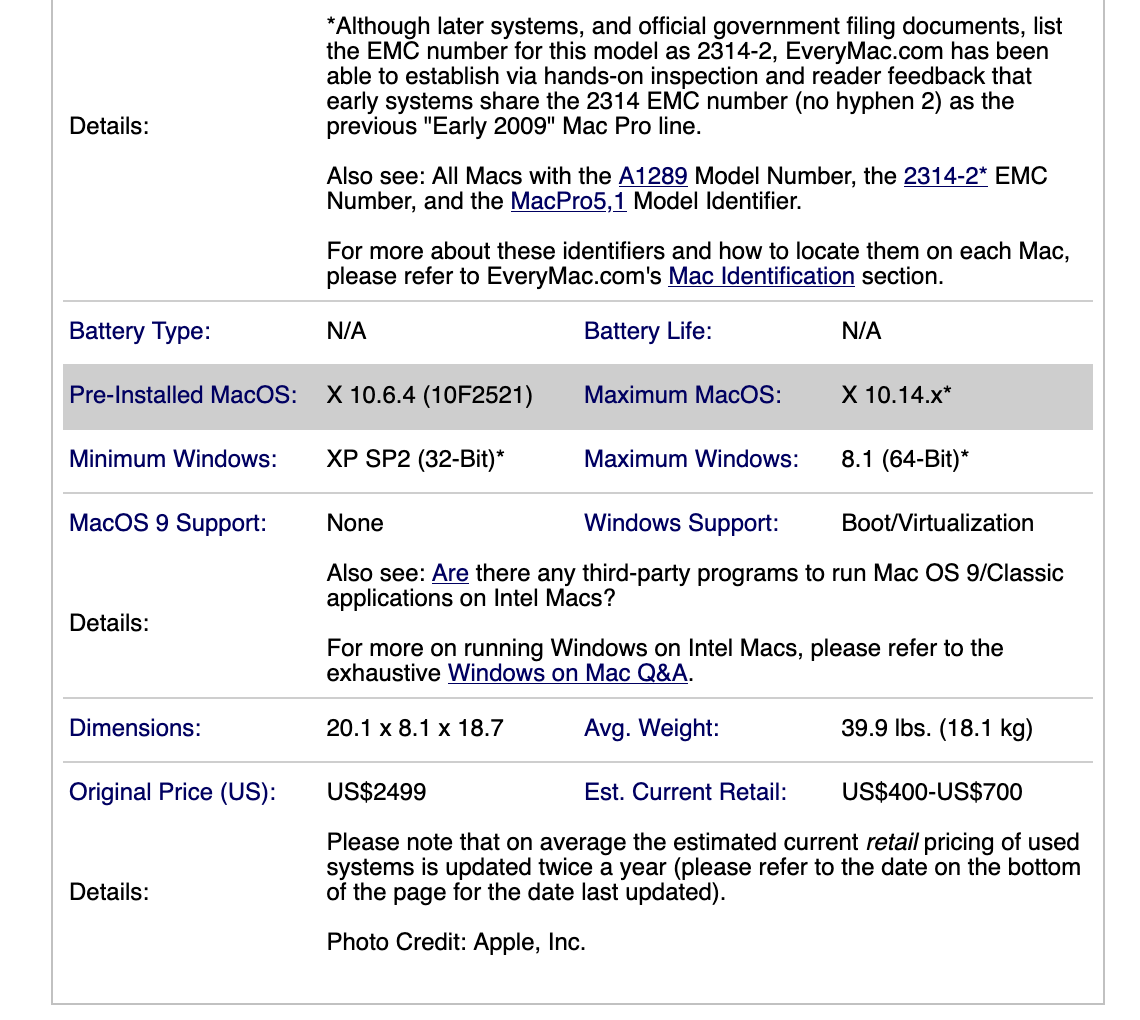

Besides the card/hardware question, are there any software limitations? If you find a used Mac, verify if everything you need will run on the oldest supported OS for that model. EveryMac is handy to see the pre-installed (typically earliest) and latest OS a particular Mac can run, down at the bottom of the model specs:
