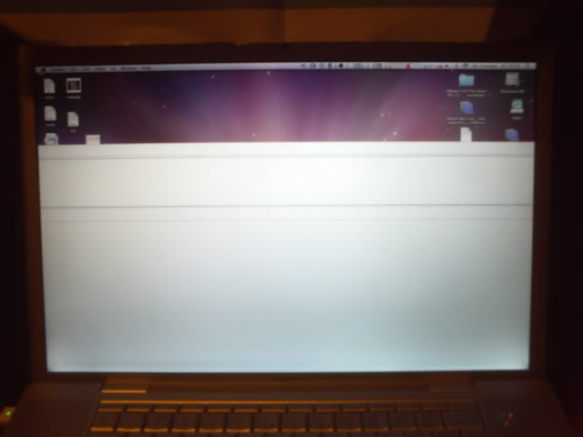

Basically my screen is fooked!!! sometimes it works and then it'll take the slightest knock or touch and BAM!!! about 4/5 of the screen from the bottom up is this grey (almost startup colour grey) horizontal covering! I dunno how to explain exactly but its sorta like the horizontal line problems some people seem to be having! but worst and its just blank! nothing but grey and obv i cant see anything below the first inch and a half from the top of the screen and its frustrating me some what!
Only way to fix it i have found is by pushing certain parts of the screen at the side and make it spaz out fully and then i close the lid to make it go sleep and 6 times out of 10 it comes back fully working again! otherwise i can close and open it all day long and it will still be there! I have to make it go full AWOL for it to reset itself somehow! dont ask me why but it seems to work haha
So I figure i must have a faulty screen or a loose connection coz when i do a screen print it doesnt show anything!
so my question is... Has anyone ever had this problem and if so what did they do AND has anyone ever changed their MBP screen (17") and how easy is it? coz im gonna buy a second hand one off ebay if its not a dodgy connection and it looks simple enough! I am pretty handy with delicate electronics i just wanna know if there is anything i need to look out for and what not!
Would appreciate the help! I will try and take a picture tonight and update this thread to show you all what is going on but im at work atm so i cant!

i took a picture of it as promised
weird eh?!?:confused:
Kind of small… Looks like the cable could be damaged or you you broken something major.
