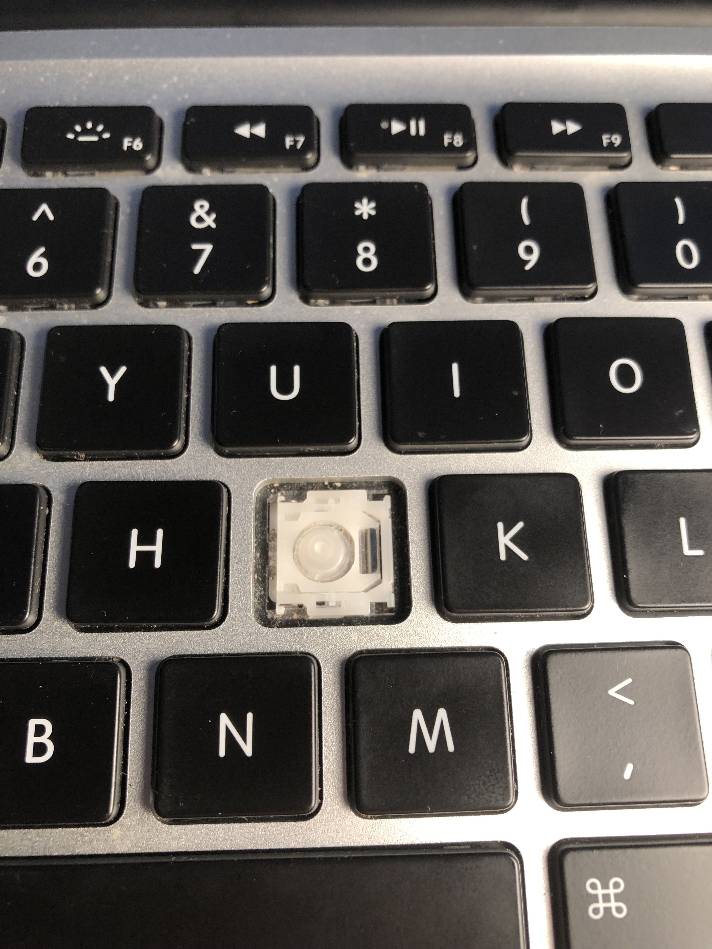

Okay if it’s alright I’ve got another question for you. I’m trying to remove the piece of plastic beneath a key on my keyboard and I’m wondering the best way to do it without damaging it. I’m replacing one for another. What’s the best way to do this? I can’t seem to find any specific answers online. What’re your thoughts. Here’s a picture

Do you mean you want to replace the keycap? The "spring" mechanism in your picture here looks in really good shape. I would say use a soft brush and canned air to clean the debris, then snap your new keycap back on. Is this what you mean?

No it’s actually the plastic piece beneath where the key would go. It’s damaged and the key will not stay in place. I’m just wondering if there’s a way to remove that piece and substitute it for a better plastic piece

Weird, it actually looks in good shape. Anyway, it is possible to remove. On the left side where it looks like two metal "hooks" hold down the top and bottom left corners of the plastic piece, just push them out from under the hook by pushing to the left. It should just pop out. Be sure not to accidentally rip the center plastic nub off, if you do then the whole topcase needs replacing.

Okay. Thank you. Yeah I don’t know why the new key isn’t sticking. Maybe it’s a different design. I’ll let you know how it goes. Thanks

Sometimes the keys look very similar but aren't the same. If you do some Googling you can find the different topcase designs, but also if you live near an Apple store they will just pop a key on for free. Another thing you can do if you don't live near a store is have a friend go in for you and mail you the key. I used to work in one, and we would always just throw them on peoples' machines because they aren't even a billable part. If a friend walked into a store and gave your serial number and said something like I bought this from a friend and they're shipping it to me can I have this key that it's missing, anyone reasonable would just give you one.

probably the key alone is broken not the scissor mechanism
