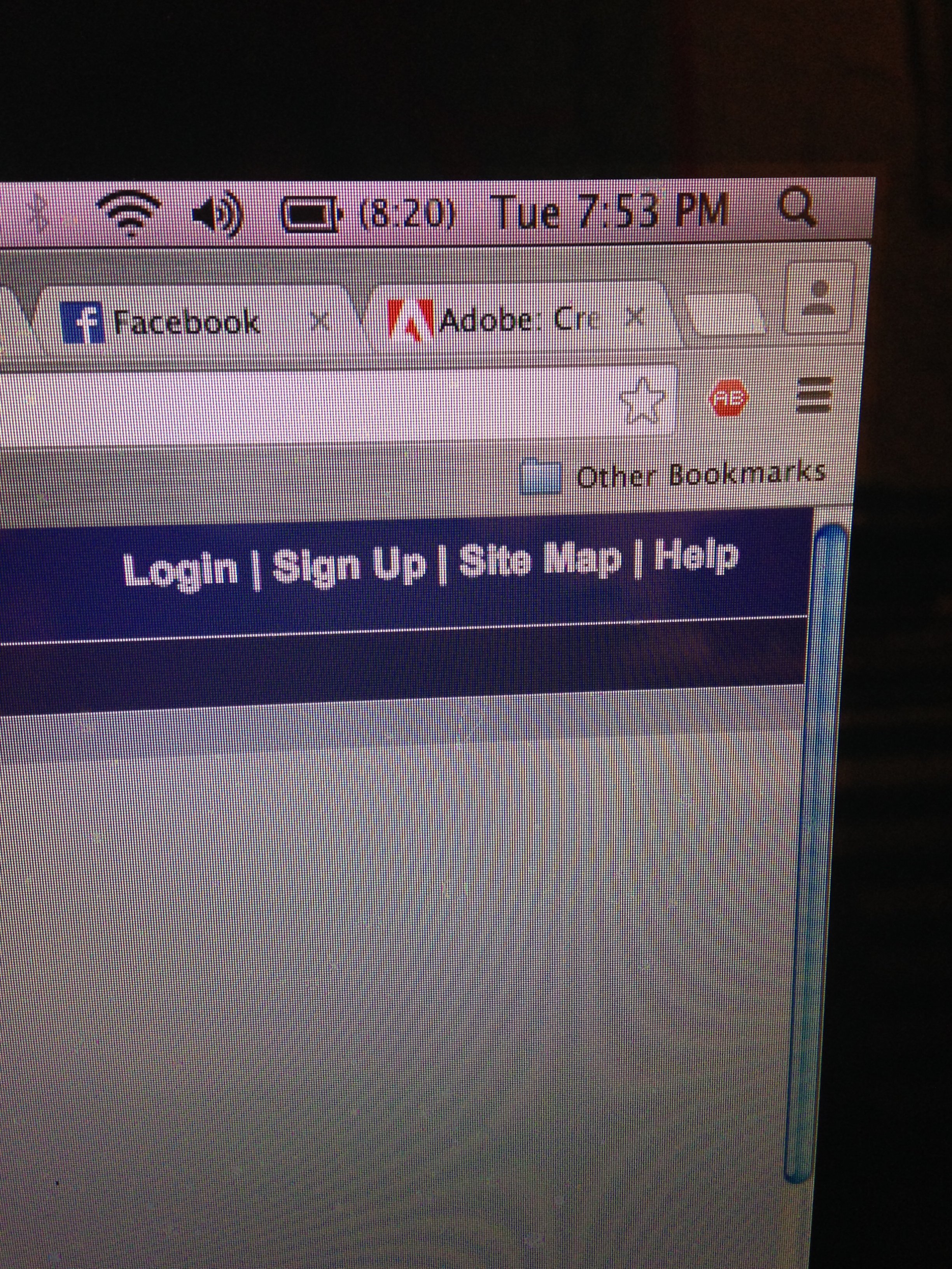

Battery replacement a success! It's been YEARS since I've seen this much charge! Just a like new computer!
