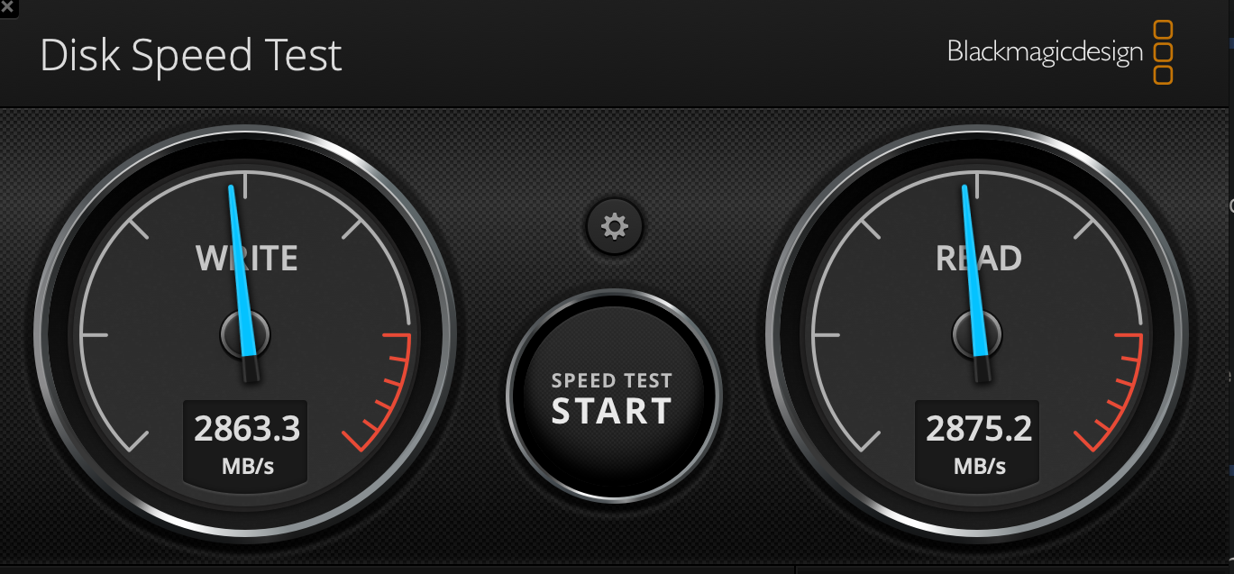

After replacing the 2TB spinner HDD a couple years ago with a Silicon Power 1TB SSD and recreating an all-SSD Fusion Drive, my iMac performed amazingly in comparison.
Fast forward to now, and the 128GB Apple blade SSD was getting worn out. DriveDX reported that the lifetime wear indicators showed in the 50% left range. So that's not bad for a 7yo workhorse, but not good.
Also, while the new configuration ran circles around the old HDD version of the Fusion Drive, I knew that newer blade drives would get things moving and breathe some fresh life into my old iMac.
Found a great tutorial on YouTube for this as it requires far more disassembly of the iMac than just replacing the platter.
I purchased a $12 adapter from Amazon which allowed me to utilize a 1TB Western Digital Black SN770 NVME.
Surgery went well and Humpty was back together again. The old read/write was about 1800/375. 😕
Overall, the difference is noticeable from installing updates, opening apps and boot times. Much faster.
