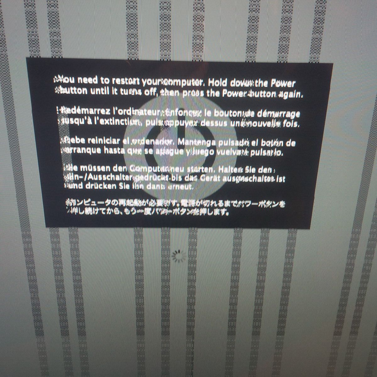

Hi all,
Apologies for my first post being a plea for help, but I've looked everywhere for an answer.

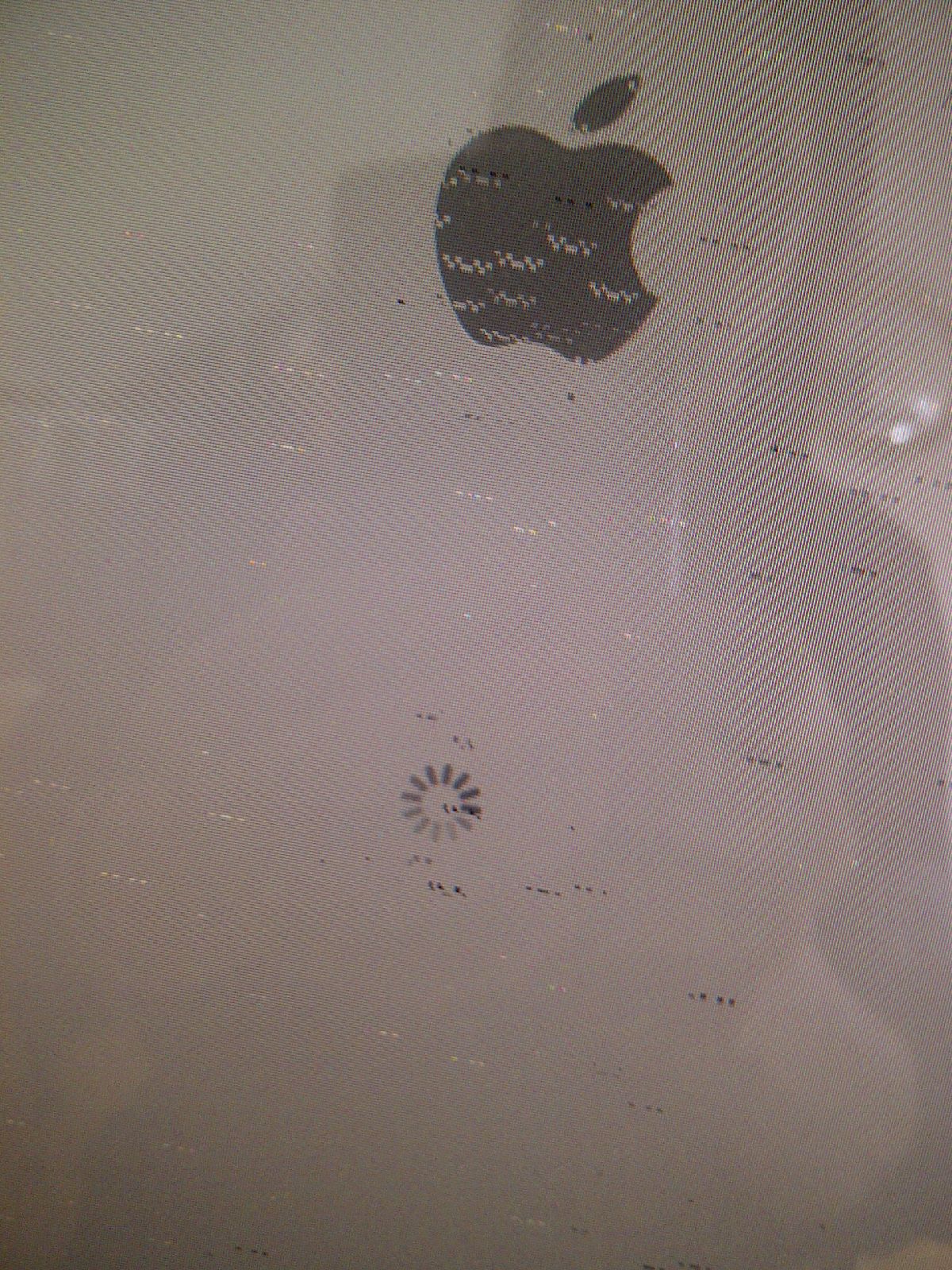

My iMac 24" early 2008 went caput. The screen was covered in a kind of herringbone pattern as per the first photo. I tried the single user boot and the fsck repair attempt. It came up that files had been modified but couldn't be repaired and eventually it was suggested on another forum that it was a hard drive failure. I bought diskwarrior to try to recover as much data as possible and bought and installed a new hard drive, but the same graphic issue came up as per the second photo.
So it was then suggested that it was the video card.
After having a look online, it looks like the video card is replaceable and being a have ago kind of gal (who is also almost broke), I want to try and do it myself. Thing is, which one do I get and are they available in the UK?
Any help, advice warnings or whatever gratefully accepted! 🙂 IMG-20150529-00094.jpgIMG_20150731_213739.jpg

Don't buy a 'new' graphicscard. All of them have the same problem and the ones on ebay or at shops are most likely refurbished/reballed/reflowed cards. They WILL fail again and probably soon.
Easier is to reflow your own card. Or have it done somewhere locally. Don't go for reball, it's a hefty premium for only a short extension on its lifetime. Reflow is something you can do once or twice.

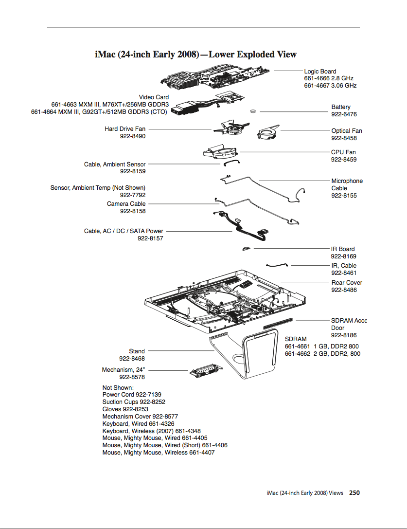

Hi. I've got a 24" Early 2008 iMac 8,1 (using it right now). The graphics card is replaceable in these machines. My understanding is that you can use either one of the two cards that were originally used in the 8,1. In other words, I don't believe you have to replace yours with the same card you now have.
Mine has the ATI Radeon HD 2600 Pro (256 MB), and I recommend you look for one of these and NOT the NVIDIA card, because from what I've read the NVIDIA ones fail much more often. In any case, try to make sure the card was made for a Mac; I believe that there was also a version of the ATI Radeon HD 2600 Pro for PCs, and it will not work in our iMacs (at least not without making flashing the firmware or something like that, that I know little about).
This image from the 8,1 repair manual shows the Apple part numbers for the two graphics cards: https://dl.dropboxusercontent.com/u/15764755/iMac 24-inch Early 2008 lower.png

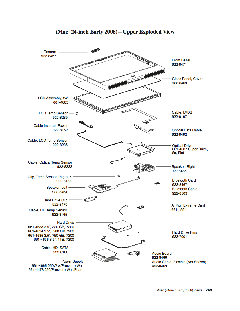

Here's the matching image for the rest of the iMac:
https://dl.dropboxusercontent.com/u/15764755/iMac 24-inch Early 2008 upper.png
Hopefully that will help. I don't have much opinion on the reflow option, or even whether the graphics card is the cause of your problem, as luckily mine is still working. (I am curious, though, about what release of OS X you are running. I did have serious graphics problems under later versions of OS X 10.6 (Snow Leopard) that, oddly enough, were solved by using earlier versions of the graphics driver kext files.)
