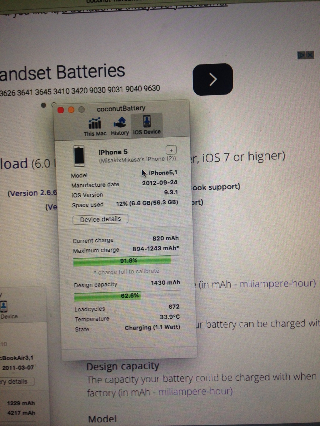

I plugged in to my computer and use iBackupbot to check the battery. It shows 1000/1500. So it is at 67% of design capacity. I don't know if it is accurate, but that is what I get.
