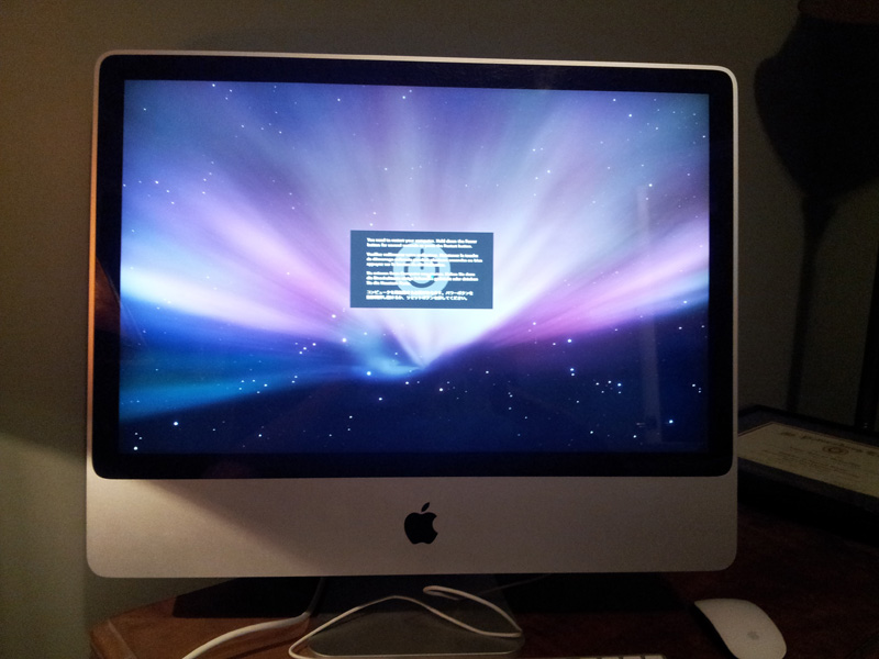

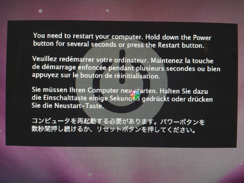

Decided to just hook it up tonight for kicks and giggles. It got to the user account screen, clicked on his old user name, entered the password and this came up right about when the desktop was going to load all of his old information.
I remember he made a 'test account' name on there because it would actually get to the desktop before the message popped up. Not sure what the difference would be in that but I'll try that next.
It also freezes the mouse and keyboard so nothing can be done other than restarting the computer by holding the power button on the back side.

If it boots that far it's likely the logicboard is still good. That model iMac doesn't have any widespread logicboard problems. The problem you have is likely the hard drive has failed or is dying.

You may be correct about the HD however what is occuring is your getting a Kernel Panic which can be caused by hardware or software. If it's software the fix is fairly simple, remove the offending app. What you need to do is post the last panic report, Apple explains how to do this. Please look over:
http://support.apple.com/kb/ht2546
and then post the COMPLETE report. Someone on this board, maybe me should be able to read it and point out if it's an app or not.

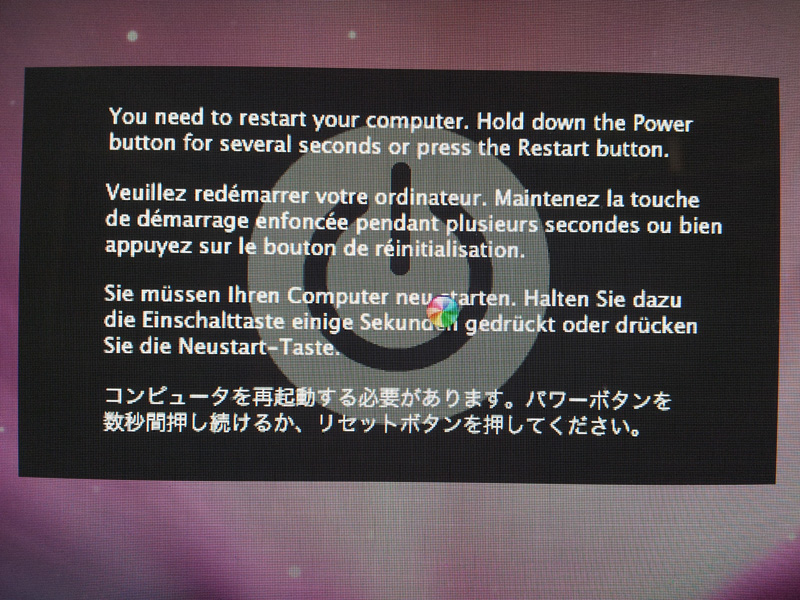

This is very strange. I logged into the 'test account' and switched over to the regular account and I've been using the computer like nothing is wrong with it. I e-mailed a few documents he wanted and am actually transferring some of his old music via the network to my iMac. I've NEVER seen it stay on this long without causing the kernel panic.
This is common for Hard Drives that are failing. Sometimes they will work fine for a few days or weeks and then go back to the problems. There is no harm in using it for casual stuff if it is the hard drive, but don't put anything important on it.
Does the hard drive make any clicking sounds? Also could be a fan not spinning, does it get hot?

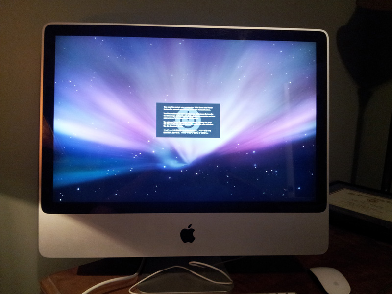

Just a picture showing what I was working with tonight. Still letting stuff load and back up (on my iMac). I did find out the sound doesn't work on his though. I go into Sound --> Output and nothing is listed. Something must have messed that up but I'm doing a system restore in the morning anyways. Hopefully that'll take care of it.
After it staying on for nearly an hour and a half (I think), I restarted the computer since the speakers were not working. Booted up pretty quickly and the speakers were working after the reboot. I began playing a few songs in iTunes and got another KP. :/ Hopefully its iTunes related. I also put in one of the old memory chips. It originally came with (2) 1GB chips and I put in the (2) 2GB chips he upgraded to. Running the hardware test now.
Here is the KP:
