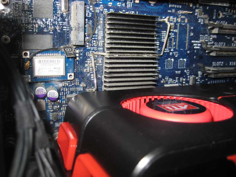

I recently fitted at 5870 to my 08 Mac Pro, the only minor annoyance was the heatsink just to the left of the PCIe slots. This stops the PCIe slot clip from closing, with force you could probably make it close, but it'll be putting a lot of pressure on the logicboard.
As far as I can tell the 5770 is the same size in all but length.
Of course, I could be missing something, but it seems this could be why it's not officially supported, as the software works fine.
Hmmm. I don't recall having this issue..

Seeing the heatsink proximity I checked my Sapphire HD5870 Vapor-X card, it doesn't seem to sit as close and would possibly be a better choice. The PCI-e clip locks over fine too. The fan is fitted centrally not at the back end of the card, this could be significant.
