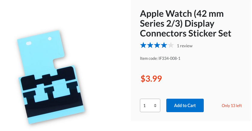

You damaged the dual ribbon display connector somehow, and that’s why you’re having display issues where it functions and then does not. That’s the only logical reason. If they are in fact damaged, there’s nothing you can do, as they Apple Watch would need to be replaced.

I found the attached part on iFixit. Is this what your are talking about? Screen Shot 2019-05-24 at 5.14.33 AM.png
