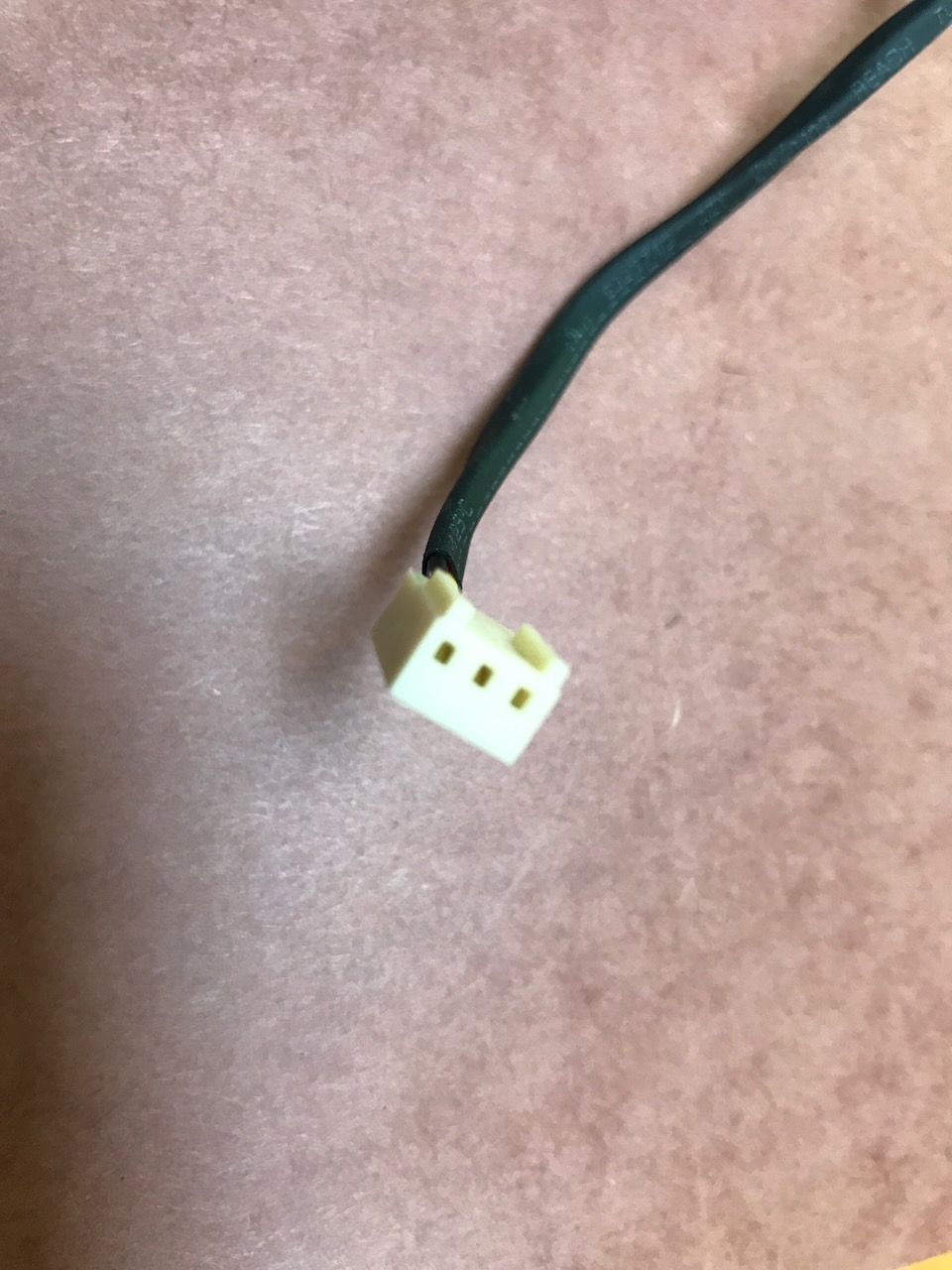

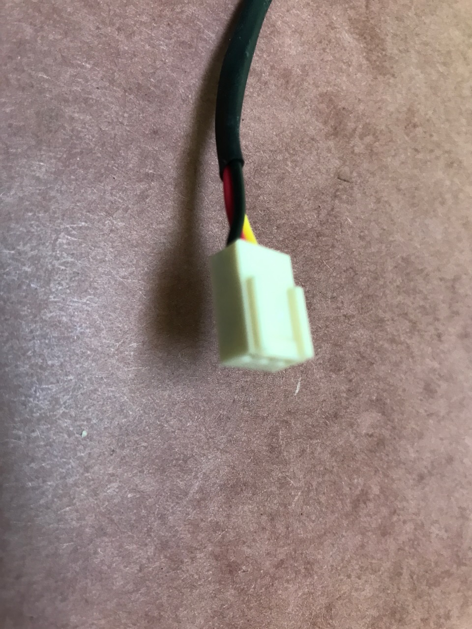

I recently purchased an OWC Thunderbay 4 (Thunderbolt 3) enclosure and am considering replacing the OEM Sunon fan with a Noctua NF-A9 FLX.
Is it true that the three-pin connector on the Noctua will not fit the three-pin receiving connector inside the Thunderbay?
If so, how have folks worked around this?
Do any of the included speed reducing cables solve the possible three-pin to three-pin issue?
Photos of OEM Sunon fan three-pin connector below:

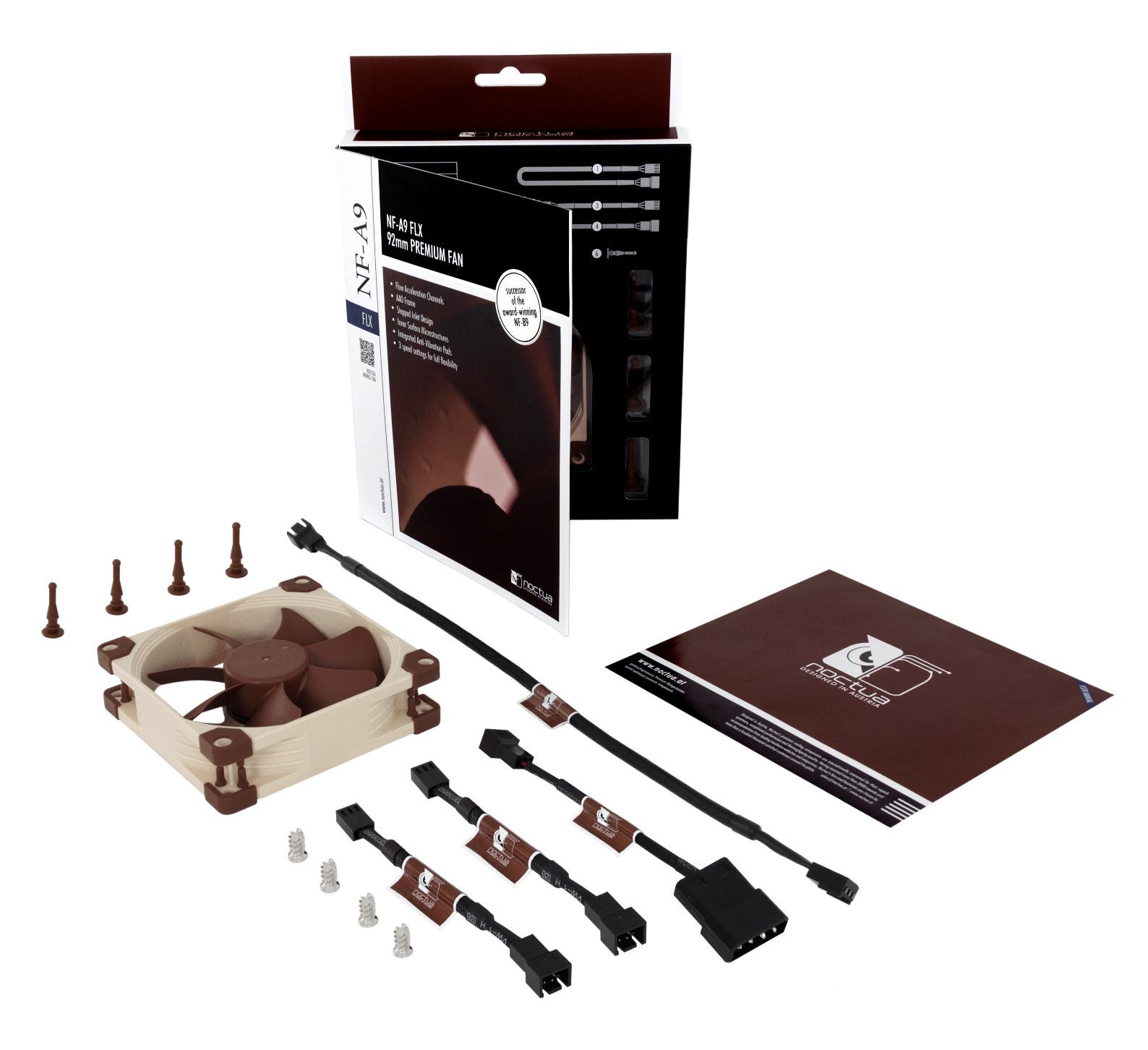

The Noctua-supplied choice of cabling should be sufficient. The long cable on the right, IIRC.

The photos are of the connector on the fan that came in my new-to-me Thunderbay 4 (full size) enclosure.

On a related note, I have replaced the fan in the back of the enclosure with a Noctua NF-A9 FLX 92mm fan. The kit comes with two speed reducing cables and I am using the one that slows the fan down to 1050 RPM and the fan noise is now much less than the hard drive noise. The supplied three-pin connector for the fan fits the one inside the OWC case so installation was a snap.
