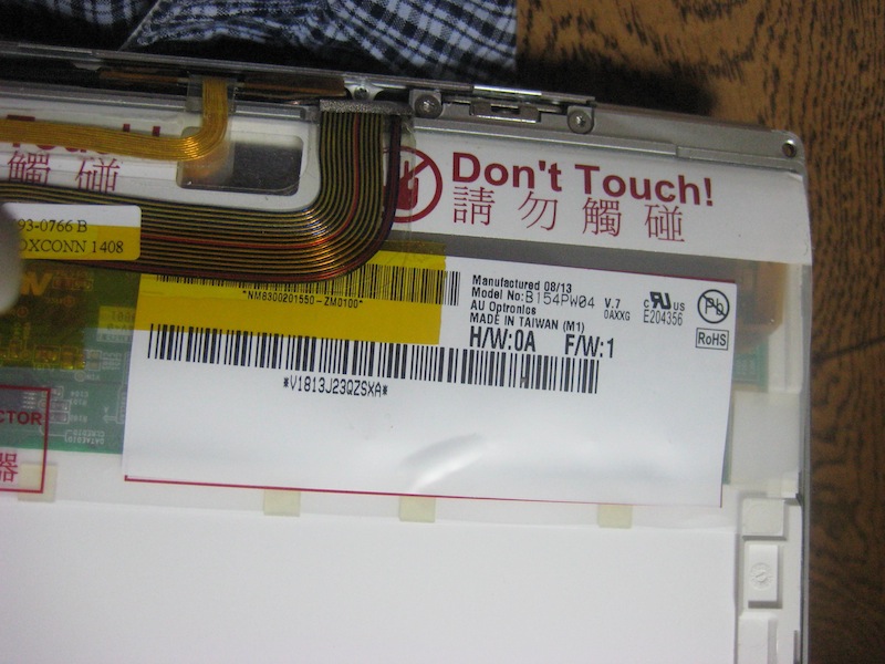

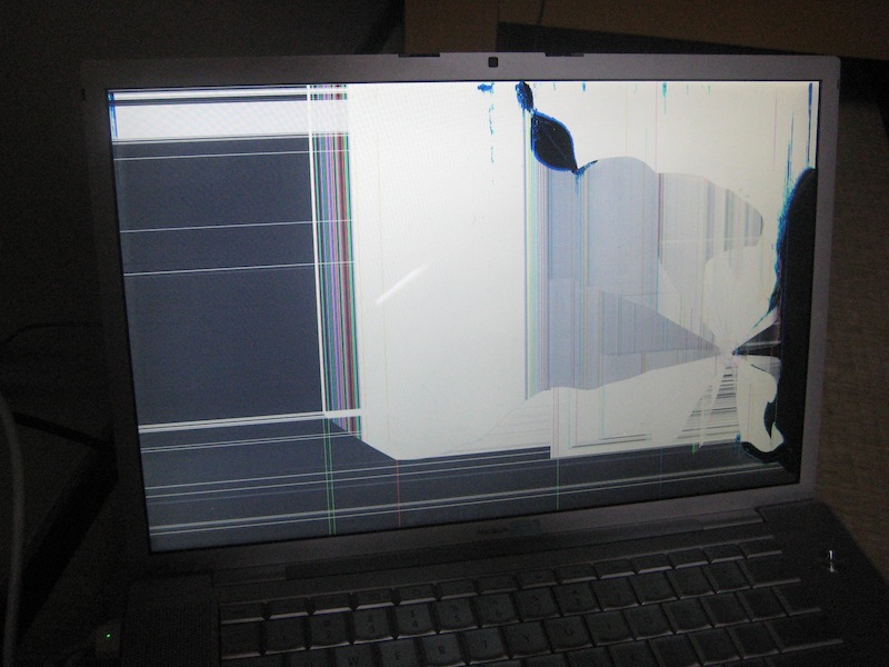

I broke my screen as well
I have a A1260 2008 Early Penryn Model as well.
I threw a pencil at and this is what happened. Won't do that again. It was mentioned earlier but a BP154PW04 V.0 or V.6 would fit in a A1260.
I opened mine up it says its a BP154PW04 V.7. Is there a difference between V.6 and V.0.
Also I checked on ebay and they have the Chimei model mentioned up for pretty cheap. I am not particularly picky on the image as long as it looks decent enough.
Thanks for the help!
