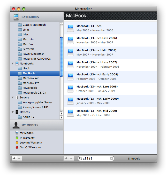

Be careful, it might fit but there's a chance it won't.
There are 8 different a1181 13" models over a time span of 3 years!

No, I don't know, if you wait and see if others come here they might know.
They are all the same resolution but you don't know if the wiring/connectors are the same.
