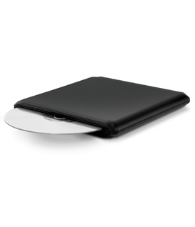

SuperDrive enclosure is actually the toughest around, I spent a lot time looking and I just finally gave up and got the OWC one. And it actually looks great and it's pretty slim. I put one of my white apple stickers on it and it looks like an Apple product.
http://eshop.macsales.com/item/OWC/VLSS9TOPTU2/
It's 39.99 which is pretty steep, but I was tired of looking around. I don't trust ebay when it comes to anything electronic so the enclosures there weren't available but there were a few options. There are a few options on Amazons too, most are PATA/IDE which the SuperDrive is NOT. You need SATA. Also, some of those have no front cover since those cases are normally designed for tray loading drives that would fill the space in the front. I had a case like that with this drive, there's just a big empty space, it looks unfinished, and I just wasn't liking it and it was only a $20 difference (I think) but the S&H at OWC. OMG.
