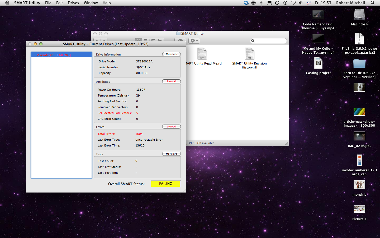

I am well aware about the pitfalls of opening up a imac G4, thats not my question, I was wondering what is the best thing to put in the hdd slot, I don't think I have enough money for a ssd but I'm wary of buying a second hand ide HDD and was wondering whether a adaptor to sata is best or just a new ide hdd. Im not too worried about space or speed as its a secondary pc but anything over 80gb is best.
Pic attached as to why I need to replace the HDD, but I think its done well for a 10 year old iMac
So what should I do?

The reason I mentioned sata is mainly for availability of drives and bang for buck is important too, I forgot to mention that I have a 160gb 2.5 inch sata kicking around which I've owned since new from a now dead netbook. A ssd at that price sound great I just can't find anything in that price range in the uk on ebay or amazon. Yes storage space isn't really an issue because I have 1tb in my Mbp a USB seagate go flex 500gb and a WD 1tb mybook nas.
So I have ordered an equivent of what you said http://www.amazon.co.uk/gp/product/...ails_o00_s00_i00?ie=UTF8&psc=1#productDetails so for £1.77 I'm taking a punt if it doesn't work then I probably will just 3.5 IDE drive. Your quite right that there is not much room in the iMac which is why I'm going to fit my 2.5 inch drive with the adaptor.
