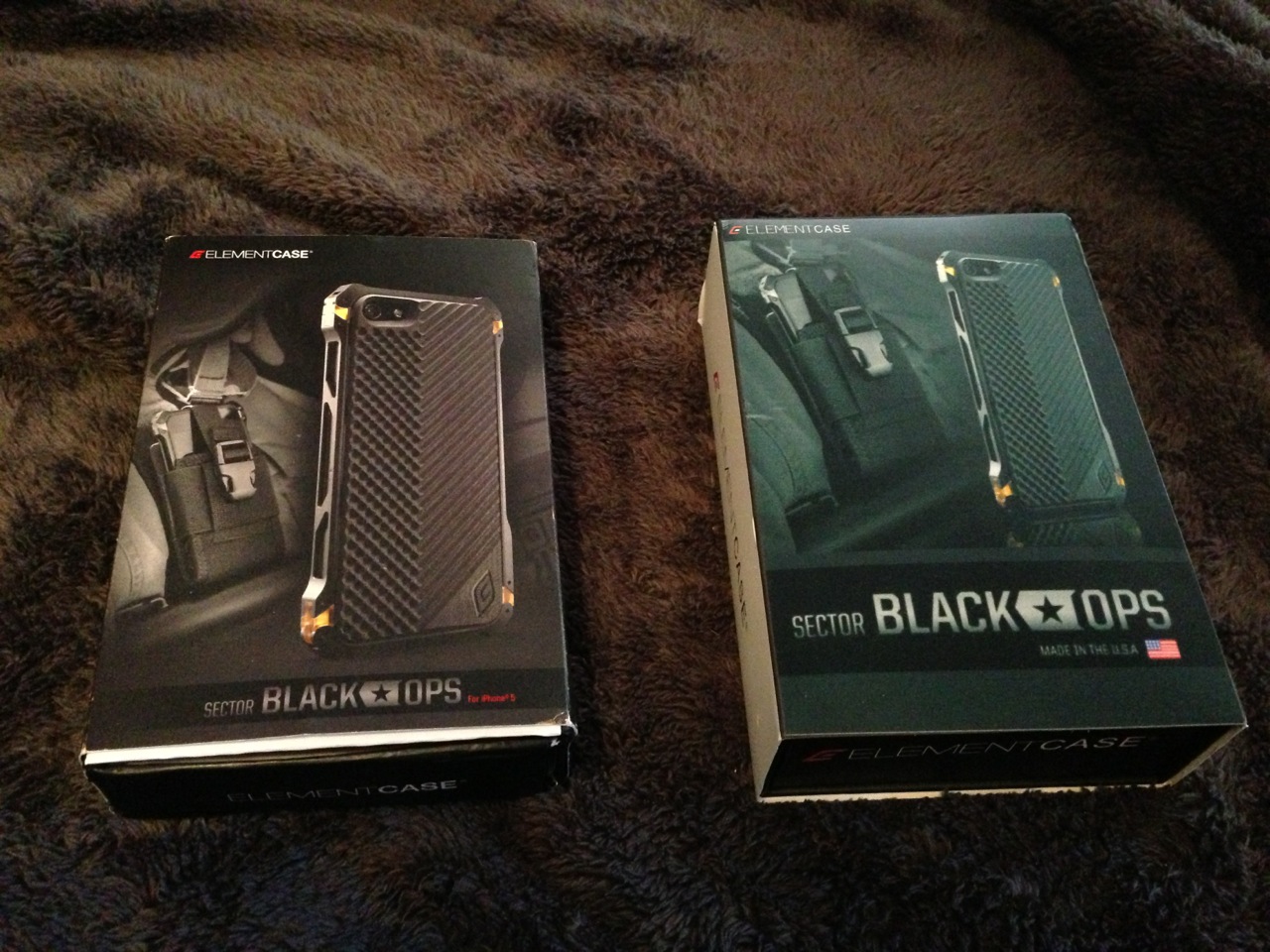

The fake box is a bit bigger and has a glossy printed cover with pretty poor color saturation. Then again, when I originally received the real thing my first thought was that the box looked fake too.
Slight difference in presentation (no window on the fake box), but otherwise very similar.

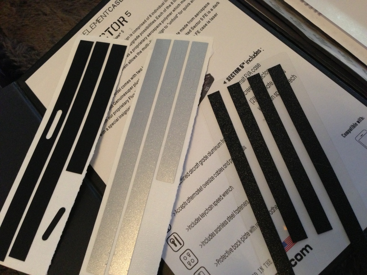

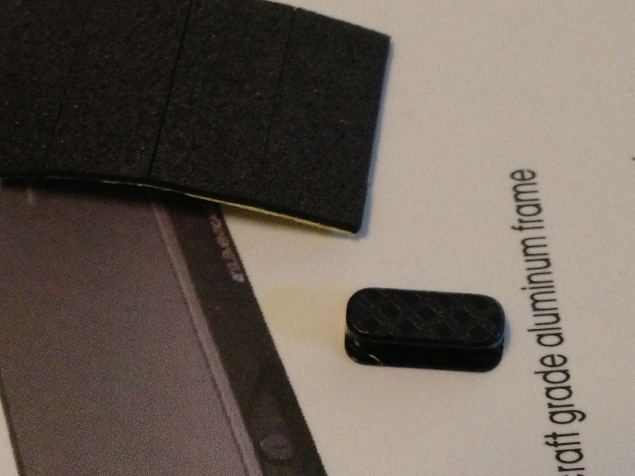

The fake comes with some very narrow rash guards made out of a thicker material. No bezel protection at all.
The manual is clearly copied directly from the real thing.

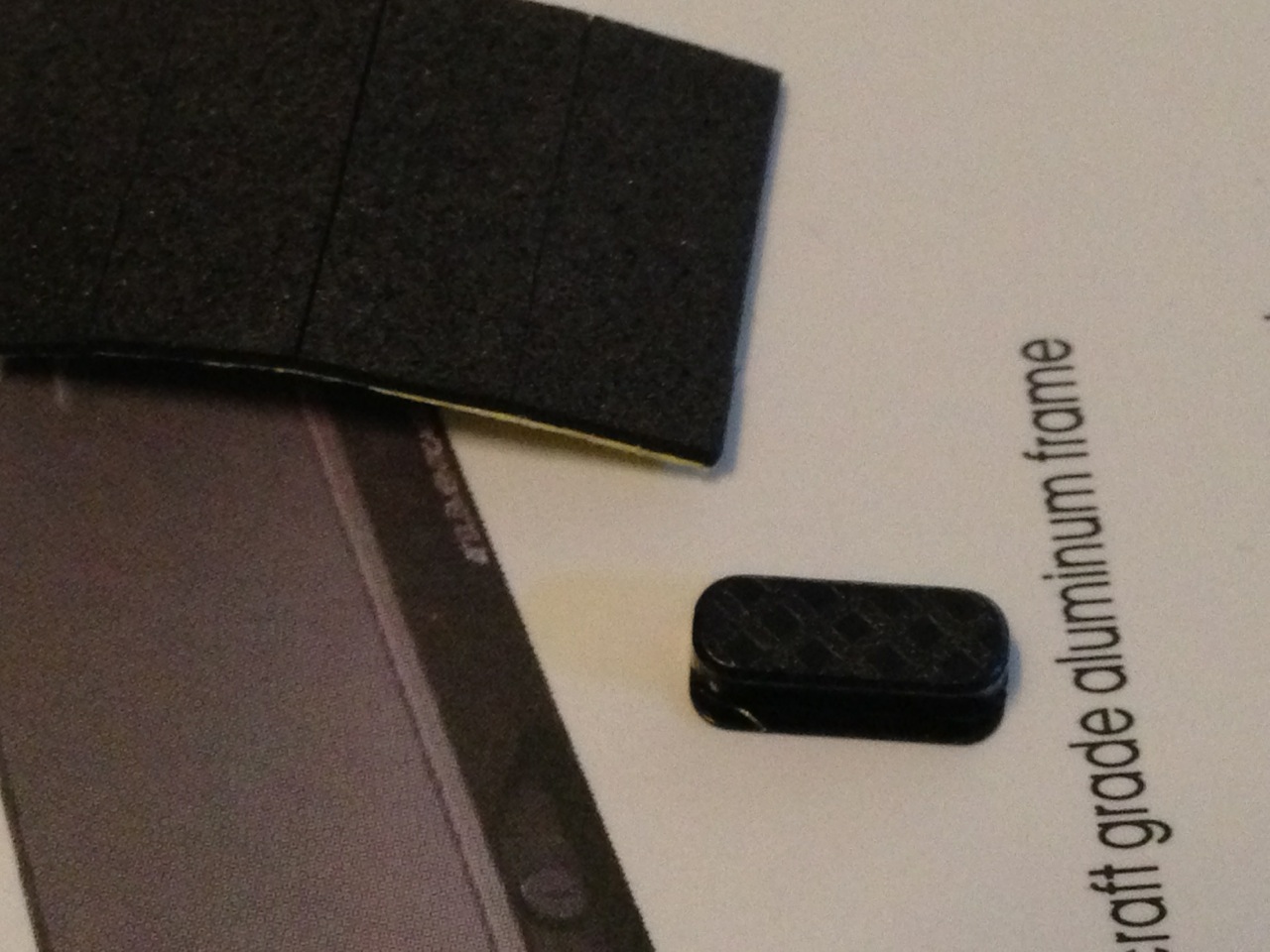

Hard to see here, but the case comes with 4 rectangular foam stickers to insulate the phone from the case, as well as a power button with a lightly etched crosshatch pattern.

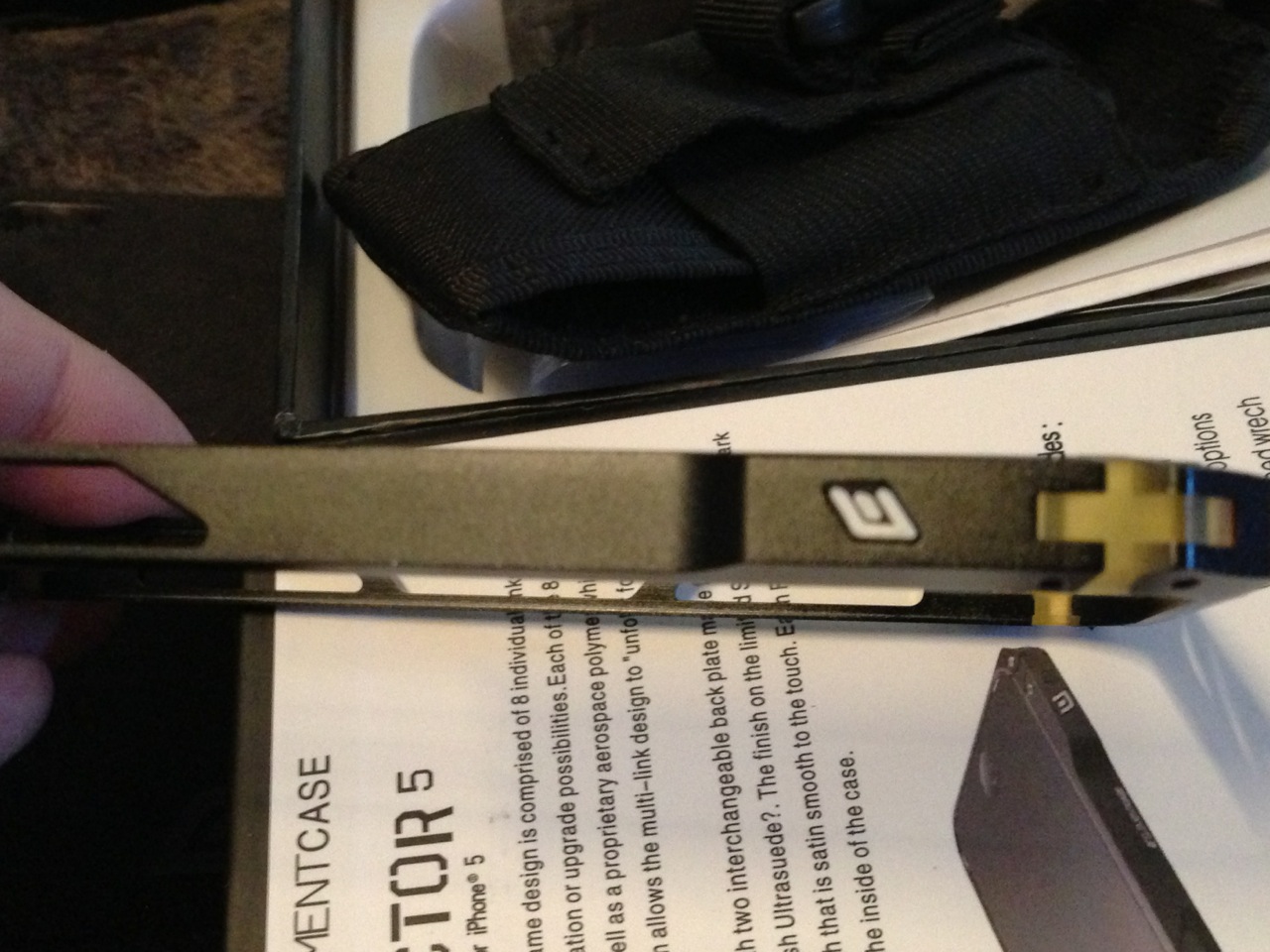

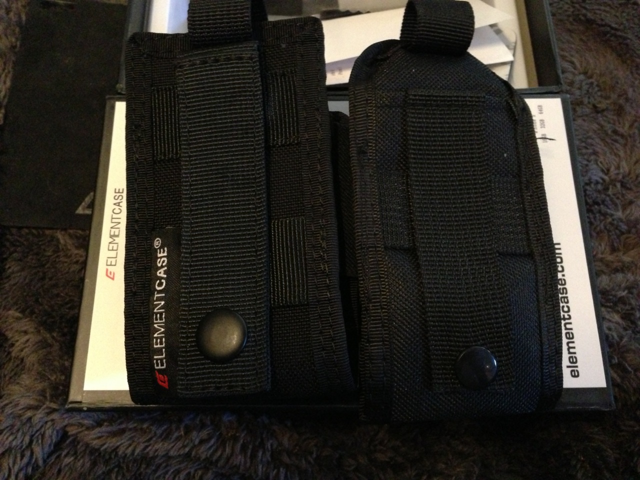

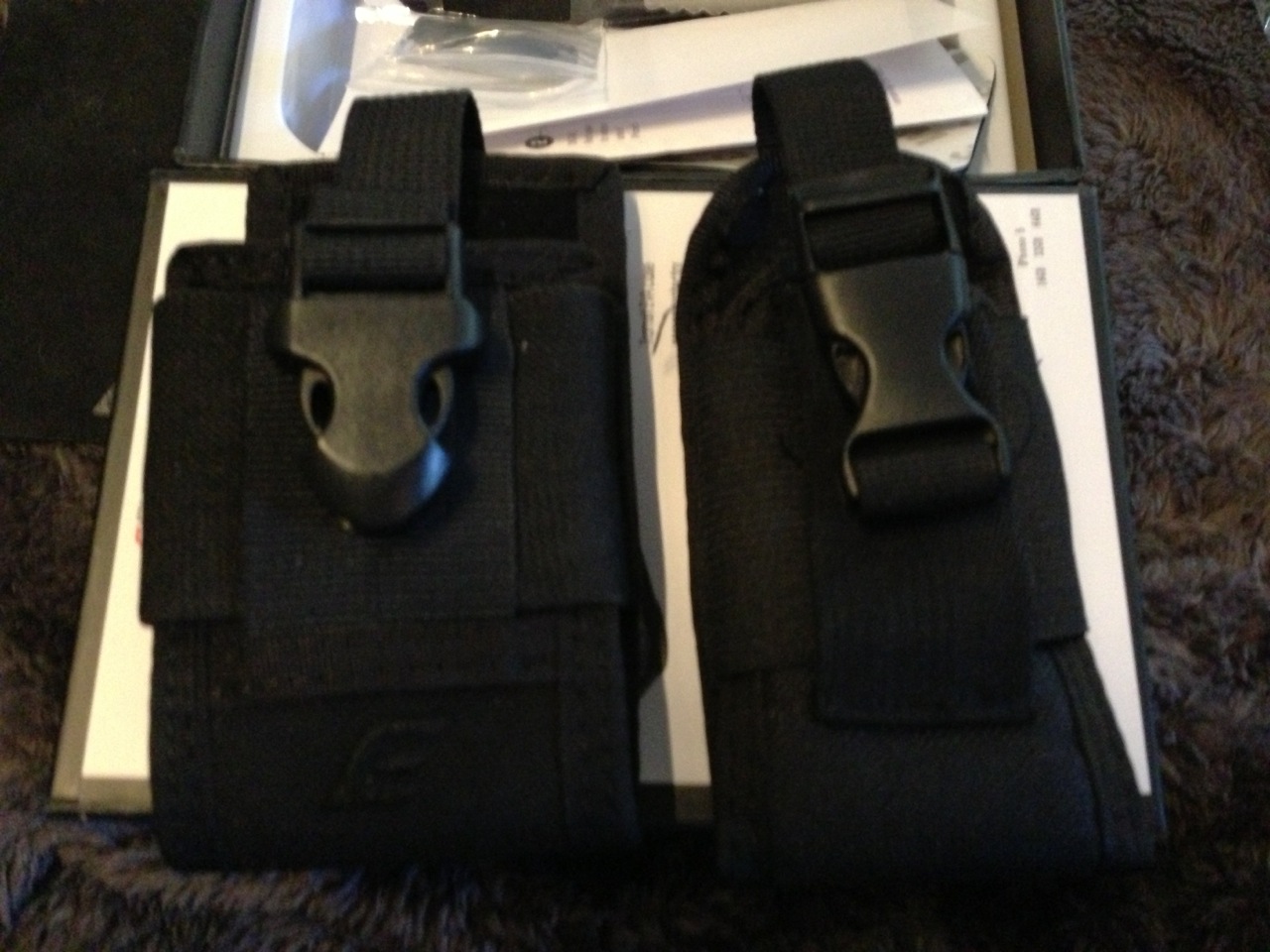

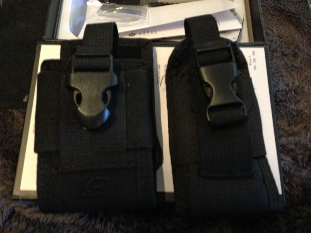

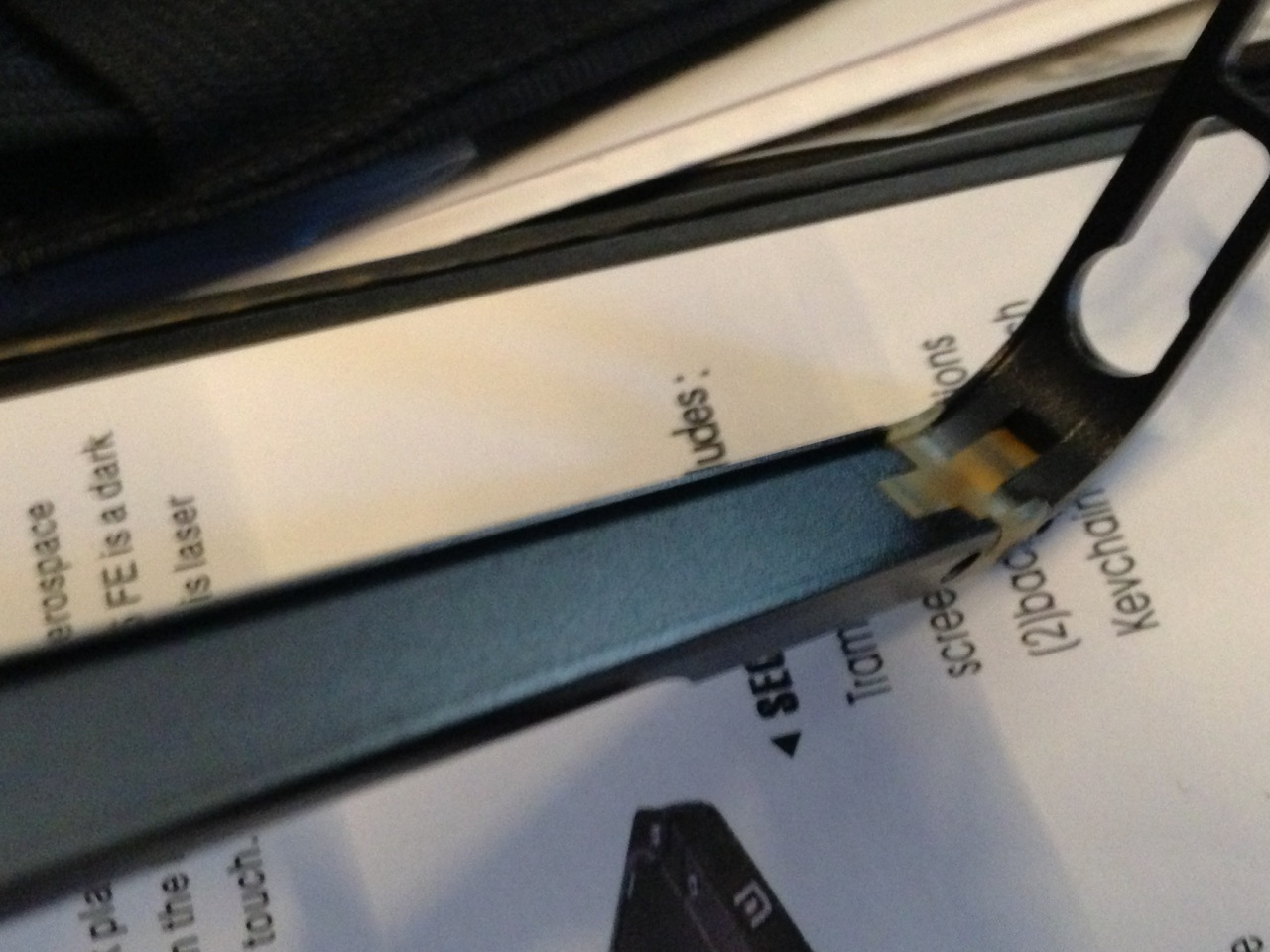

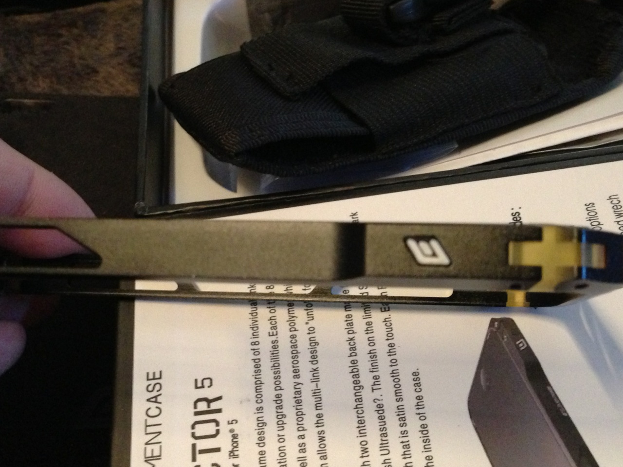

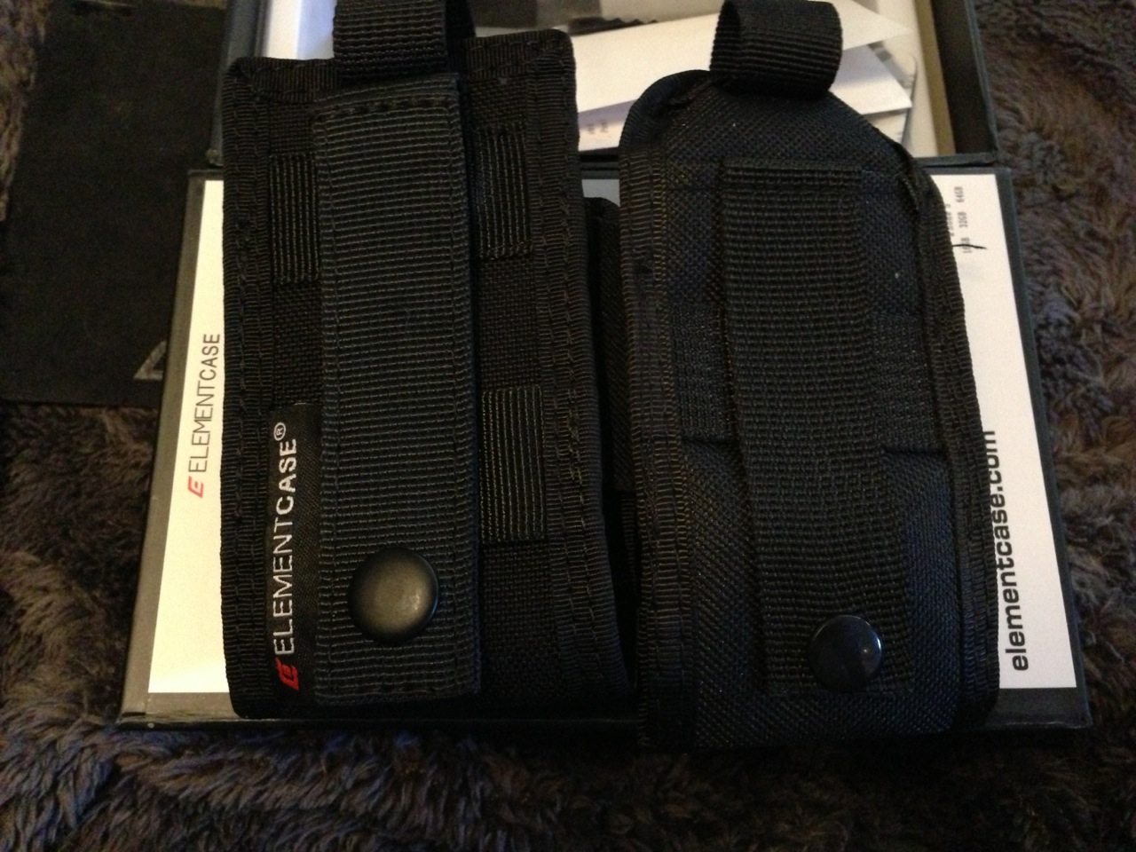

The nylon case is quite different. Very poor quality and flimsy, much smaller than the real thing, much more flexible, and no embroidery or tags.

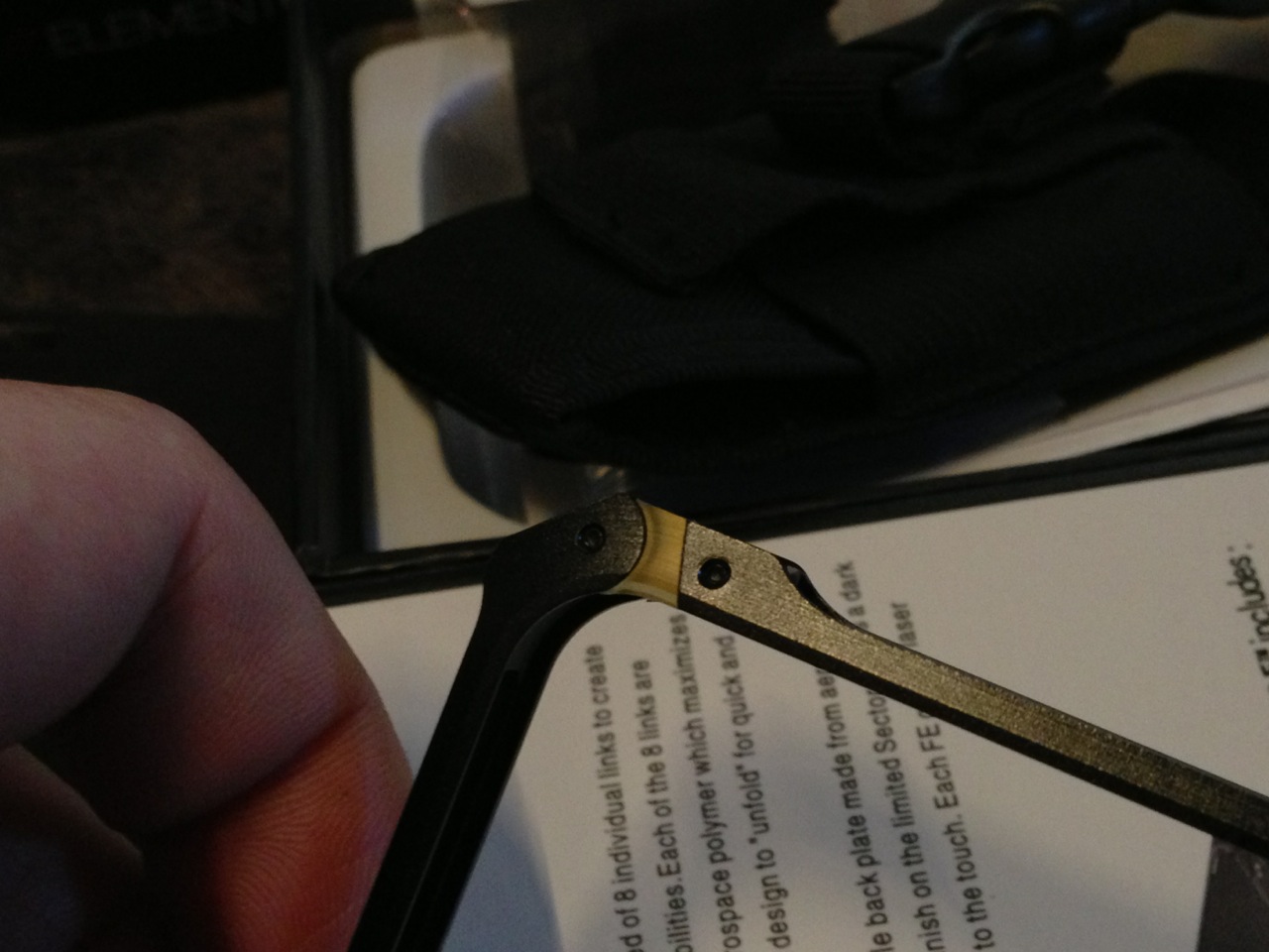

I tried to get a shot of the finish. It's shiny, the edges are definitely sharper and the surface finish is rougher with visible lines.

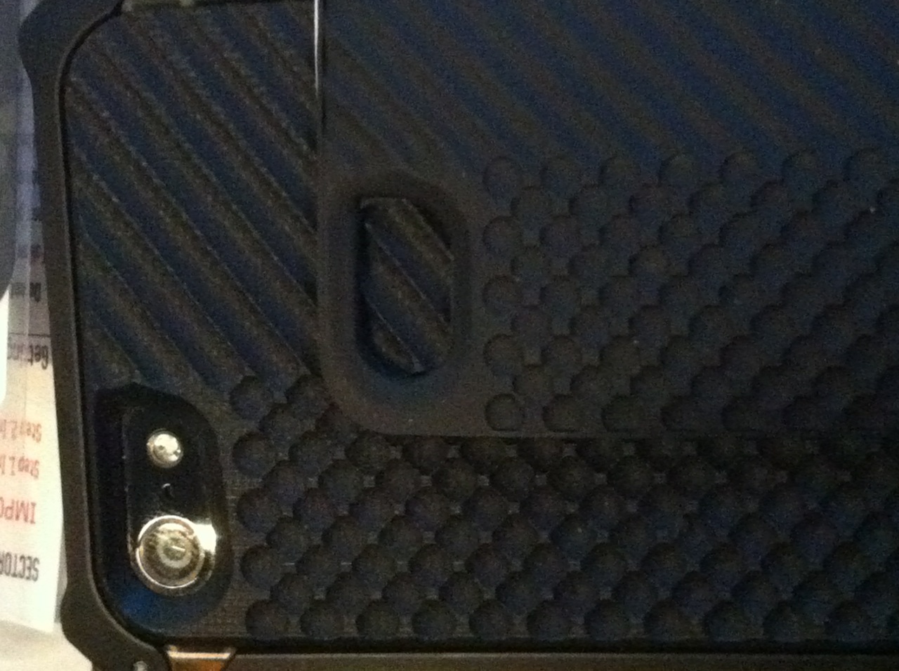

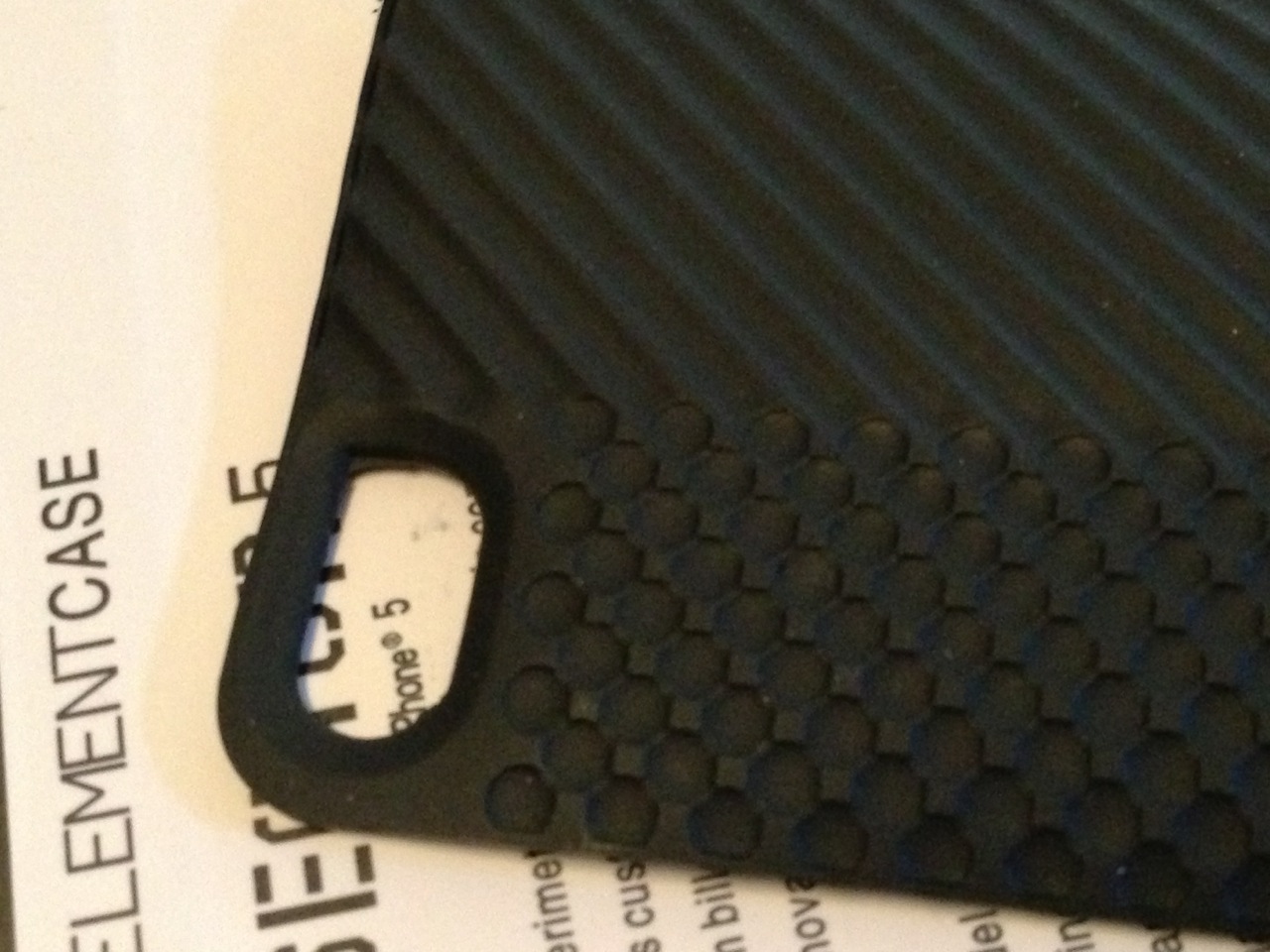

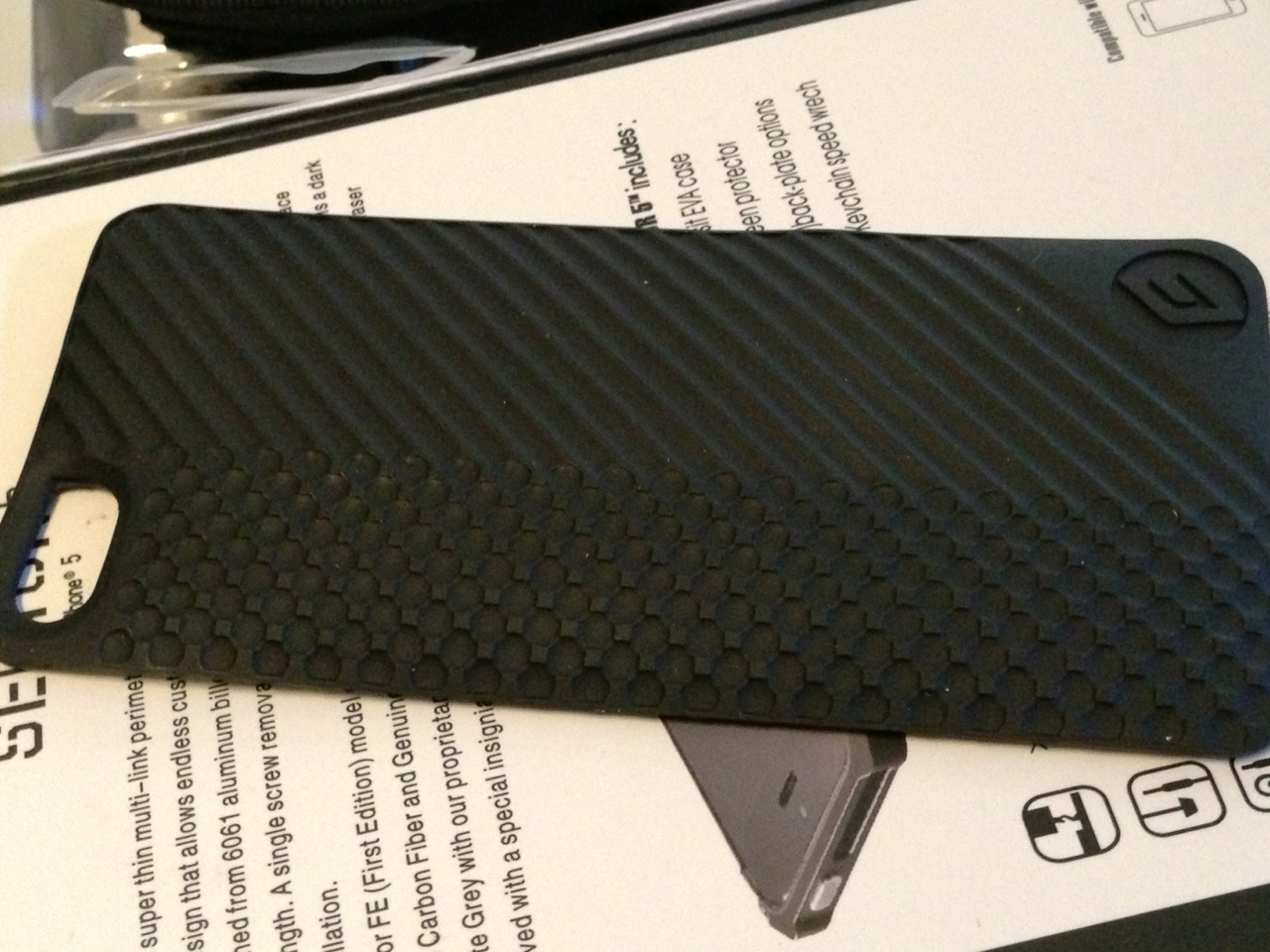

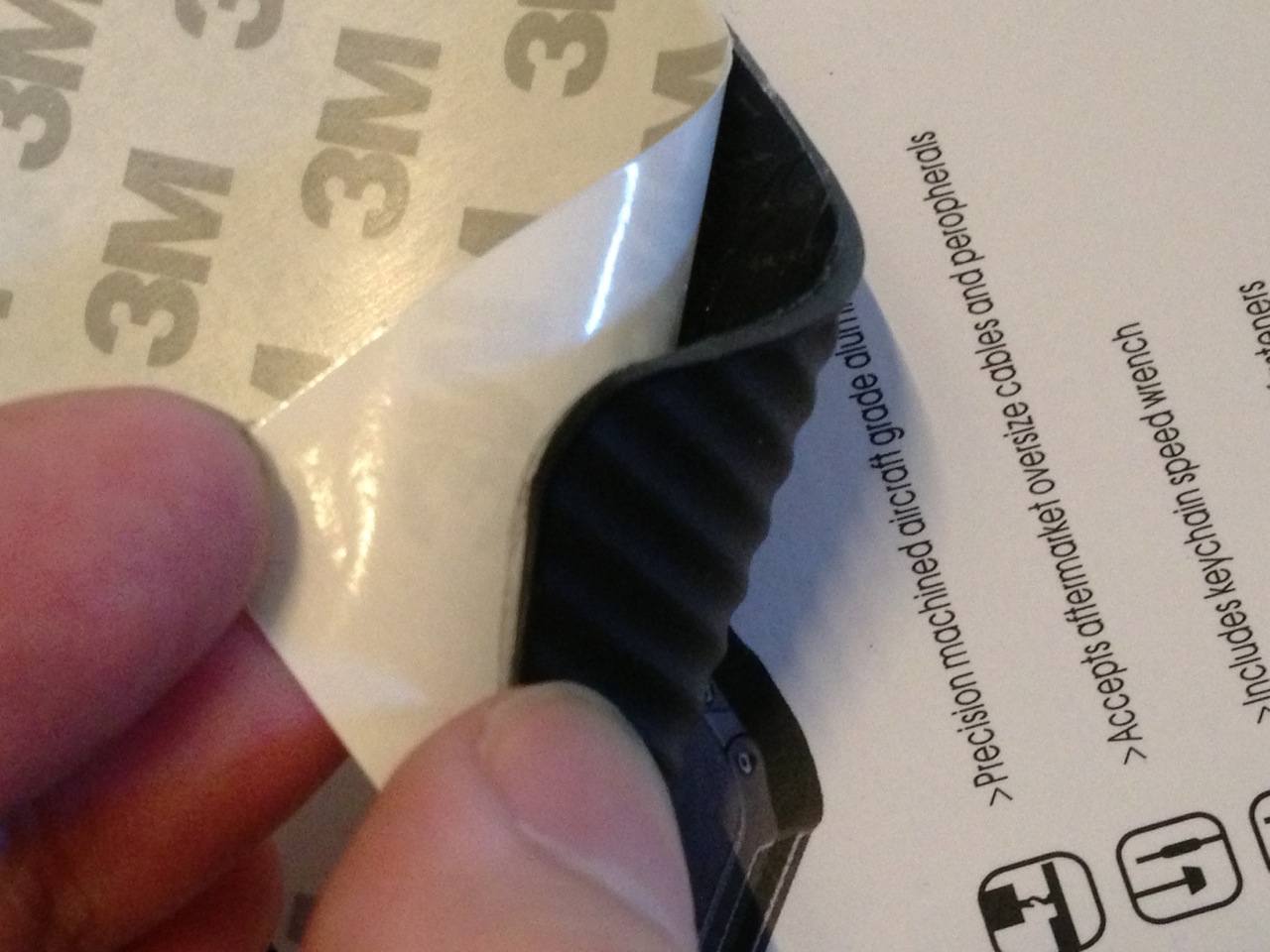

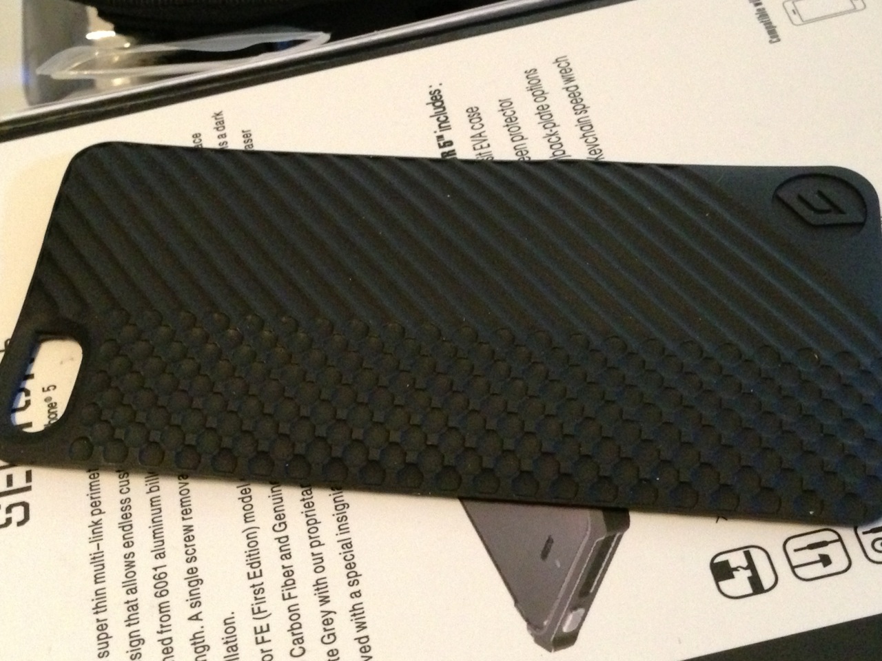

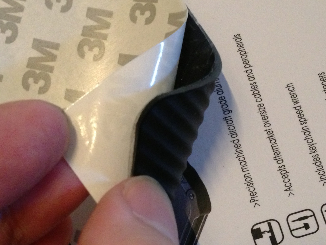

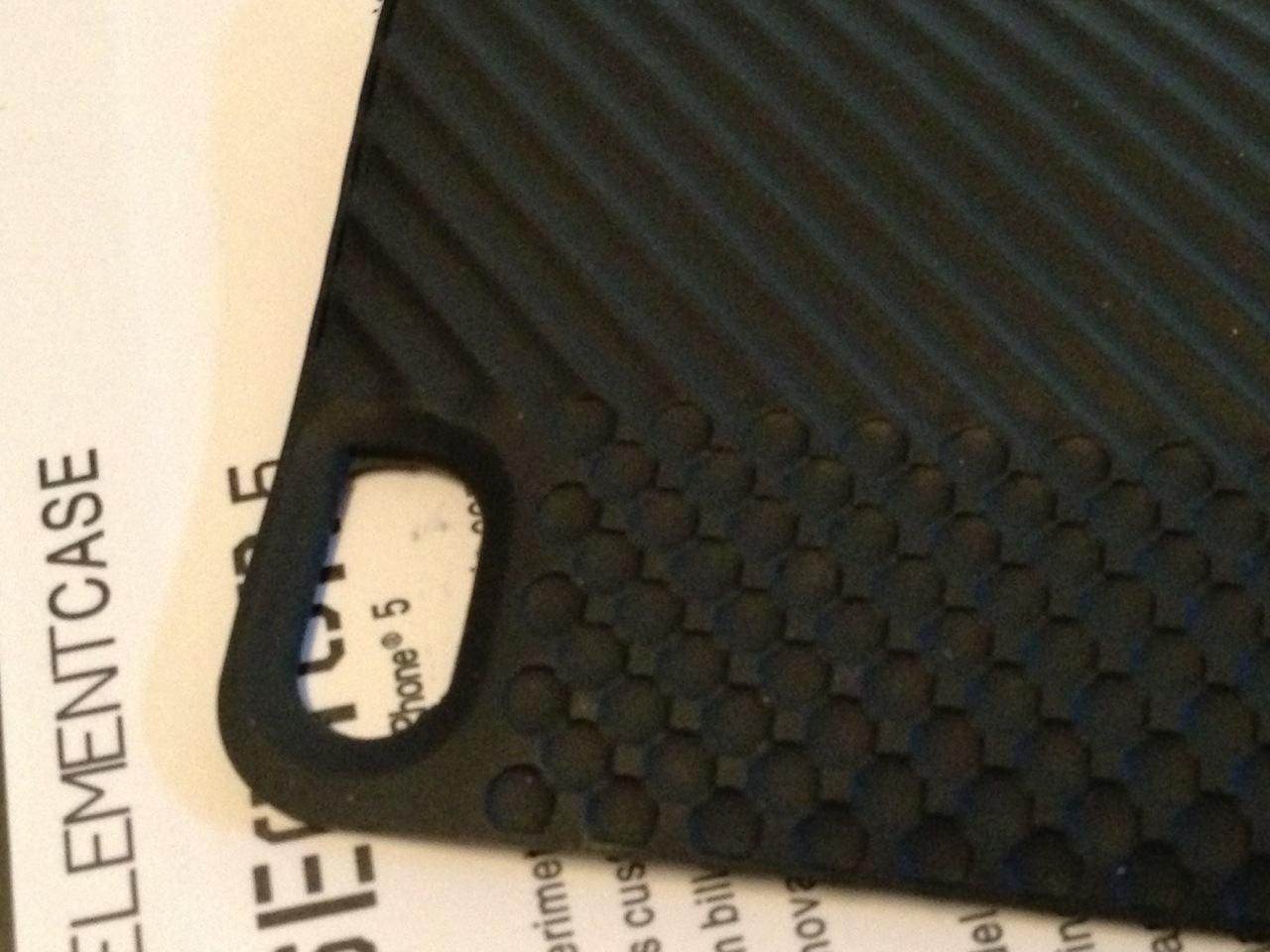

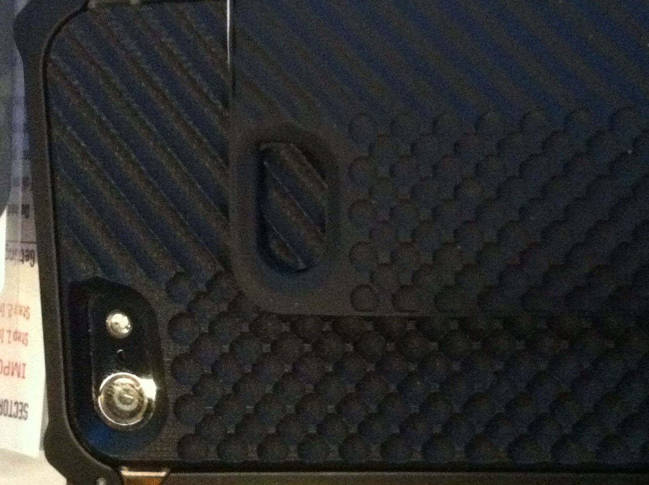

The "Backplate" is a cast rubber piece with an adhesive backing.
It's quite soft and rubbery. The pattern is similar to the real thing, but is nowhere near as 3D. The size of the rubber piece is slightly undersized, probably due to shrinkage after molding. The adhesive backing seems like it would peel away from the rubber easily, and you can see the thickness of it in the shot with the rubber flexed.

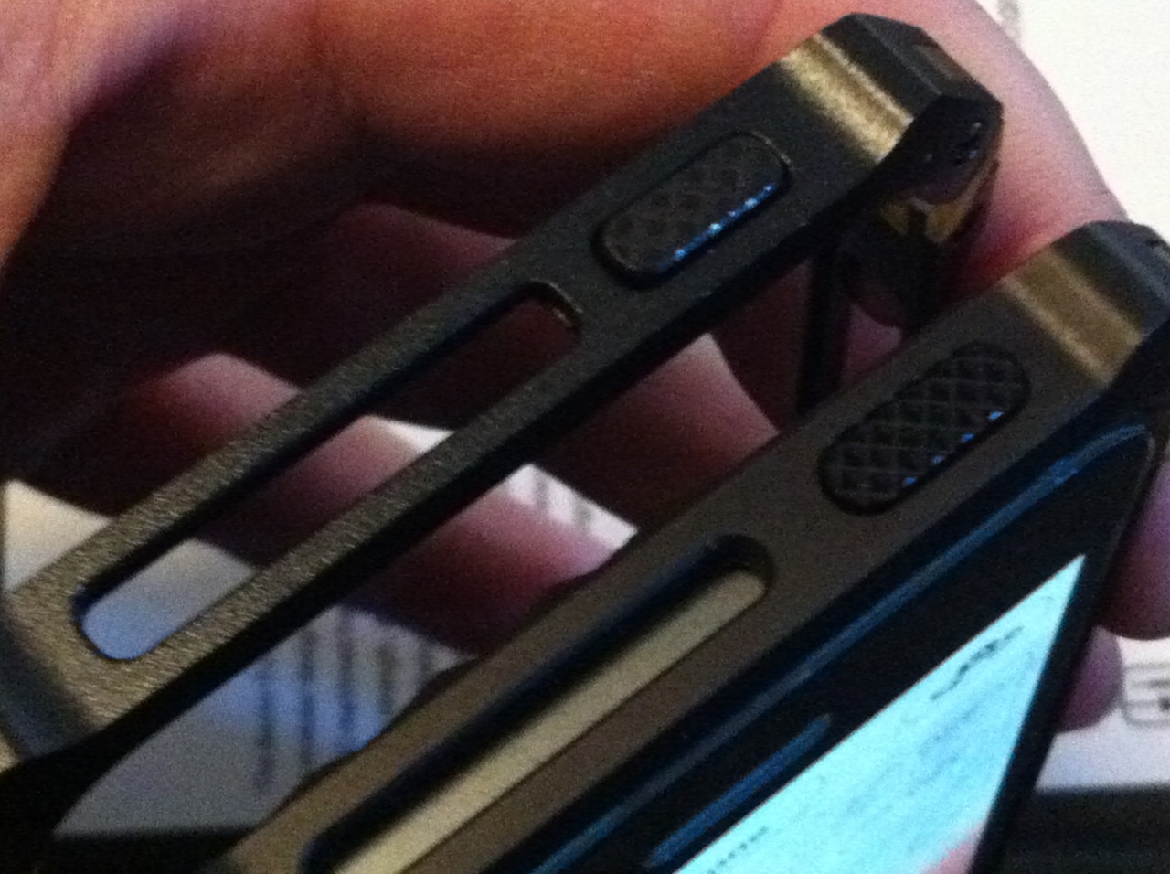

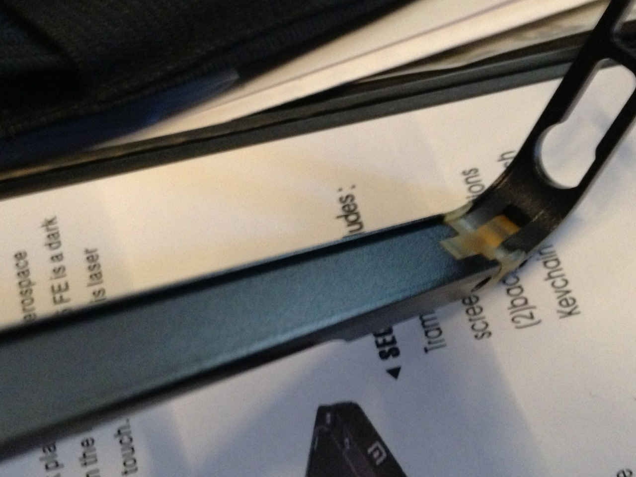

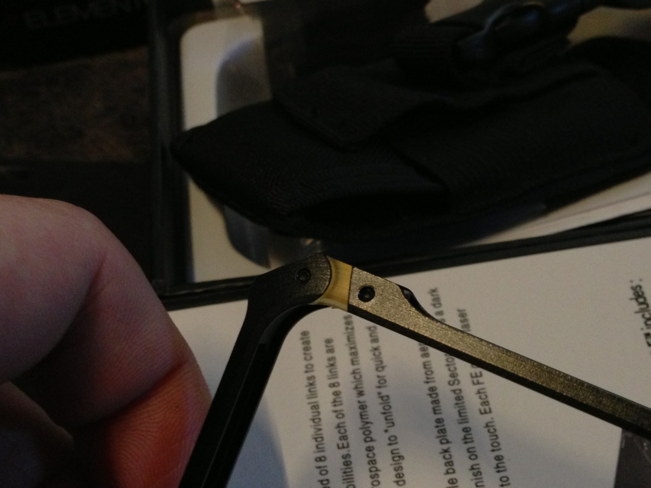

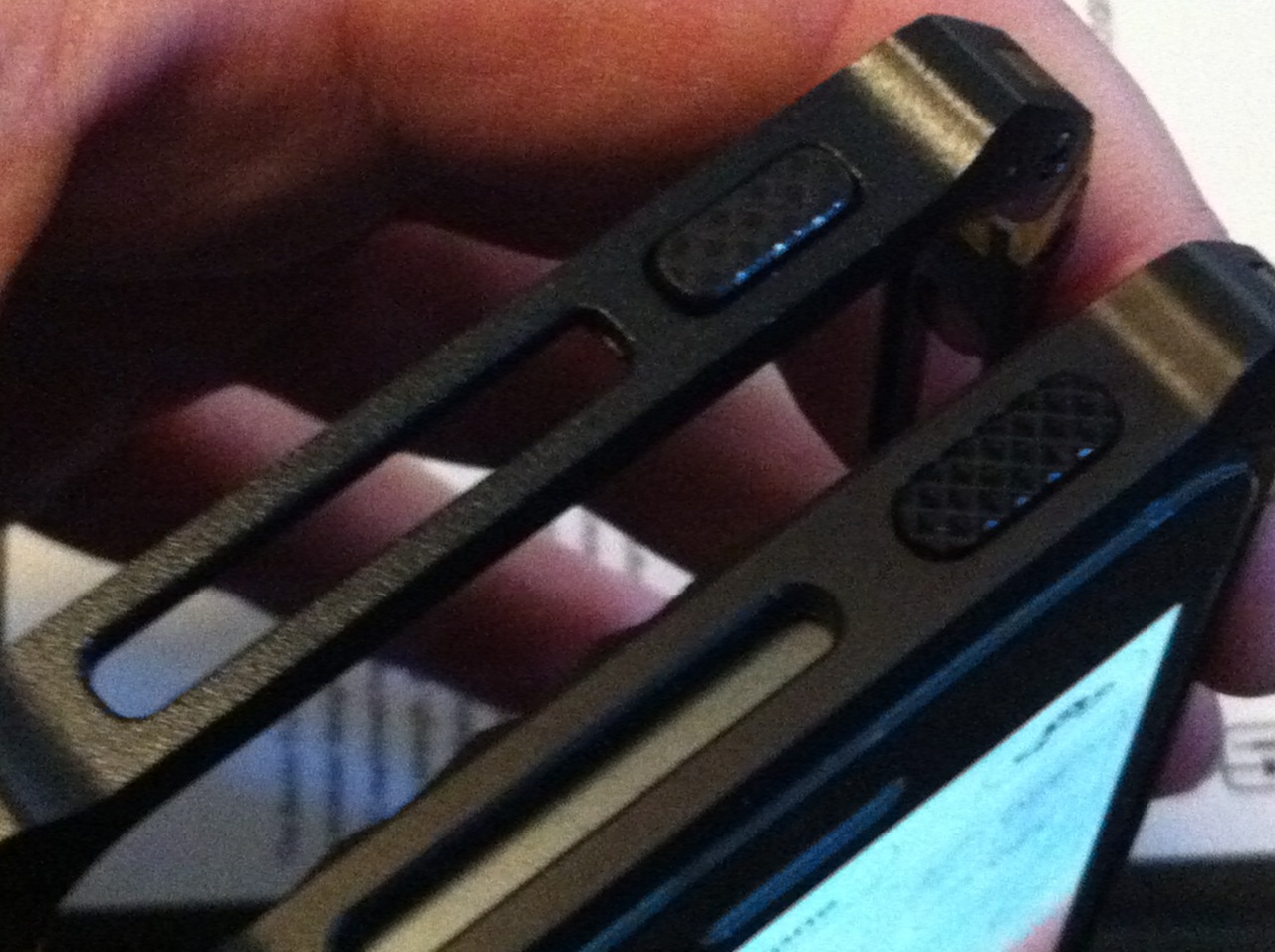

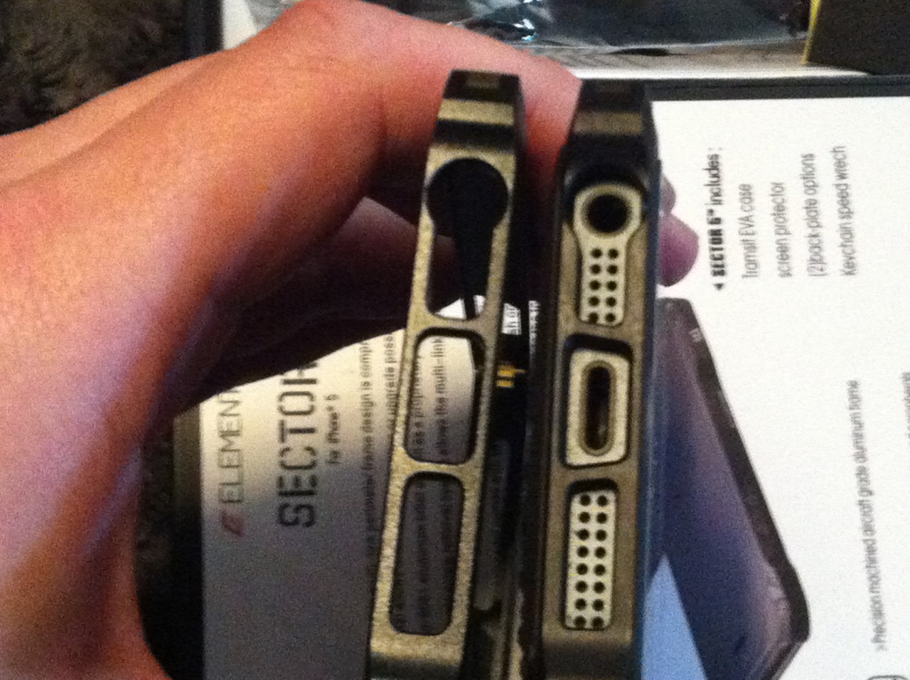

Here you can see the real and the fake side by side and compare the finish.
The fake here is clearly painted, not anodized. The button is lightly etched instead of machine knurled. There are definite variances in the sizing of the holes and the plastic spacers.
The last photo shows the difference in texture and design between the real and fake backplates. The real back plate is a stiff piece of 3d machined composite, and it feels completely different.
