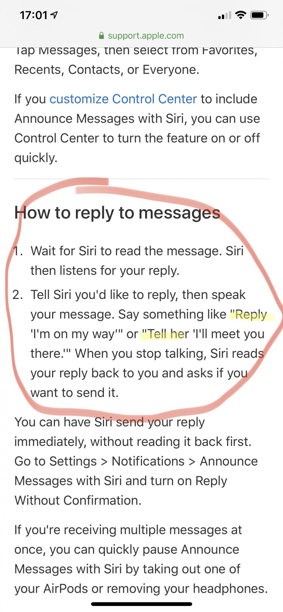

Works a charm for incoming messages but how do you reply? Apple Support says to say, “Reply [speak your reply]“ after the message is read. I’m getting crickets when I try this. I also tried pausing after “Reply” and still nothing. Is this a bug or am I holding it wrong? Any advice would be great, thanks.
It’s also freezing my Siri for a few minutes thereafter so I physically have to pull out my phone to reply. Can’t even use the “Hey Siri” command to reply. Broken.

Thanks for the tip. I’ll give this a shot. Glad somebody got it to work which means there’s hope. Thought I tried it immediately but maybe not. I definitely used the “Reply” command first. Pretty sure I read that somewhere in my troubleshooting.

I just checked Apple Support. It does give a reference to using a command but it’s pretty vague.

So the demo AirPods at the Apple store also failed which led me to believe it was something with my phone. I went home and connected my AirPods to my wife’s iPhone and tested it. Sure enough I was able to reply to the announced messages. I went through both our phone’s settings with a fine tooth comb and found that when I toggled off “Type To Siri” under accessibly, which my wife already had off, I was able to reply to announced messages through my AirPods. Works great. Also want to include that if you find Siri to be too low while announcing messages, be sure to adjust the volume while Siri is speaking. I was able to increase it to painful levels lol.
