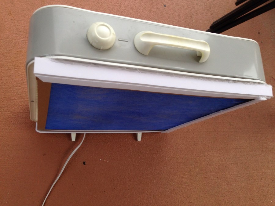

If there is room you can also get a 20" box fan that is available from just about anywhere as they are usually only like $20-30 and move a lot of air even on the lowest setting. Which in a closet should be quite. Just put it inside the closet. I have one for another computer area and I ended up attaching a 20" air conditioner filter to the back to use as a way to capture dust in the closet, helped a lot with the random dog hairs on the hard wood floors.
The rails to hold the filter are made from foam board from a hobby store and hot glue. If you cut one side of the paper on the foam board, the other side will act as a hinge. So that's how you can make L shapes.
