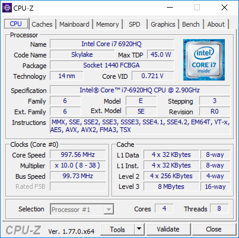

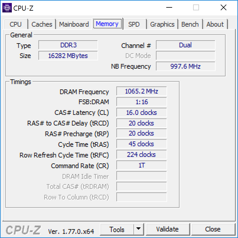

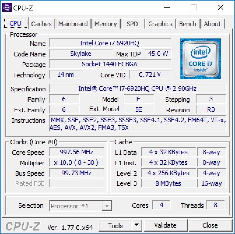

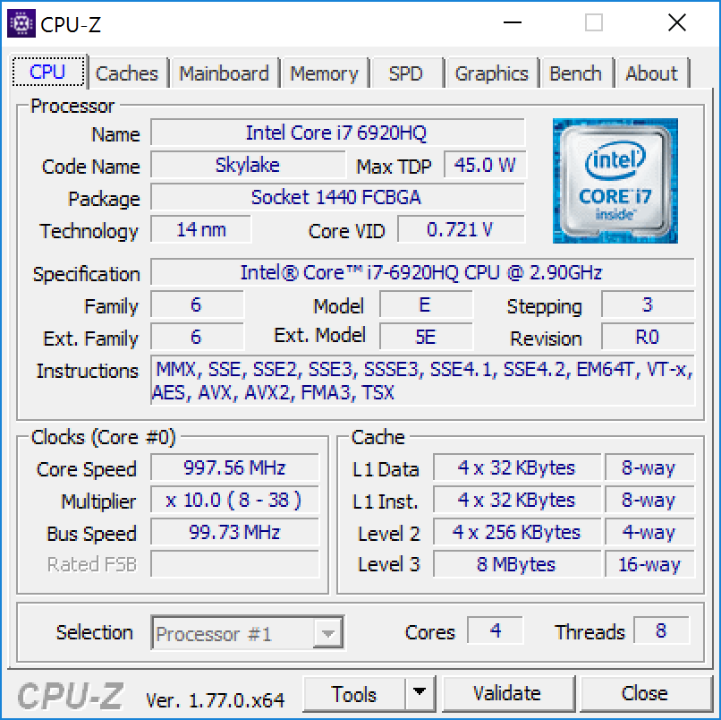

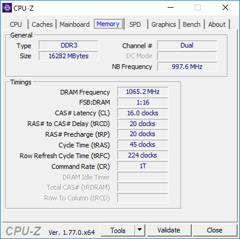

I ran MacCPUID on my 15" (6820HQ) and it doesn't show anything regarding RAM timings.

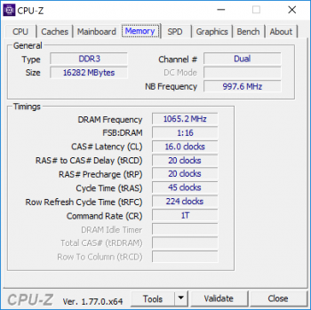

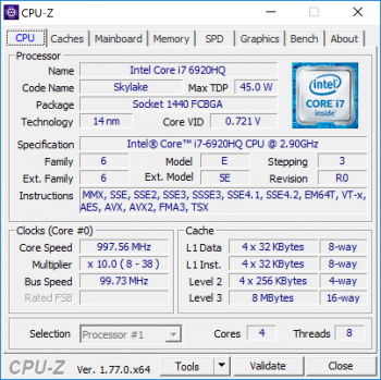

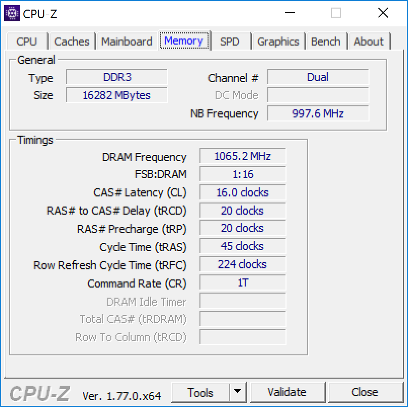

YOU ARE AWESOME! Thank you deadworlds! Now I am going to track down a 2015 benchmark and see if it lives upto what we think.

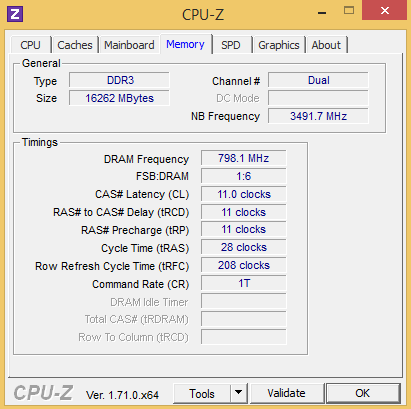

[doublepost=1479692807][/doublepost]Yep seems the 2015 has......
http://www.notebookcheck.info/Breve-Analise-do-Apple-MacBook-Pro-Retina-15-Meados-2015.144775.0.html
I see that the timing on the 2015 are tighter. However the 2016 RAM runs at a faster DRAM frequency, it is my understanding that the faster speed could offset the timing issues, but I'm no expert.
Thank you man! I have given you thanks in a new thread. I think this may have been the reason why, i've put forth my theory. https://forums.macrumors.com/thread...macbook-pro-2016-is-slower-than-2015.2016640/
And yes the higher Mhz should offset the slower timing but in this case it doesn't.
The 2016 ram is slower. The next Macbook pro will be much faster when they get a better match between CPU and Ram (and power requirements).
