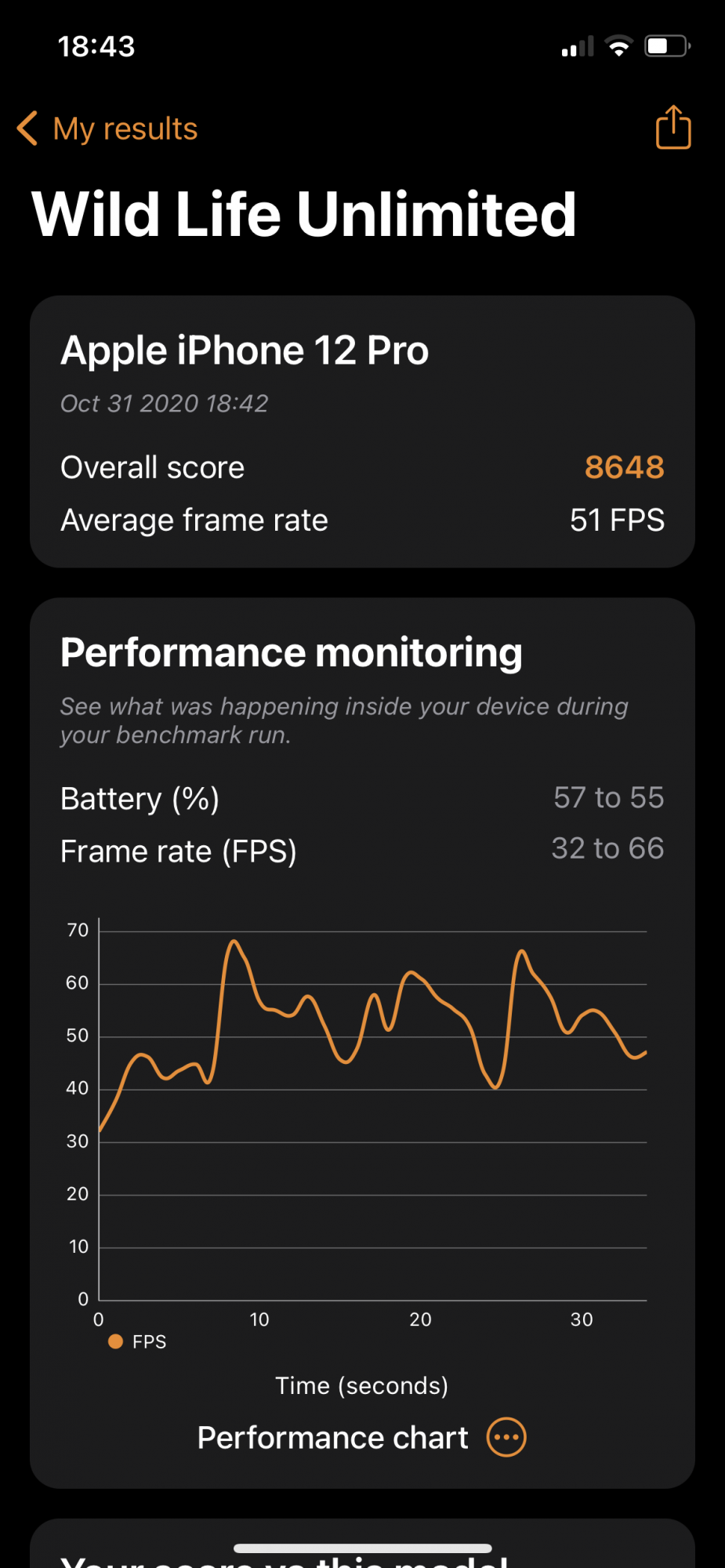

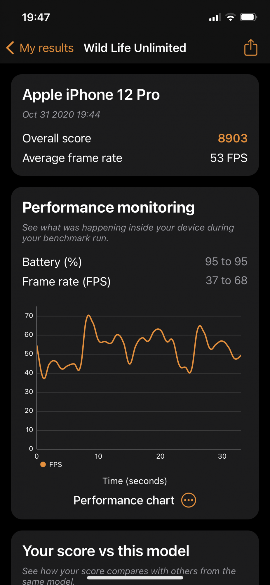

Not the stress test, but i am getting these results. Battery % does play quite a big role here

This could be some bug in the Metal driver of the A14.
🤷‍♂️ but the delta for 11 Pro Max is bigger in the result browser of the app. normal 7033 vs unlimited 7967. The difference is your link had a normal score of 7709, while about the same for unlimited.
