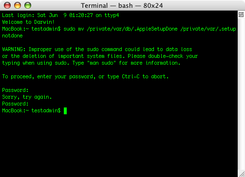

Open Terminal and type
sudo mv /private/var/db/.AppleSetupDone /private/var/db/.setupnotdone
The ".setupnotdone" portion can be whatever you want, really. "/private/var/db/" should be before it, though. It's best to keep it in the same directory for future reference. This will prompt you for your password, type it in and press enter. It shouldn't give you any messages, and you can now close Terminal. I attached a pic for reference -- I forgot the testadmin password, so that's why it prompted me twice. 🙄 You may or may not receive the "WARNING:", so thinking that you would, I created a new admin and ran it so you'd see the output verbatim.
There are a few caveats to this whole procedure. The most notable is that the account that you're using is still going to be listed in the Accounts preference pane. Which makes sense, and is also kinda helpful too, because it ensures that they have that backup admin account you were referring to.
EDIT: No, it will not hurt your current install. It will just prompt you to setup your network config (which will likely be autofilled now anyway) and create a user, which you can then delete from the Accounts portion of System Preferences. You'll also need to change the autologin setting back to whatever it was before running the wizard. You can even test it by enabling fast user switching or, if you have autologin disabled, logging out.
Do note that if you do it, you will have to run through the wizard as there's no real way to cancel the procedure. In fact, during testing, I had to run the wizard because I inadvertently locked myself out of single-user mode with the firmware password, and I didn't have my DVDs handy. 😉
