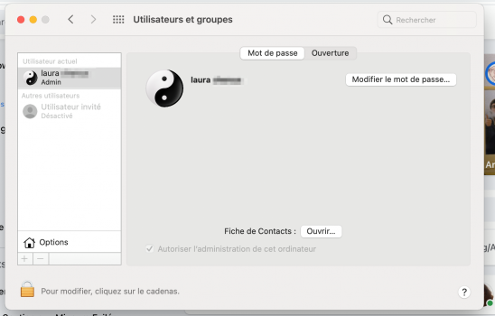

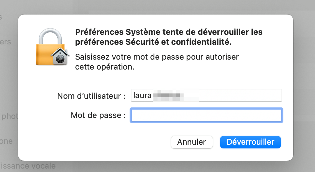

This is the account. `Laura` is the user and that's the account being asked for the admin password when for instance trying to modify the Accessibility settings
Thanks for the picture. It confirms everything you said. I like adreianlondon's idea about the keyboard.
