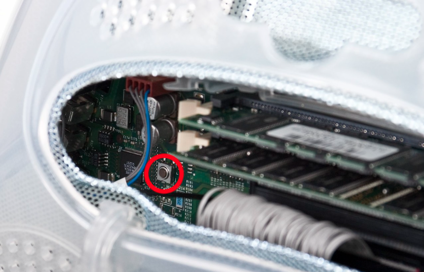

PMU reset on slot loading iMac DV+ (Summer 2000 model)

Problem is, I am having a very hard time finding the actual PMU reset button on the logic board. I do actually have access to that area, at a sideways-downward angle, thru the RAM access door, and can also get close enough to read the incredibly tiny letters and numbers next to each little thing on the logic board.

http://home.earthlink.net/%7estrahm_s/manuals.html and on page 196 of the pdf-manual (imac_DV.pdf) - I found a surprisingly indistinct picto-diagram of what the PMU reset button is supposed to look like -and- it does not provide an alphanumeric character corresponding to certain points on the logic board (as it does in other parts of this manual, when testing for 'trickle power', for example); It just points vaguely to a little dot on the board, while the text on page 197 says: "refer to diagram for location of button". (argh!!)
I truly cannot tell what I am supposed to push. Would anyone know the corresponding AN character on the board next to that specific button?

Here is the answer:
