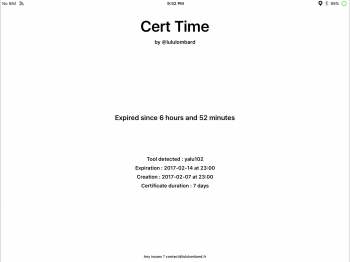

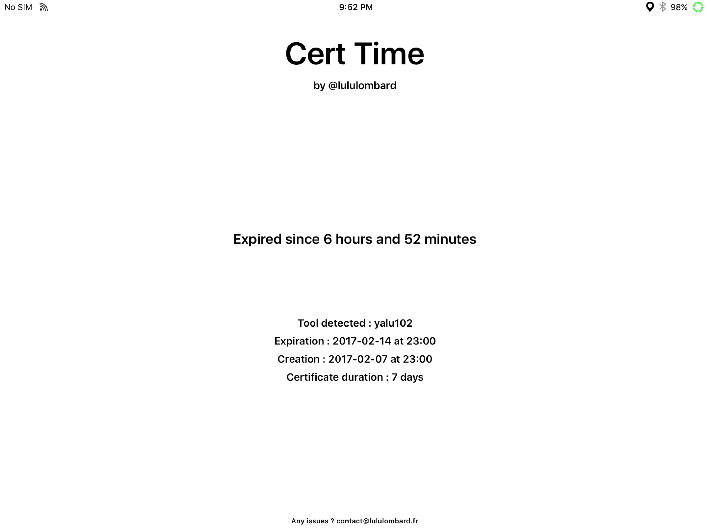

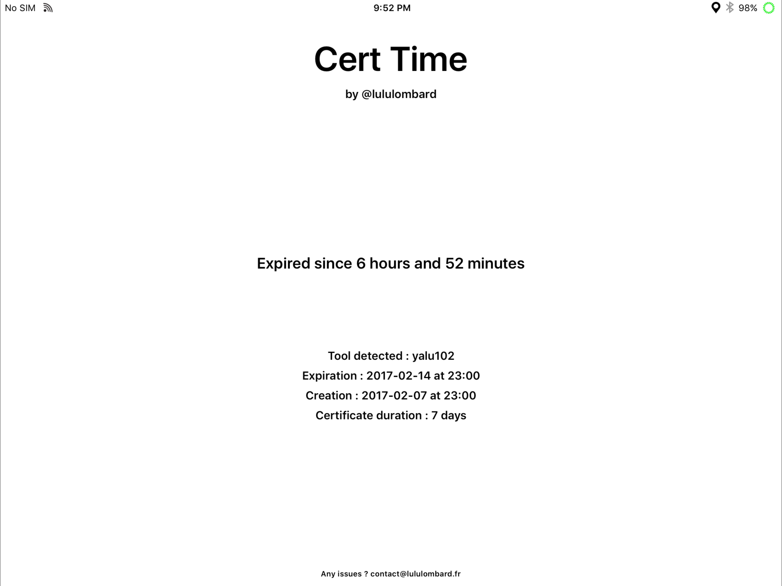

I downloaded the Cert Time app from Cydia and it says that my Yalu cert expired since 6 hours and 52 mins. This means I have to re-sign the yalu app again. However, since I have not rebooted my device and my phone is still jailbroken with Cydia and tweaks working, do I still have to re-sign the yalu app now or do it when I want to jailbreak again?
You'd only have to re-sign if you reboot or if your device reboots on its own. I picked a day when I always have access to my pc and I re-signed. Then I set a reminder to notify me every 7 days to re-sign. That way, I'm never at risk of losing my ability to stay jailbroken.
