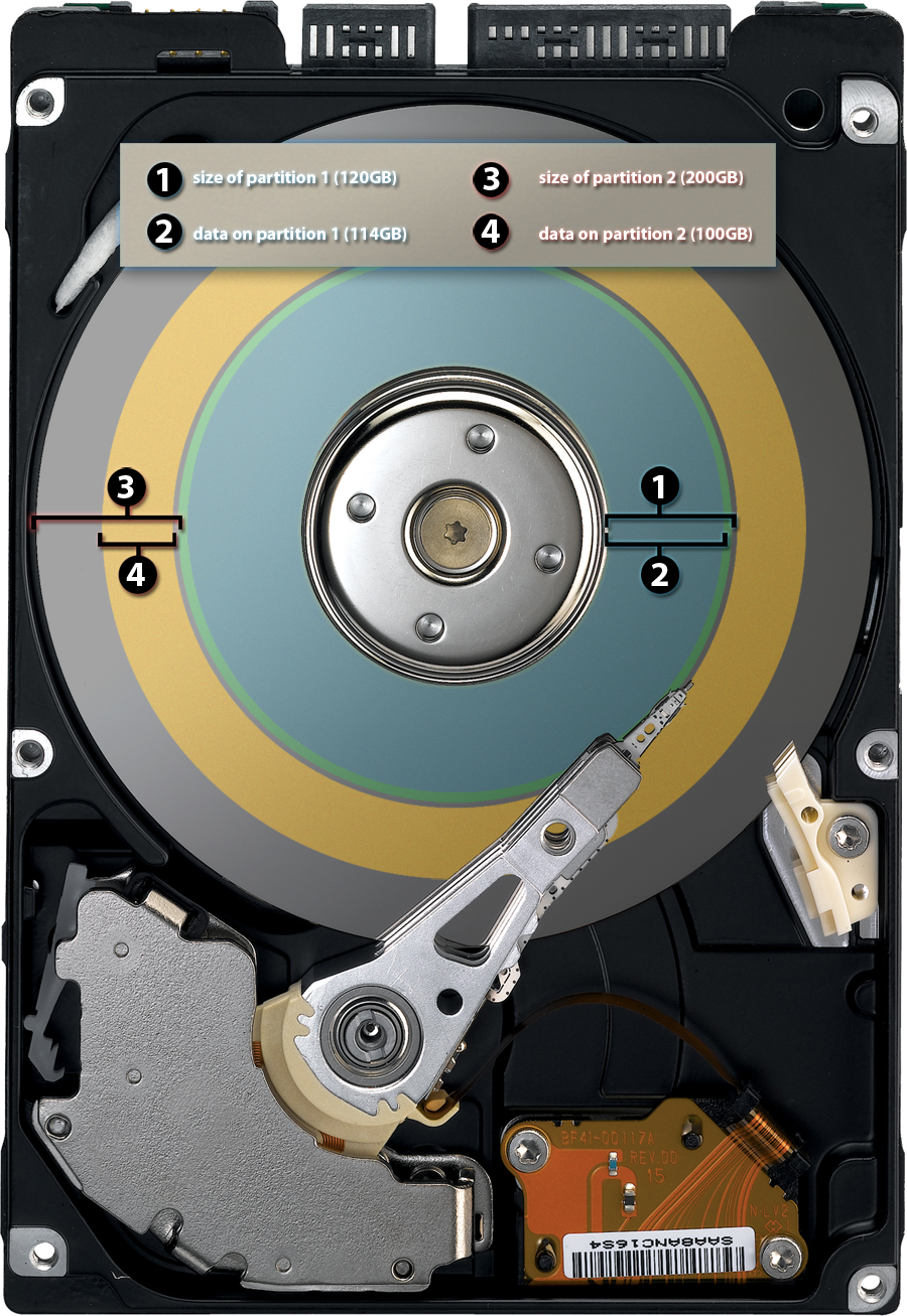

As you can see from the following image, partition 2 immediately starts where partition one ends, and if partition 2 has already half of its size taken by data, chances of that data being spread all over the partition 2 are quite normal, but the image shows the 100GB of data as one continuous block (for simplification). As that data on partition 2 is written onto the platter (the 320GB HDD will have two platters, each 160GB, but the same principle applies) right after partition 1 ends, one can not expand partition 1 any further, as with current mainstream file systems, partitions need to be continuous.

Does that mean, my post above is false? 😕
How can one resize partition 1, if partition 2 is starting right after partition 1 and if partition 2 has data on it, that s most likely written in the blocks right after partition 1 ends?
Because I once tried to repartition my Macintosh HD using the Restore DVD and Disk Utility (with Mac OS X 10.6) and it didn't work, as data was scattered across the platters.
Just like boot camp, if the data is fairly well scattered, then you cannot adjust the partition size, if however its compacted you can. I've done this a number of times successfully.
That's what I was getting at with my first reply and why I got confused by richthomas' post.
oh ok sorry, just got a bit confused. looks as tho you can only decrease the size of partition 1 (by 6 GB), which would allow partition 2 to increase by 6 GB.
so basically it means...its not really possible to do so easily
Yep. You have to copy/clone your data onto an external HDD and partition the internal HDD to your liking and copy/clone the data back.
As the blocks used for partition 2 are immediately beginning after the blocks of partition 1, and the blocks for partition 2 have already been used, partition 1 can't be expanded.
