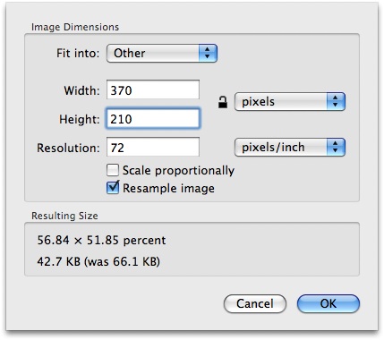

hi emma, i will elaborate more 🙂
untick "keep in proportion" so that you can choose custom sizes. yes - please use "px", this does = pixels. see the attached image, you should mirror it exactly to achieve what you want to get.
Do I change the 300 pixels/inch or leave as is? Other photos come out at 72 pixels/inch....... it is never the same......
this number depends what the original image is. this setting is known as DPI (dots per inch) - it basically means how many dots on inch there are in an image. higher will obviously have better looking images. 72DPI is fine for online content, where will the content be used? i recommend sticking to 72DPI.

hi,
thank you so much for your reply..
the content is for a website, photographs of hotels.... the web guys said that they had set it so that whatever the size of the photo I put in the cms, it will come out on screen the correct size, but if I could scale the photos down the page would load quicker, so obviously I want to scale them down!
the photos that need to be 370/210 most come out as 72 dpi so I'll keep that as it is then.... but for the ones that come out as higher, should I lower it to 72 dpi?
the photos that need to be 156/113 come out at 304.8, 254, 300 etc etc, should I lower them down to 72 dpi? or leave them as is?
I received the photos from each hotel individually, I was told to request high resolution and most are....... should I assume that the dpi is different because each photo is different? So therefore should I just be more concerned about the size that is needed and just keep the dpi as whatever it is?
am I making sense? 😕

so when I am resizing images using preview as my web guys said to;
I choose the appropriate size i.e. 370px width /210px height, uncheck 'scale proportionally' (otherwise it doesn't let me change it), leave 'resample image' checked and just go with whatever resolution (ppi) appears, whether it be 304.8, 254 or 72 etc!
So this process is correct? and one that is 304.8 will not make the page load any slower than one that is 72? Sorry to be thick but am a bit new to this!

Hm, you said the image proportions need to be changed to? That makes it a bit more complicated, unfortunately. If you just resize the image and change proportions, the image will be squished or stretched. You can try it out to see the effect (but don't save 😉 ). You'll probably need to crop the image to the required dimensions before resizing it in order to not stretch it.
Other than that, the process is right. DPI has no influence on how fast the page loads since it's only about pixels and an image at 100x200 with a DPI of 72 only has 100x200=20 000 pixels, just like an image at 100x200 with a DPI of 300 only has 100x200=20 000 pixels.
