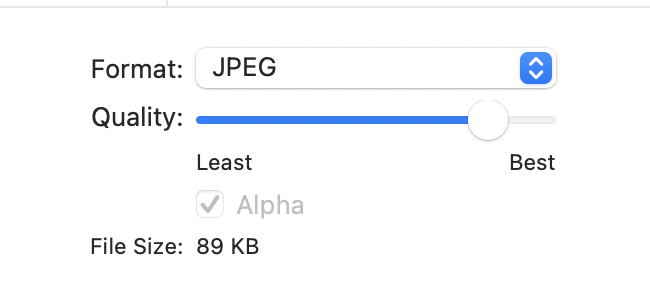

Are we talking about exporting pictures as jpegs, like this? That works for me (Big Sur 11.4), both the GUI and the exported images.
Are you exporting from jpeg to jpeg? and lowering the quality and the file size of the new jpeg is smaller than the original?
