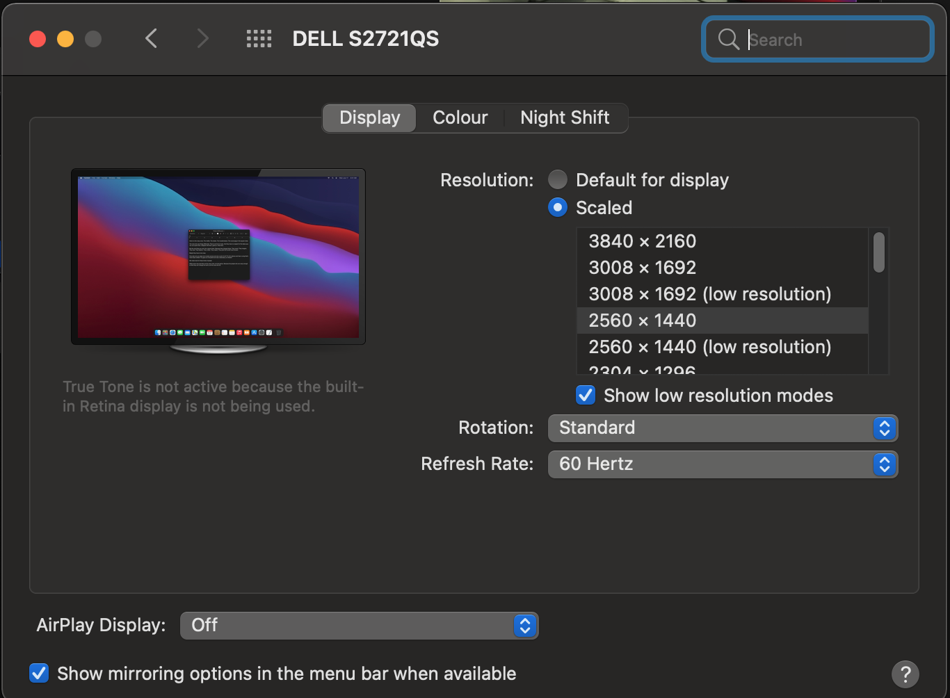

Hi all, just to shared. I think i found the issue. It's something to do with refresh rate. I have 2 USB-C hub. Realise Aukey only support max of 30Hz refresh rate on display, if I switched to another brand (Ugreen), support 60hz refresh rate on display, there is no mouse lag/latency issue.
I switched to 30hz on Ugreen, the mouse lag/lantency happened again.
Consider changing your refresh rate and see whether the problem still persist.
Btw, I use Bluetooth mouse or wired mouse giving me same issue when it's on 30Hz. Hence it's not related to wireless / wired mouse 🙂
