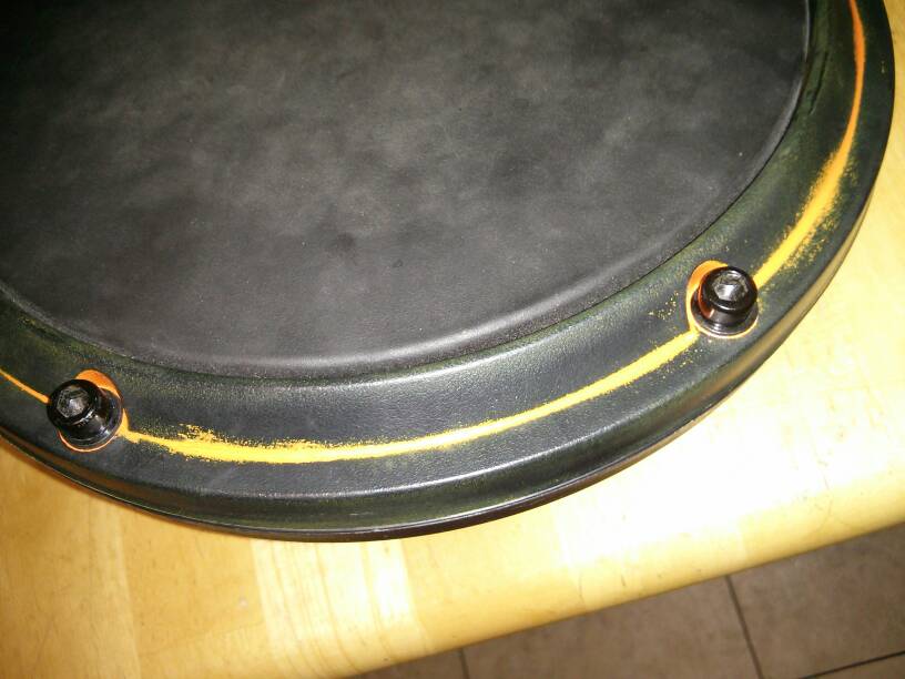

I got this paint stuck on some plastic electronic drum rims. They're ABS plastic and its just orange spray paint. I removed the rest with nail polish remover, but i need to get it all off! Help!

I would have worried about the nail polish remover damaging the plastic, but I guess it didn't. How about dipping a q-tip in some of the solvent and rubbing it out with that?
Its strong plastic without any clear coat or anything that would peel off so I guess nail polish remover couldn't defeat it. Them again neither could the bashing of my clumsy hands hitting it with drumsticks while missing the pad, but that's an issue for another day.
Tried q-tips, it didn't work. I also tried toilet bowl cleaner, glass clear, windex, pledge, dish soap, and boiling hot water. No idea what will work.
Maybe ill go out and get paint thinner
Scrub at it with an old tooth brush using the nail varnish remover?
Theres also a product called simple green thats generally safe with plastics. You can soak it in that then scrub off the paint. Test a bit on the plastic first to be safe tho
Ding ding ding!!! You win!!! The toothbrush cuter through the paint like butter. Looks good as new! Thanks!
