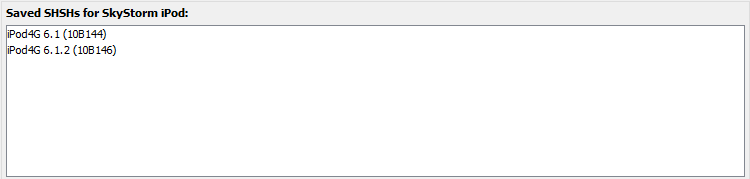

In TinyUmbrella, even though my iOS version is 6.1.5, why is TinyUmbrella saving blobs for 6.1.2
Because of that, I cannot stitch the blobs.

Is there any way I can downgrade to 6.1.3 without any errors?
If you have all the necessary stuff to do so
Did you download iFaith and check if you have proper blobs? If you don't know how to check, PM me your ECID and i can check for you (if you're okay with that)
No, the blobs I can get is for 6.1.5 (latest blobs), and 6.1, 6.1.2 (available on TSS Server), I can't get blobs for 6.1.3
That means you don't have blobs for 6.1.3; unfortunately, means you can't downgrade to 6.1.3
Your 6.1 and 6.1.2 blobs are most likely incomplete
