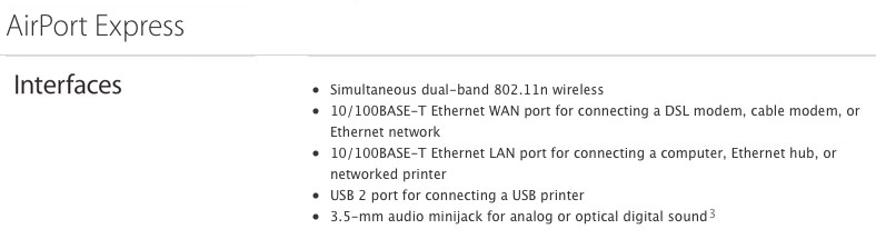

For network using cables, I personally won't recommend the Airport Express, it only has 100Mbps port, which may be good enough for a normal internet connection, but not that good for high speed internet connection or intranet.
Since you already have a 150mbps internet connection. Use Airport Express will limit your connection speed to 100Mbps, which is not ideal. The Airport Express may be good to work as a repeater wirelessly, but not that great with cable.
