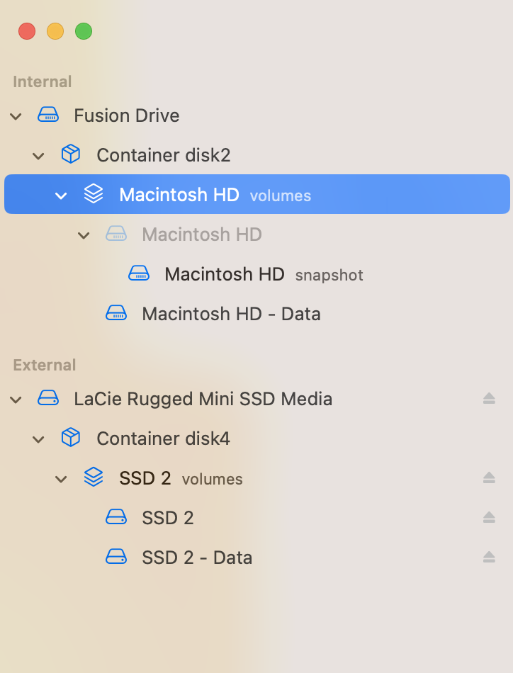

Hi there,
I have a 2017 iMac 27" with a 2T fusion drive and 40GB RAM. It was becoming slower and slower so I created a bootable SSD which I now use as my main drive and it's much faster with most things. I know it might be considered obsolete now but am waiting for M4 Macs.

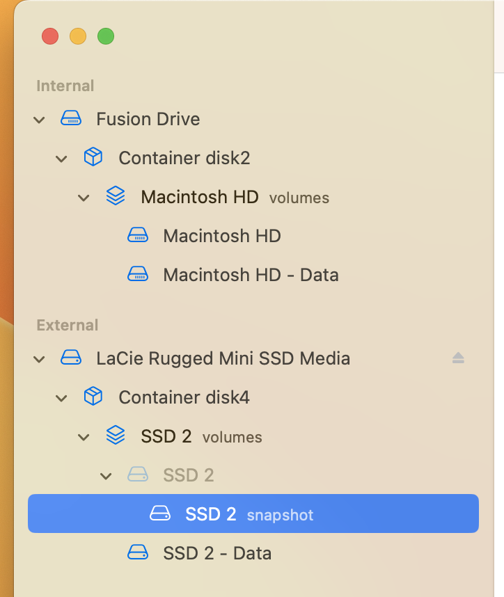

But although I can boot into the SSD when the computer is off using the option key to select it, whenever I do a restart the option to choose SSD is not present and despite selecting the SSD as the startup disc in settings, the restart always defaults to the native Macintosh HD. I've attached a screenshot of the discs from disk utility - have I managed to mess up the containers / volumes on the SSD? is there a simple solution?

1. What happens when you just do a normal cold start? If you have set the SSD as the startup disc, you should not need to Option boot from cold start and select the SSD.
2. Perhaps the SSD is disconnecting during a restart vs a shutdown/cold start. Can you see the SSD in disk utility after a re-start and it defaults to Macintosh HD?
A normal cold start booted straight into the external SSD this morning but any attempt to restart defaults to the MacHD (the SSD does not show as an option if I Option-Restart).
The SSD appears to be visible in disk utility after it boots from the HD - see attached.
And the SSD is selected as the start-up disc on both drives.
David

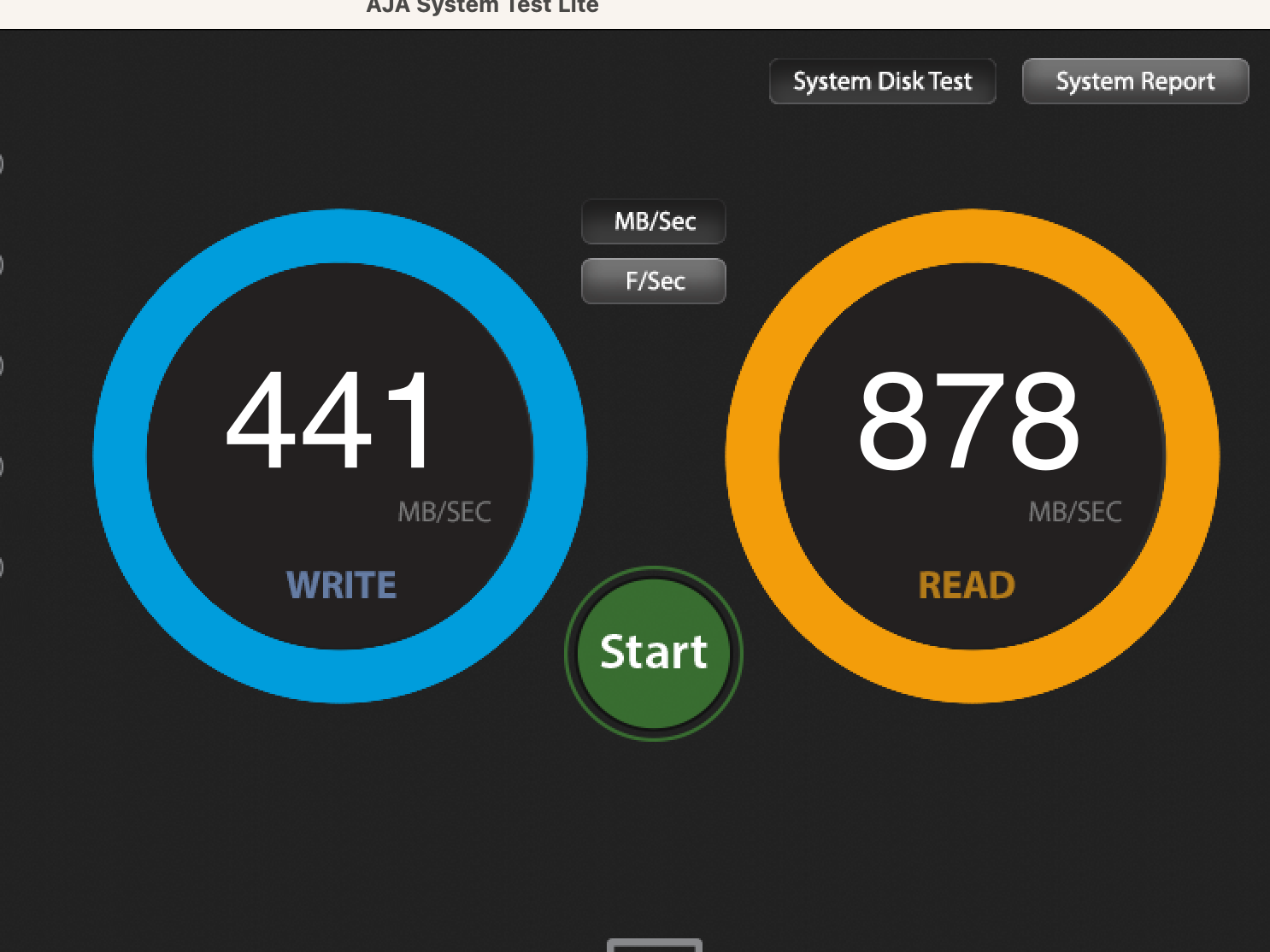

David, what kind of reads are you getting now, once booted up?
(I like "AJA system test lite" for this)
Reactions: pshufd
Thanks - the speeds I get are 800-900 read and 400-500 write depending on the simulated file size I put in - see attached/
The external SSD is a
LaCie Rugged Mini SSD 2TB​
But I'm not sure if a lower write speed compared to the read speed is expected. If not then it might be helped by a powered hub
