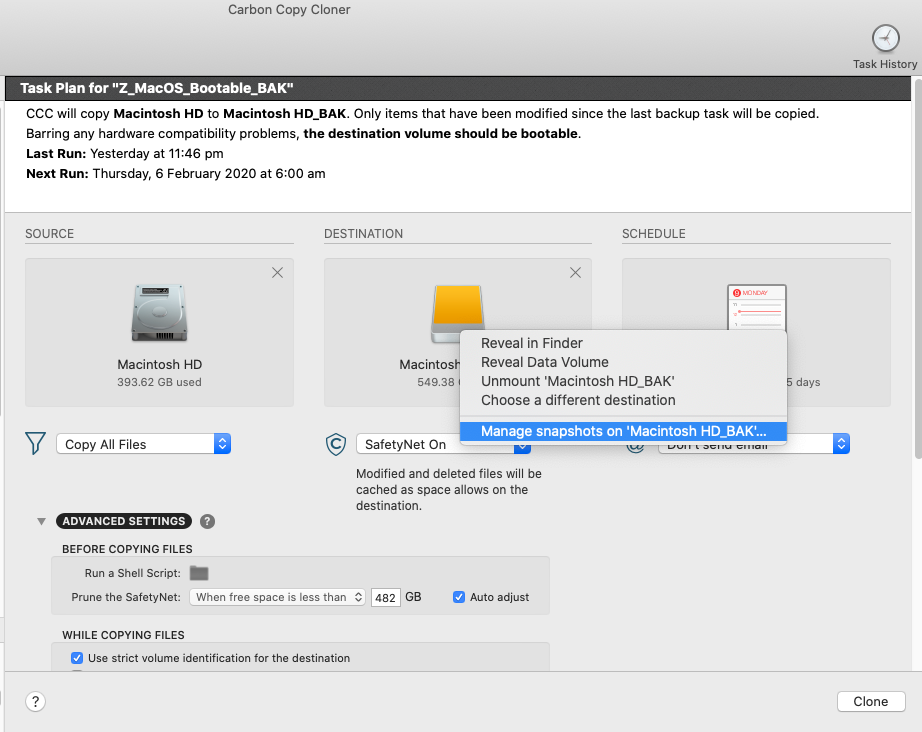

Because I turn on CCC Snapshot and SafetyNet, I clicked the Manage Snapshot I can see there are snapshots on it.
Is that means I can restore from any of those CCC snapshots to the Internal drive when things happen?

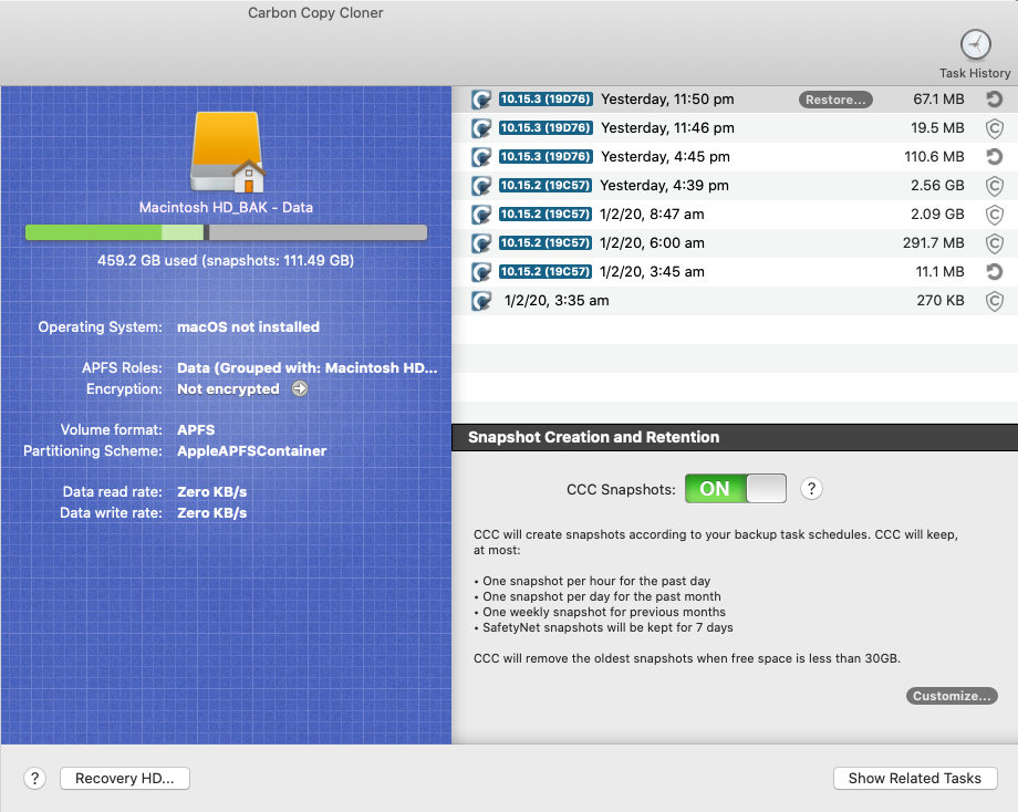

screen-shot-2020-02-03-at-12-01-38-am-png.891978

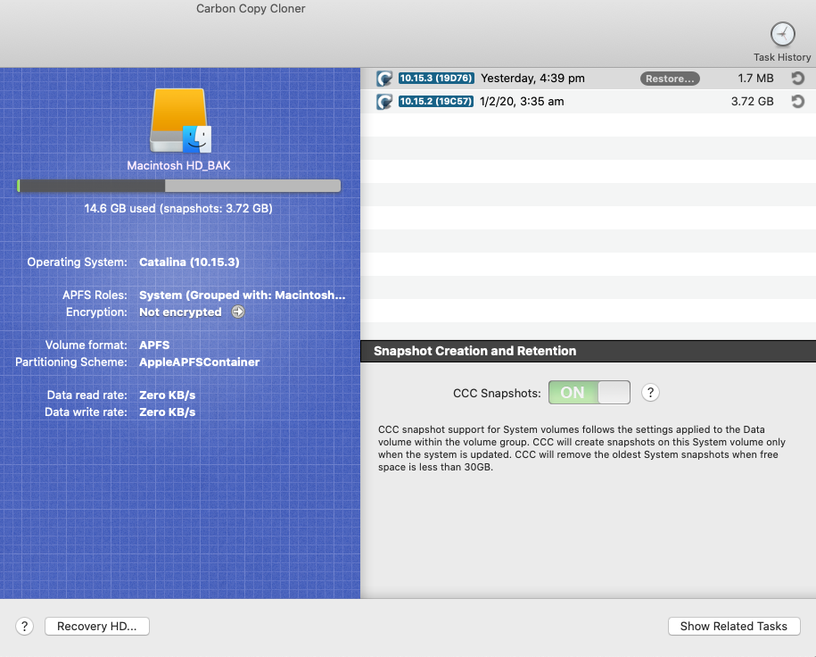

Every time I back up, “Macintosh HD - Data” will have a CCC snapshot, but on “Macintosh HD”, not every backup has a snapshot.

screen-shot-2020-02-03-at-12-01-26-am-png.891977
For example, If I have done the 1st backup at 1 am, the 2nd backup at 2 am, the 3rd back up at 3 am
On “Macintosh HD - Data” will have all 3 CCC snapshots backups, but on “Macintosh HD” only have 1st and 2nd backup but no 3 am backup. (maybe there is no change from 2-3 am?)

As for the discrepancy between the snapshot times for the OS disk and the Data disk, I think that is because the OS disk is separated from user data, so if there have been no system changes, there would not be a backup. That is just my guess.
