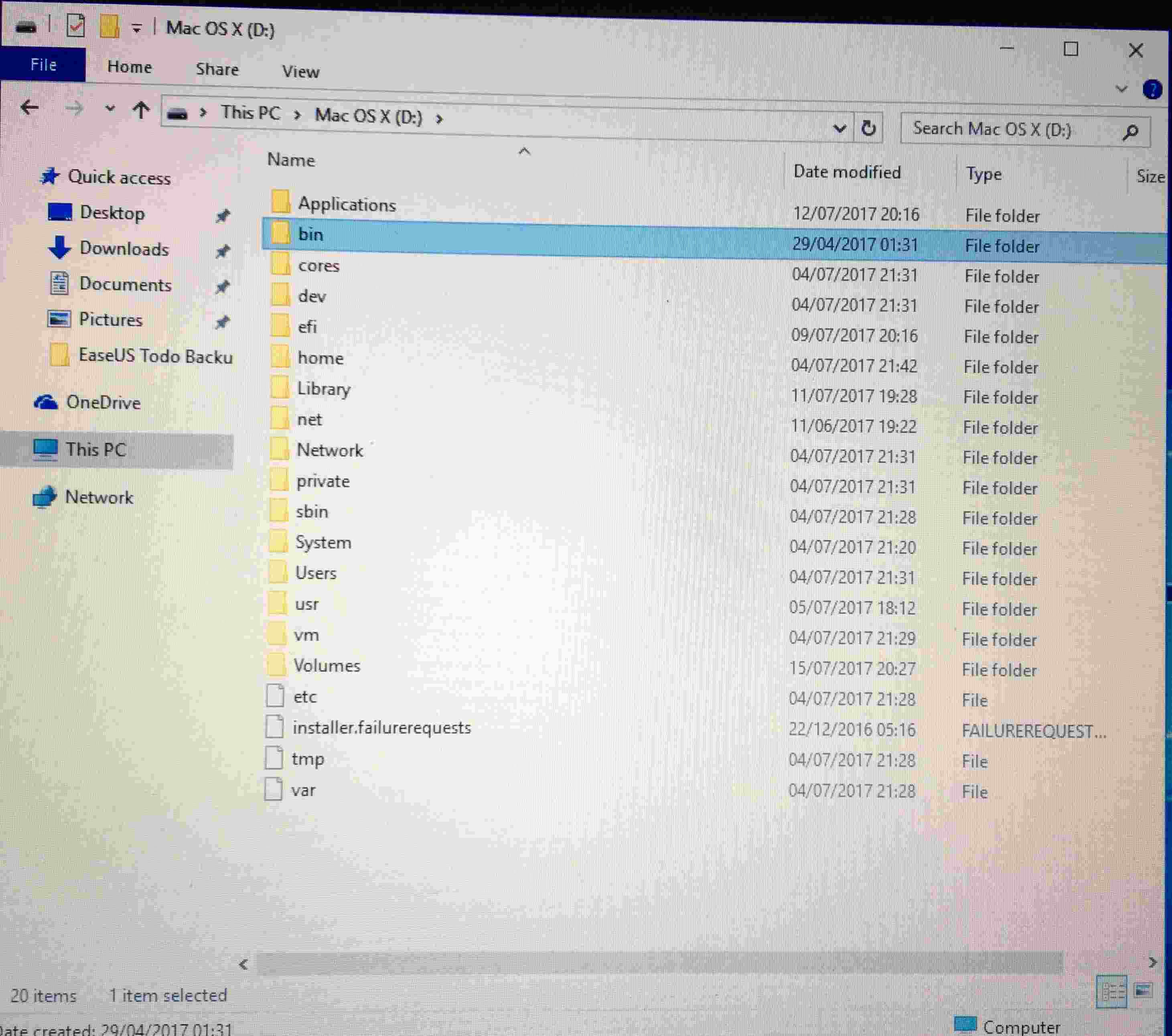

EasyUS disk manager in windows shows me the Mac OS X as an Unknown FAT 32 partitions with the added letter D. I am able to see and copy all files and folders somewhere else.

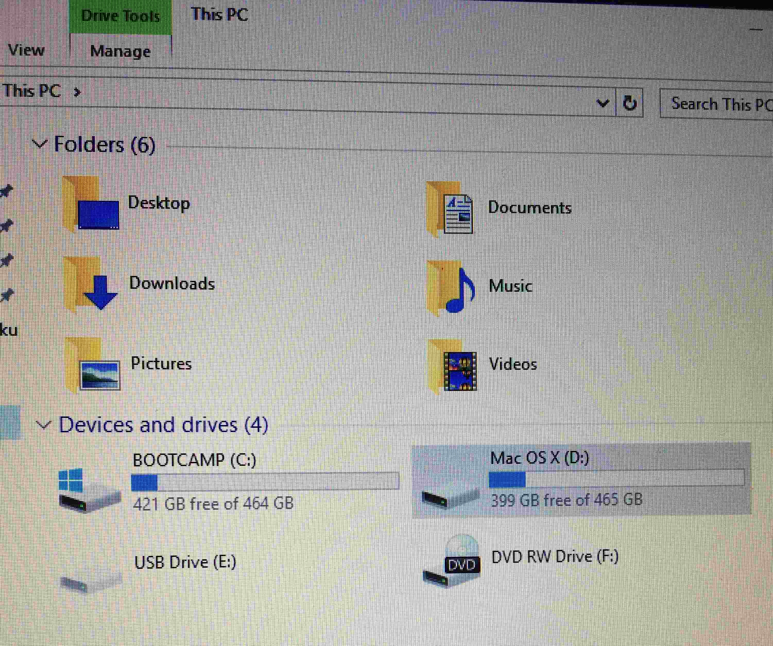

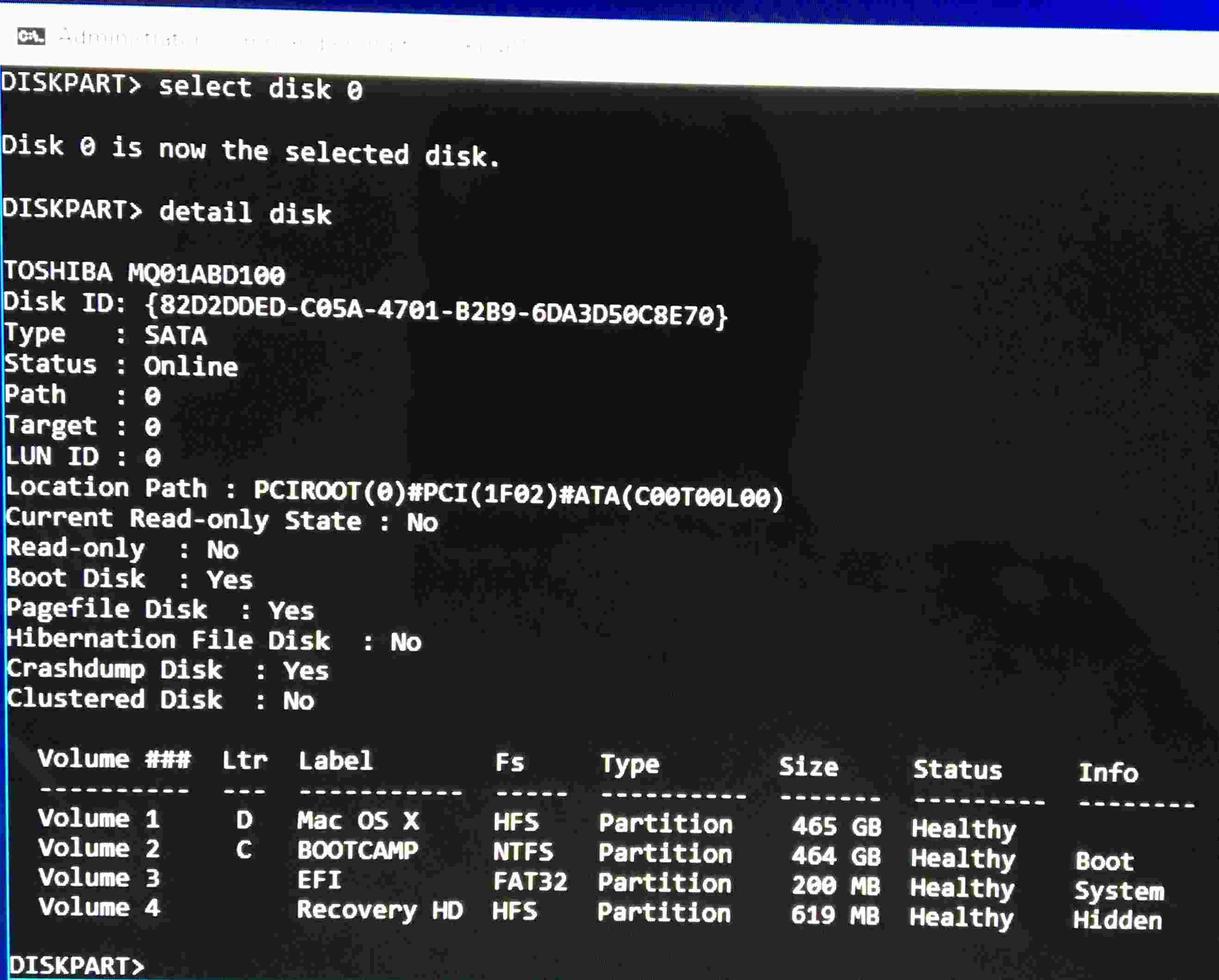

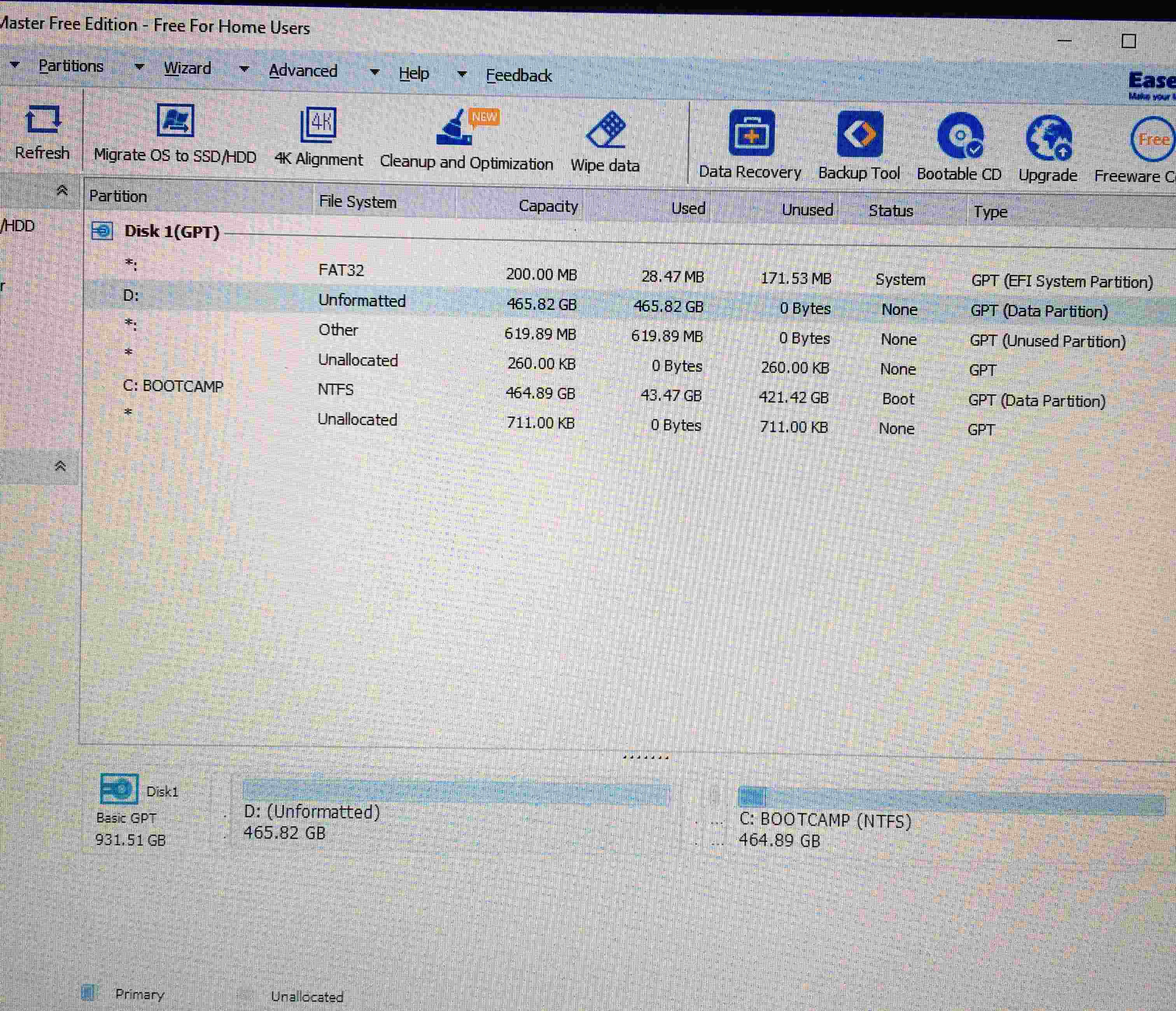

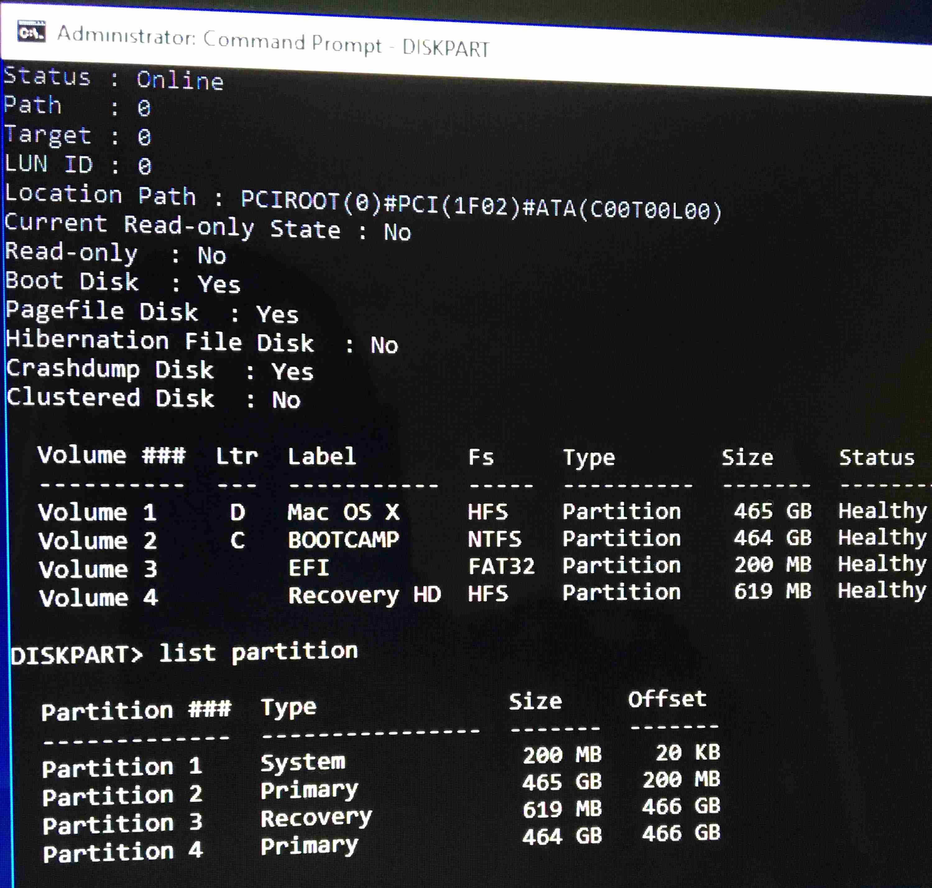

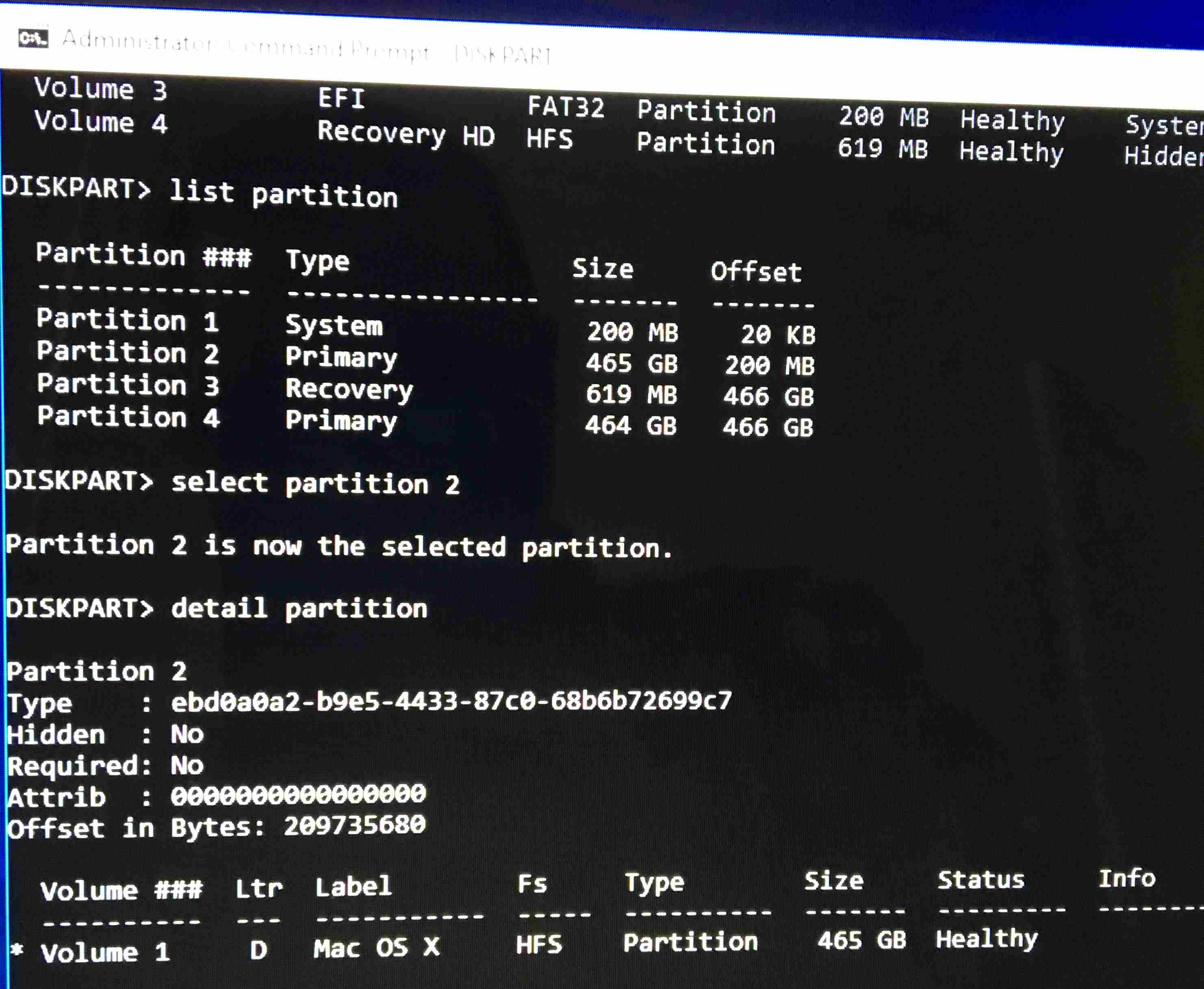

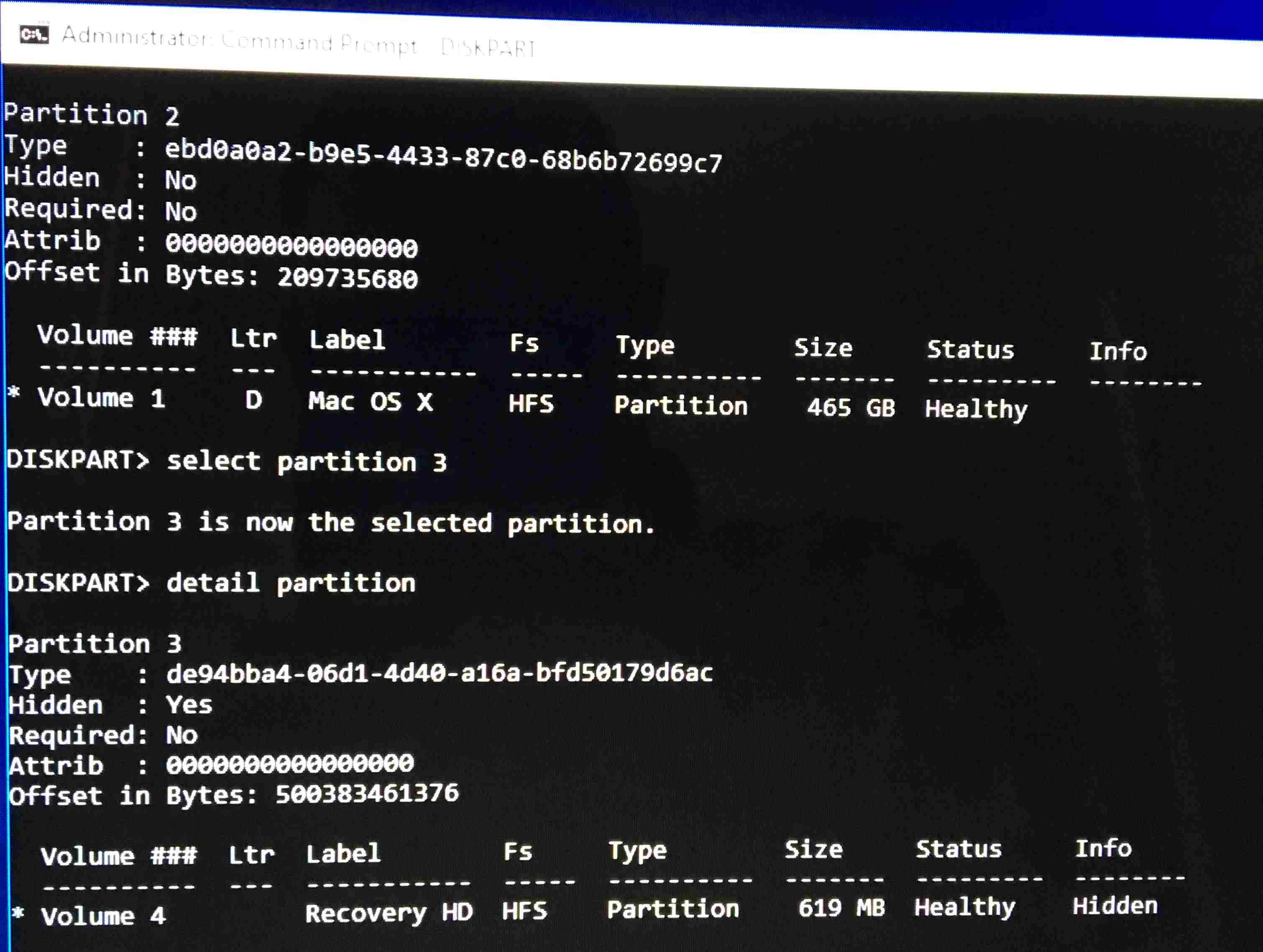

I was not able to use Terminal or use command + r when the Mac starts, but I used DISKPART in windows so I can provide more pictures.The first picture shows that I can copy and paste files and folders from the partition where should be Mac os. Takes one day to copy the data to external HDD.
Caveat - I'm not familiar with the output from the programs you've used. But from what I can see on the screenshots you've posted, your disk is GPT (so my assumption about it changing to MBR was not correct). You have a HFS partition "Mac OS X" which reports as healthy and from which you can read/write files (correct?).
The FAT32 EFI partition is normal.
So it looks like your major issue is that you can't boot into the "Mac OS X" partition. If that is the case, you may be able to fix it as follows: Can you boot into the recovery partition? If so, you can run the Terminal app. The following explains how to do it:

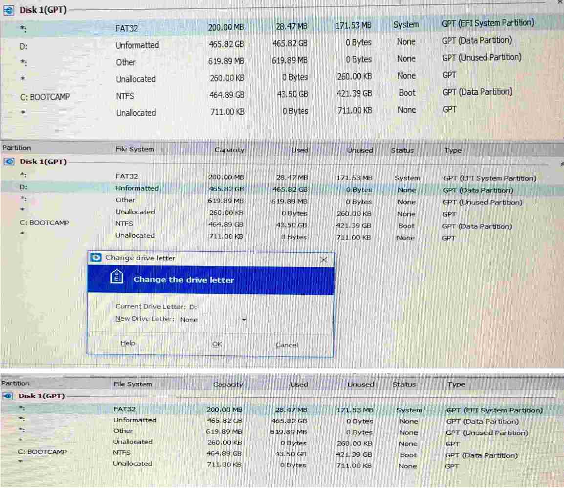

At the moment I have no access to recovery mode (command + r). Because of that, I will try to take off the letter D and try again.

Don't worry about it Mac partition appearing as the "D:" drive. If you try to change it, it may make things worse. Just try and see if you can boot from it either through Internet recovery or booting from the recovery partition (per the instructions in post #6) and run the commands in post #4.
Thank you for your post. I already took the letter D before I saw your post. Then I used PRAM multiple times.
The result is that I can use the Recovery mode again and I have my Mac OS X on the menu again.

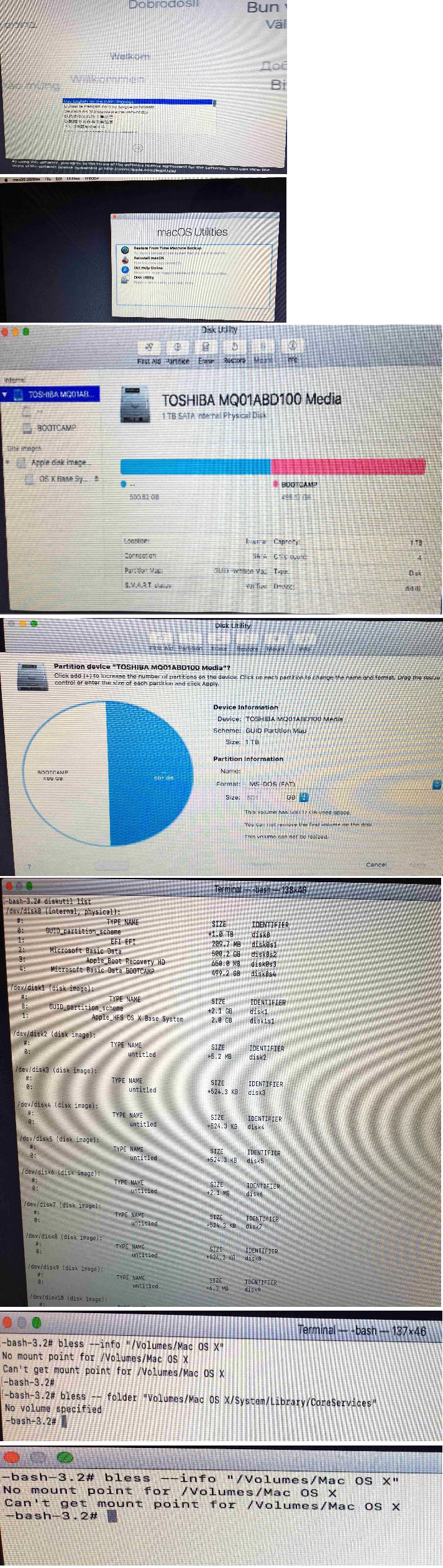

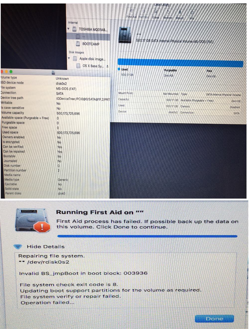

Unfortunately, when I select the Mac OS X the system doesn't boot(see picture below).
The disk utility doesn't know the name of the partition where the Mac should be and also saw the partition as MS-DOS(FAT) (see picture below).
So what to do next? Is it any chance to keep all files and folders without losing it that I previously backup to external HDD? There is some Apple disk image (see picture below), but I have no idea how that works.

I don't know what happened because in the screenshot where you show a choice of "Mac OS X" and "EFI Boot" and the later screenshots, the partition has lost it's name so now its "" (empty). The partition type is also "Microsoft Basic Data" which is not correct - it should be "Apple_HFS".
You have the following choices:
1) Try to fix whatever problem you're having. Based on what I seen on the Internet, I wouldn't try to fix it. It seems that nobody who has the "Invalid BS_jmpBoot" problem was able to easily fix it. Also, if data was written to the partition after it changed from "Apple_HFS" to "Microsoft Basic Data" then you've likely lost the directory/file tables.
2) Clone back what you have from your external disk to your internal disk. The white-on-back screenshots you have in post #3 shows your disk in a better state than your screenshots in post #8. It also sounds like you did some work on the disk after you did your last clone. Once you clone operation is complete, you can try again.
3) Work on your clone disk. To save some time, you can work directly on your external HDD. The point of this is to see if what's on the external HDD is OK before doing the clone operation. This is more risky but if your external HDD is not in a good state, you would have spent quite a bit of time to re-clone the disk. If you chose to do this, there are some tips I can offer.
4) Start from scratch, partition the disk the way you want it from the start, reinstall the macOS and Windows and then copy the data from the external HDD to the internal HDD.
