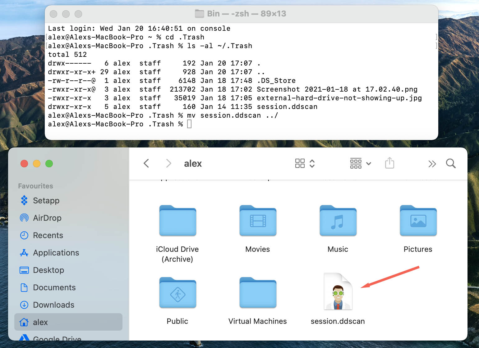

but you could try this from the terminal and see if this works:
  1. After opening Terminal through your Utilities on Mac, type the following command: cd .Trash, then hit Return.
  2. You’ll now type ls -al ~/.Trash to view the contents of your Trash folder.
  3. Now type mv filename ../ and hit Return again. You must use the full file name in the command line for this technique to work.
You should see the deleted file in Finder. If it doesn’t show up in the prompt window, use the search bar with its name to locate it.
copied & pasted from here:
