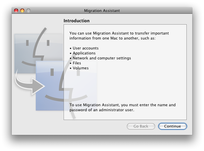

Migration assistant how could help me?
What should I expect to be migrated from my older system?

The screenshot attached shows what all it can move over. It's fairly smart about moving, too (i.e. if the backup has an older version of an app and the new Mac has a newer version, it won't overwrite the newer version)

The migration assistant can be started from the configuration wizard that is loaded at the first start and will transfer applications, files, configurations, ... Basically everything. I read there may be some problems with a couple applications that need to be registered again but never had that problem myself.
Aperture was the only one I had to re-type in the serial number (after having done a recent Migration Assistant move).
Coming from the Windows world, that's one kick-ass feature! 🙂
