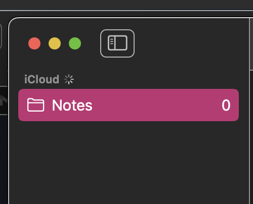

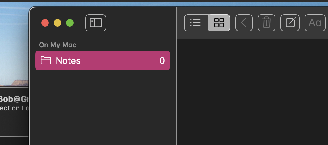

Good grief, what have I done? On my iMac, ALL of my notes appear to be gone.
On my 2020 iMac running Sequoia, I first quit Notes.app & turned off iCloud Note syncing as suggested.
I went to ~/Library/Containers/com.apple.Notes/Data/Library/Notes/, then to Browse Time Machine Backups, then to 01 September, where I selected the three folders at the end of that path and opted to replace the three existing three files.
I then opened Notes and saw what you see below.
I then went back to ~/Library/Containers/com.apple.Notes/Data/Library/Notes/, opened TM, browsed to yesterday at 1300, where I selected the three folders at the end of that path and opted to replace the three existing three files...and again got 0 notes.
I would sincerely appreciate some suggestions of how to recover these notes...of which there are SO many that I would hate to lose.

OK. Quit notes; turned iCloud sync back on; saw the iCloud gear spinning; a few minutes later, all my notes were restored on my iMac. Phew!

Did you end up getting your missing notes from your Time Machine backup (the original query)…..?
I did not, it was toggling Notes' iCloud syncing back on that did it. That recovered all my notes...but of course I am still missing the one note that started me on this journey in the first place.

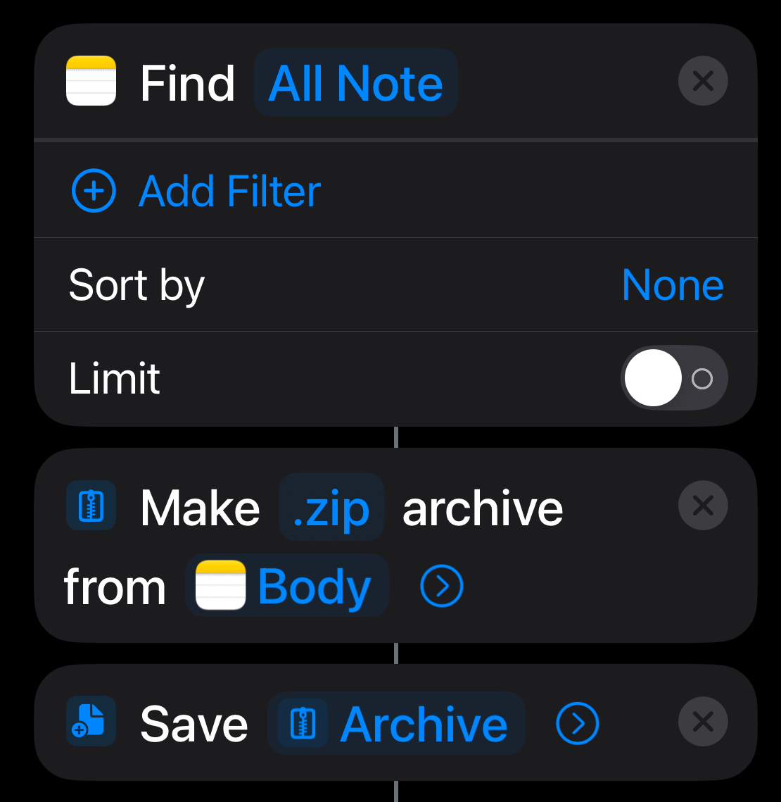

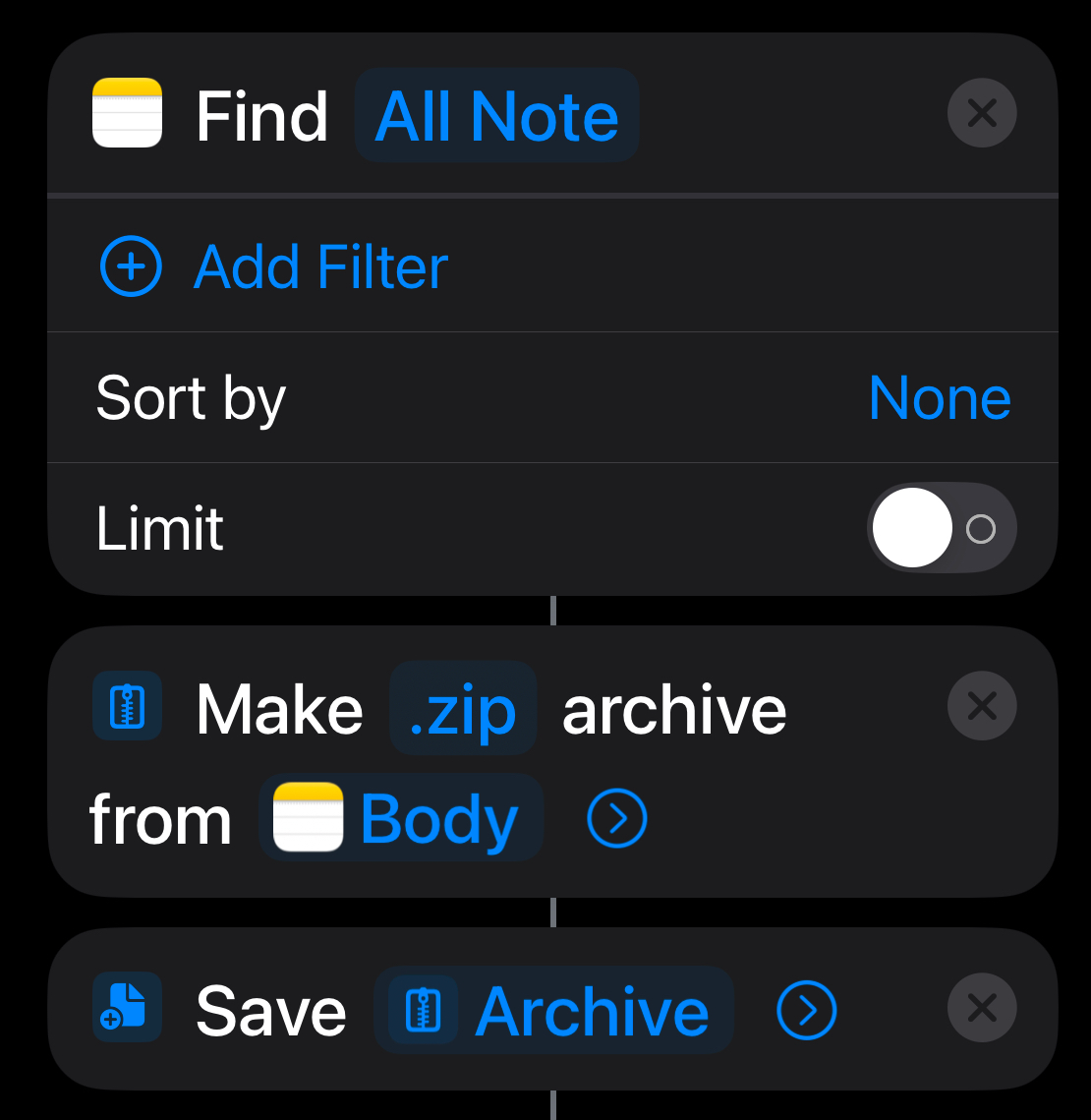

Gonna put this one here. Basic outline to save the text from all Notes in Notes.app. Doesn't save locked notes, does not do attachments, and does not save names/titles, but at least saves the text from. Can be adapted for to fit one's needs and can be easily called from an Automation in i*OS to automagically do a snapshot of one's Notes.
