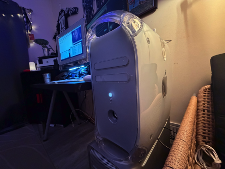

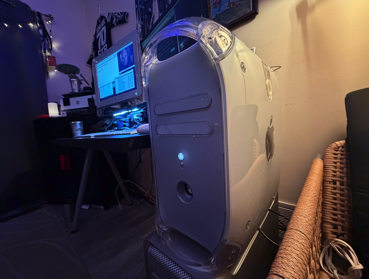

My favorite G4 case of all. The Mirror drive door model was too "bling" for me, and the earlier graphite case looked like a B&W G3 that faded to a bland color 😉 .
That system will run 10.5.8 quite well. I am running that OS on my Quicksilver cased (pictured above) Digital Audio with only a dual 533 processor and the same amount of RAM as you have. I like the modern feel of 10.5.8, however I prefer 10.4.11 on G3 and G4 systems, and mostly only run 10.5.8 on my G5.
The G4 system you have is quite capable, can run newly supported browsers such as aquafox, and depending on compression, play and edit video well enough to this day.
The quicksilver has nearly identical architecture as the digital audio, both have the faster 133mhz bus, with the Quicksilver getting a boost in cache bus speed over that of the Digital audio.
