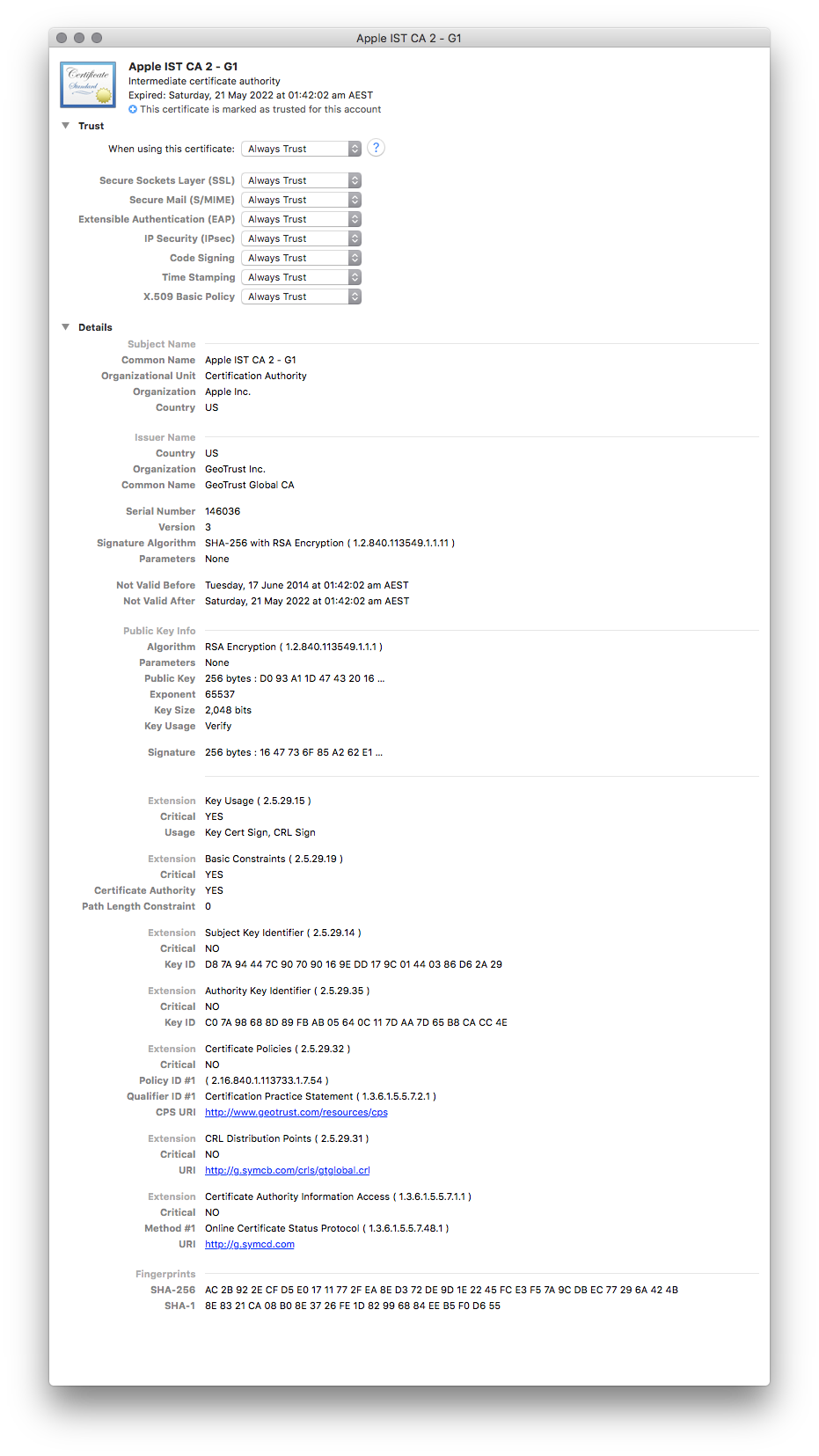

The signing Root CA "GeoTrust Global CA" in "System Roots" expired on May 21, 2022.
So set both the original "Apple IST CA 2 - G1" and "GeoTrust Global CA" to "always trust"
This works for me in High Sierra (I did a logout & login; not sure if necessary).
Also, in my case, no need to import the second "apple IST CA 2 - g1".
Worth a try.
Worth a try.

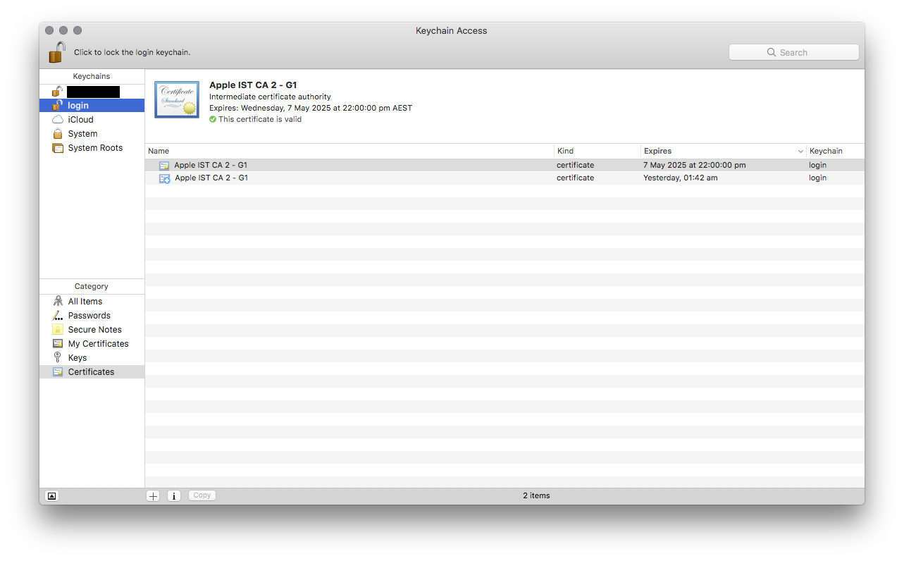

What was the second expired cert?
I only had 1:
Apple IST CA 2 - G1
CN: GeoTrust Global CA
Expired: Friday, May 20, 2022 at 10:42:02 Central Daylight Time
On a lark, I have now also set always trust on the only other Apple expired cert in login keychain:
Apple Application Integration Certification Authority
CN: Apple Application Integration Certification Authority
Expired: Wednesday, July 26, 2017 at 14:16:09 Central Daylight Time

Ok got it and finally working again. Was a little unclear because certs are in two different places.
1. There is "Apple IST CA 2 - G1" in the login keychain that expired May 20, 2022.
2. And a second expired "GeoTrust Global CA" in "System Roots" that expired also on May 20, 2022.
Both need to be set to always allow. I don't think the Baltimore Cybertrust or the other Apple Application Integration CA helped. I deleted the former and returned the latter to expired.

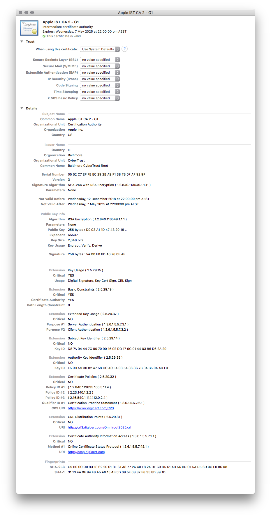

Interesting, so you got it working without even having the certificate referenced yesterday?
EDIT: Confirmed! I removed the "CA 2 - G1" certificate that expires in 2025. It seems as long as the originally-discussed cert from Apple's site that expired a few days ago is set to always trust, and the "GeoTrust" one is also set to always trust, Notes and Drive sync just fine.

« Thank you for contacting Apple PKI team. The expired CA has already been renewed and can be found here Apple IST CA 2 - G1. If your issue is still not resolved or you need further guidance, please visit iCloud Support https://support.apple.com/icloud.
Apple PKI »
Quite generic but at least, I had an answer in short time.
BTW, does the certificate goes in System or Login? I’ve put it in both…
