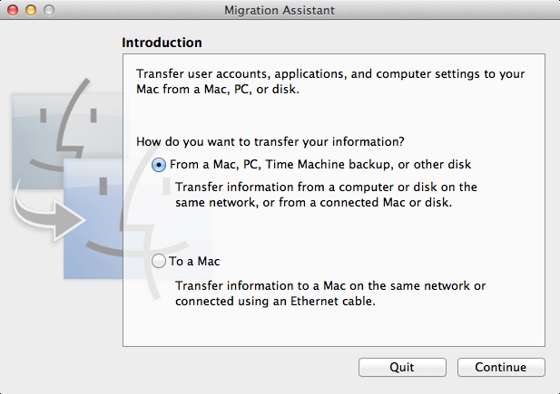

If you missed that and ended up with a clean install, I think all you need to do is launch Migration Assistant and follow the instructions.

Just one tip: If you have created an account (or accounts) on the new Mac with the same name that you used before, I would recommend deleting that account(s) before you start. Create a new account with a different name (with Admin privileges), log into that new account and delete the old account(s).
Then do the restore using Migration Assistant. It all gets a bit confusing if Migration Assistant is asked to restore accounts from Time Machine and they already exist on the new machine.
Don't know if I have explained that clearly but hopefully you get the idea.

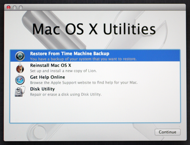

Im not sure which generations of macs has it; but restart the mac, as it makes the intial sound, hold the "option" key. This will bring up a boot menu. See if there is a "recovery" option. In there is how I restored from my time capsule (13" cMBP, OSX mountain lion).
Edit: Here is a screenshot of what you get after clicking on "recovery", just select the restore from TC option.
You can do that too, but there's no need. That's there in case your Mac won't boot and you have to recover it. If it will boot, just run the Migration Assistant wizard, there's no need to start in recovery mode.
