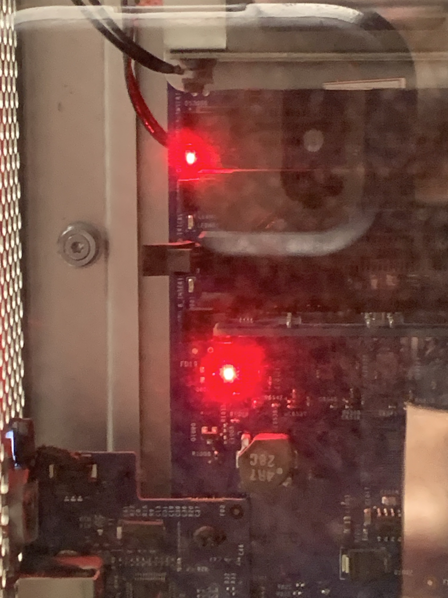

I have a late 2005 quad core G5 I took delivery of in the summer of 2006. I took it offline some 6 years ago, replaced by other Macs in my lab. I want to bring it back to use at home now.
On startup, after chime, I get no signal on the screen, and it goes immediately into overhear mode. Here's what I have done to address this, to no avail:

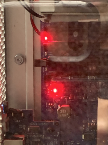

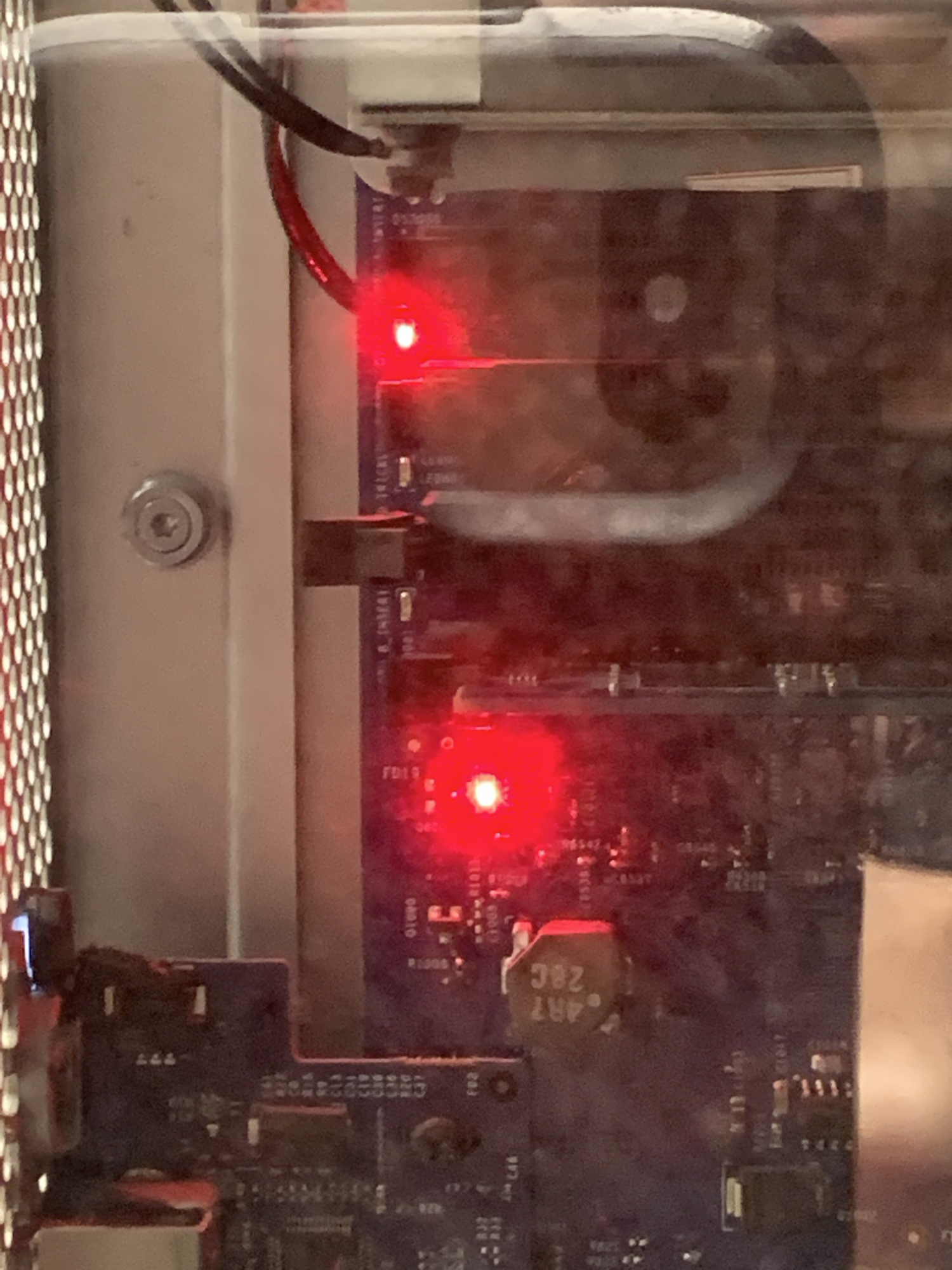

While I had the processors out, and heat sink, I could not see any visible evidence of leaking; hoses look fine and supple, and pump is running (single pump).\
Attached are images of the LED's I get on startup....

Hello,
I'm not familiar with the Quad per se but I do own 3 Dual Core 2005 G5s. I think there might be a problem with your CPU(s). I'd try reseating the processor cards and check if all screws are tightened good enough (really make sure ALL screws are tightened). If the problem persists try one CPU at a time (i. e. booting up with only one processor installed). Proceed similarly with memory. Try 2 sticks at a time to rule out possible culprits (If I recall correctly memory has to be installed beginning with the inner slots).
