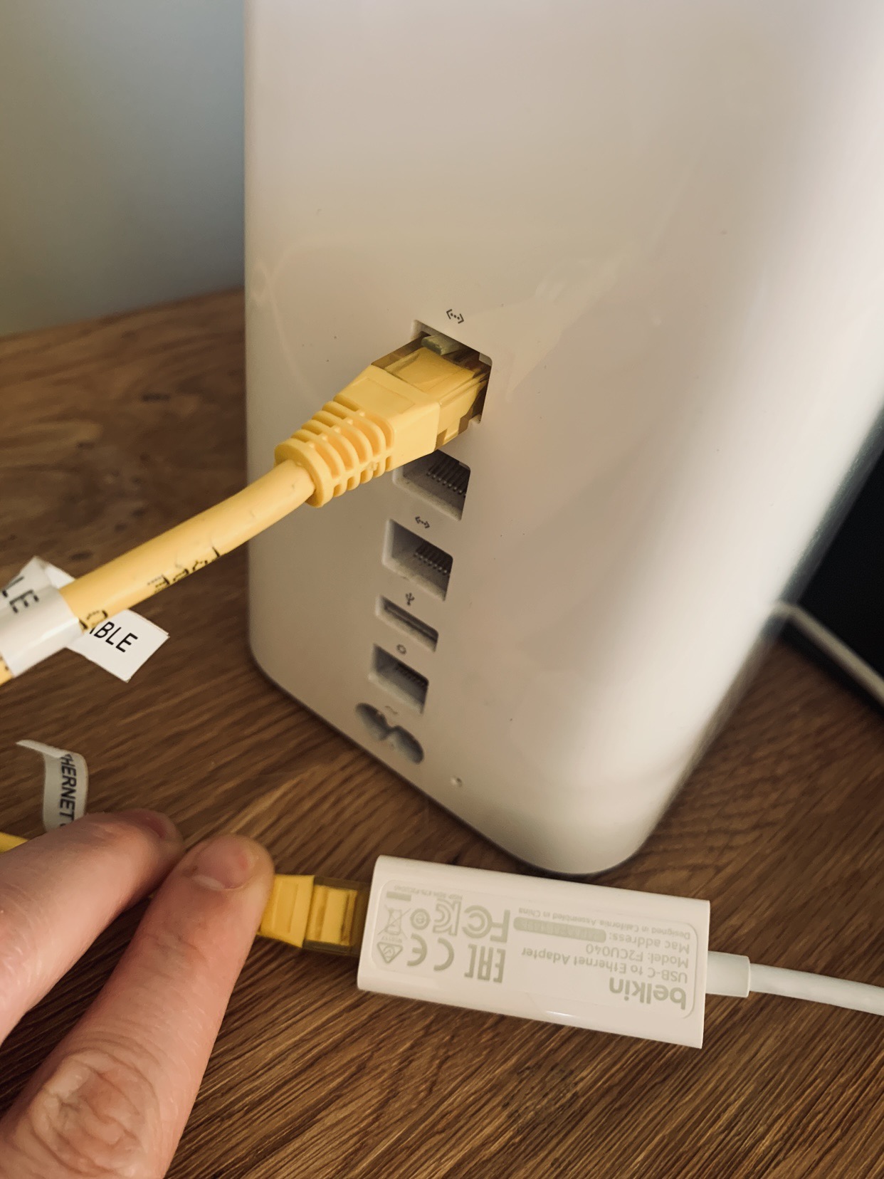

Hey, so I have a cat 5 ethernet cable coming from the LAN port of the time capsule into a dongle converting the ethernet to USB-C
How do I know what speed connection it is?

[doublepost=1558464180][/doublepost]Image for reference. Assuming I've not done anything stupid? And yes I've unplugged it for now. That's not the issue

From your attached picture your adapter Is a Belkin F2CU40 the reviews for this are bad.I also see that you have a USB port on your backup drive, have you tried using it?

Hmm, from the initial setup, I am not sure. The TC might have a page that shows the status of the ports? I know most routers do (but infuriatingly, not all).
As Kenny mentions, the reviews on that adaptor are poor. I picked up a cheap one from Best Buy which was trash (not Belkin). I tried a second brand and it's been spectacular. I use USB-A not USB-C though so mine won't work for you. But ultimately I would buy a replacement and try it out and see if it's any better.
This has been absolutely fine backing up. And super fast transferring files manually onto the TC. I don't think it's the adapter as that has worked fine up until now and even so, should be capable of transferring >10 MB/s surely?
